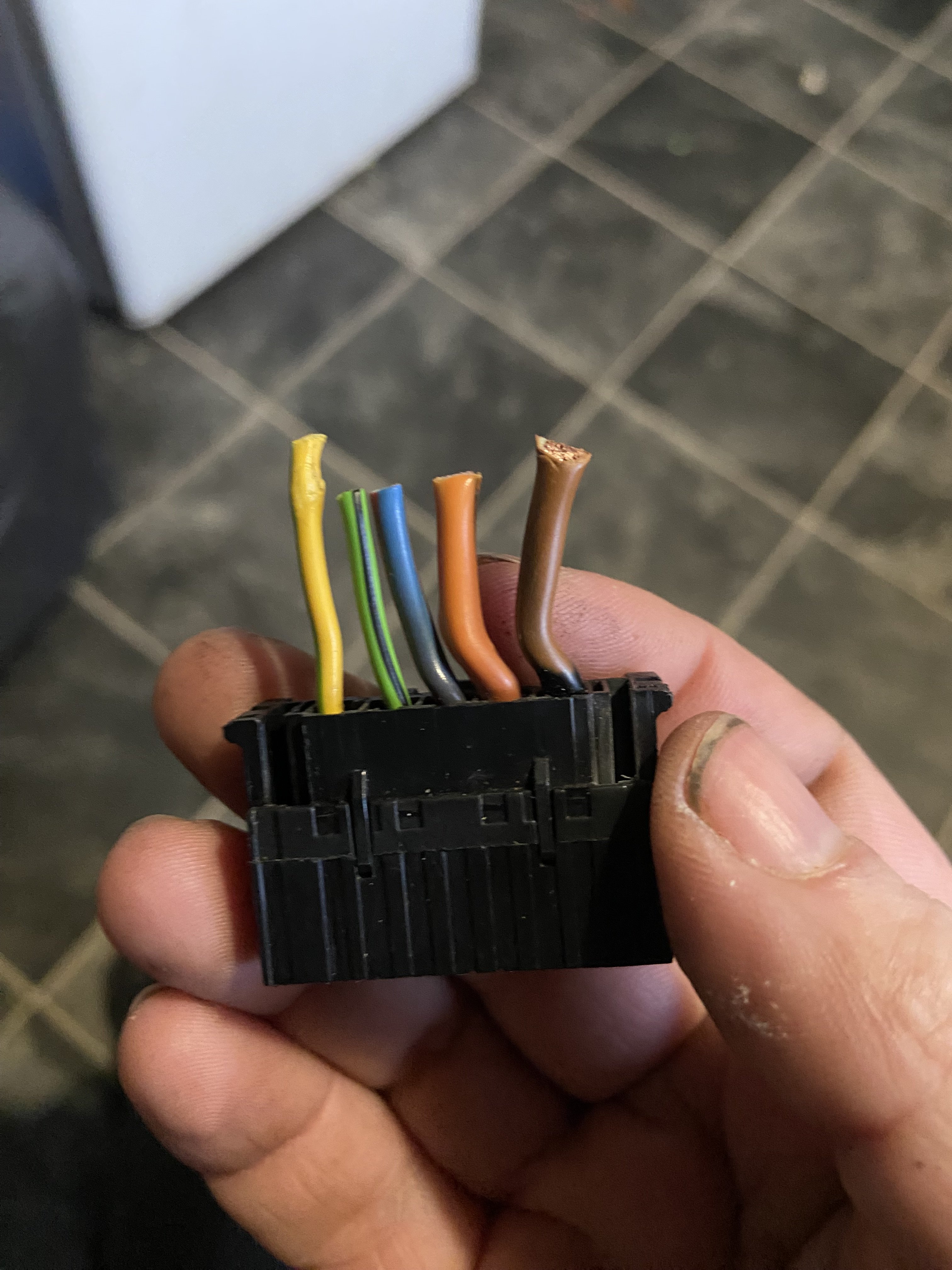

Hi there I’m hoping someone can help me, I’m trying to change the blower motor resistor on my fiat do lo 2011, I have the new part but the wires on the new one are a different colour to the old, does anyone know what colours to connect?
It isn't that hard, just make sure the order of the wires are the same.
Looks like the first picture (old plug) is backwards compared to the new plug. So looks to me:
Brown on car to yellow on plug
Orange on car to green op plug
Blue on car to red on plug
Green with black line on car to blue on plug
Yellow on car to black on plug
