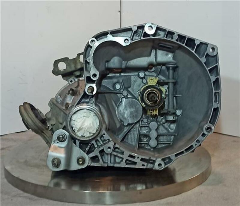

Anybody tell me if the starter on a 1.9 multijet is changed from underneath as can’t seem to get to bottom bolt from the top. It’s actually on a Sedici not a Doblo but obviously it’s a common engine on the Doblo and the Sedici section isn’t very well supported. Any help or pointers appreciated!

I have had some 1.9 Doblos in past but couldn't remember, but looking at this gearbox it shows bottom starter thread from lower starter side.
Just above bellhousing nut.
Sadly no, plus all the wires.:(
Yes, wires and selector cables are right in the way. Have removed battery and tray and as i said have managed to slacken top bolt but bottom bolt no hope. Can just get my fingers on it if I reach round but that’s about it. Hands are cut to ribbons and I’ve had enough for today! 😠
