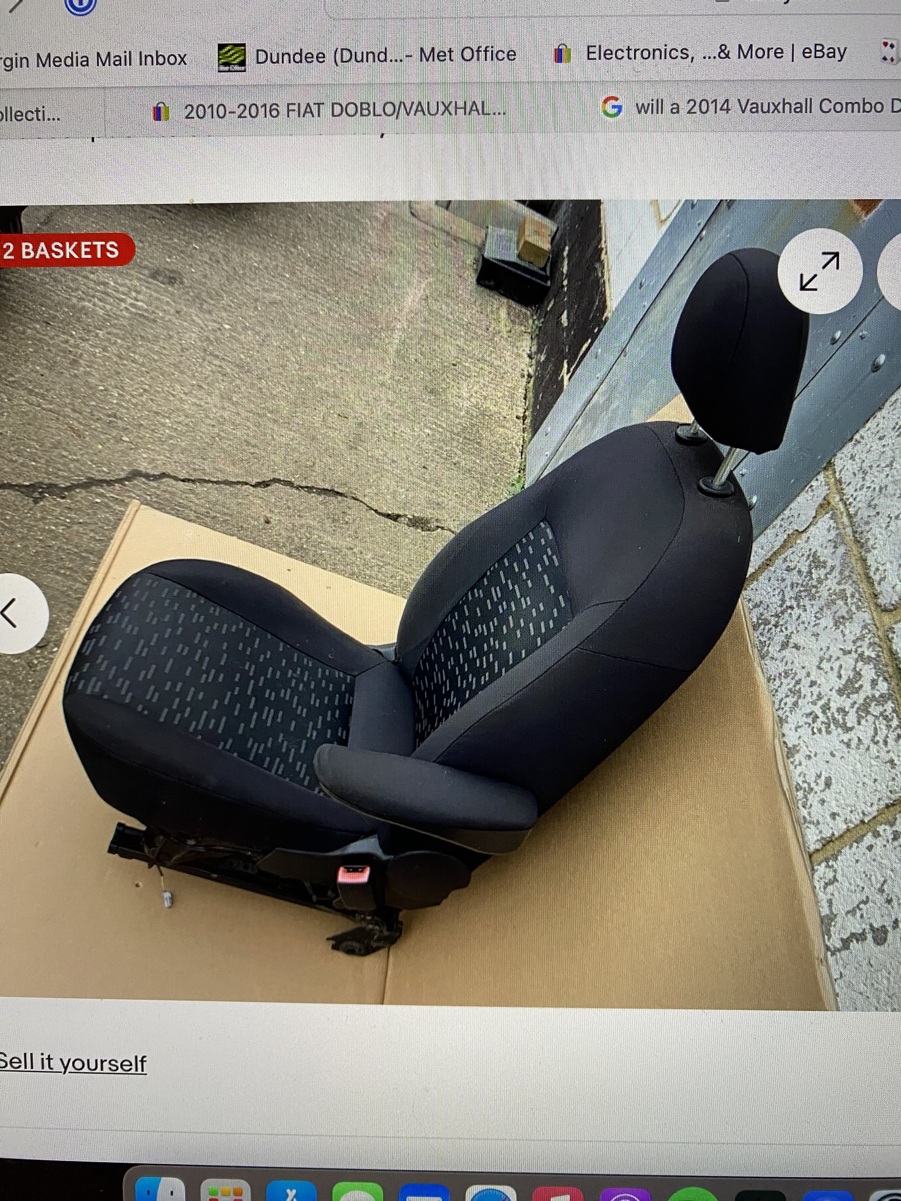

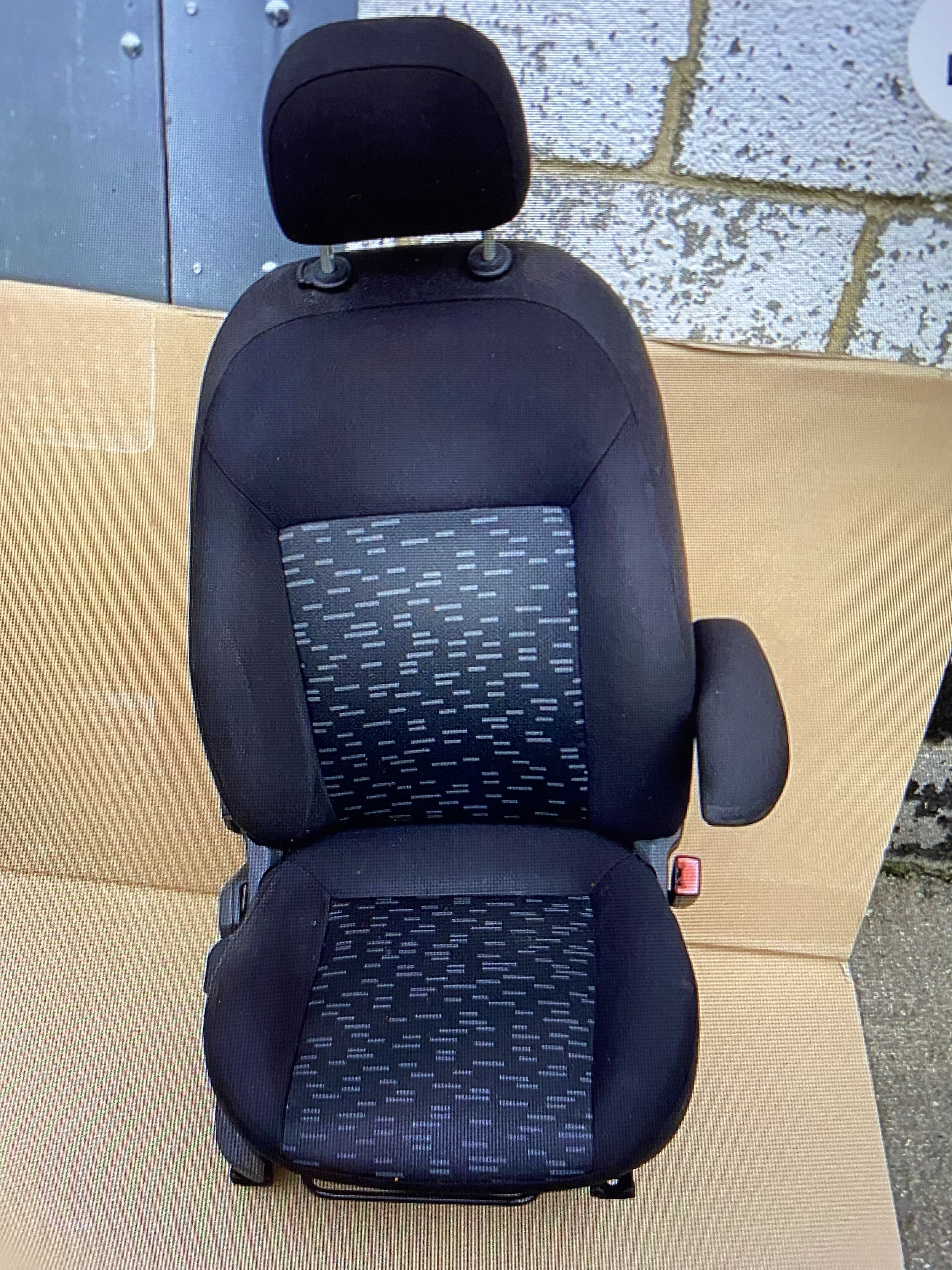

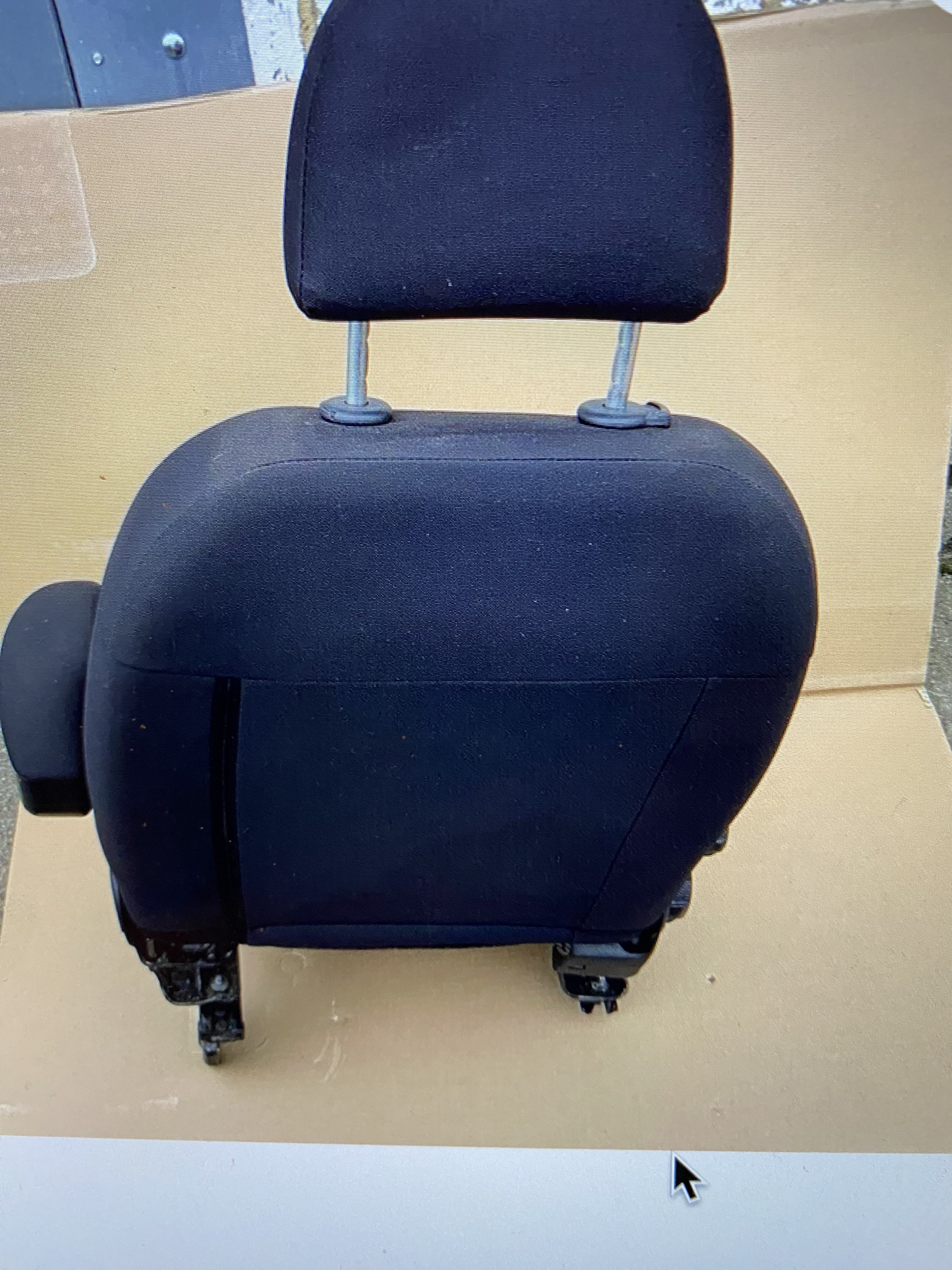

My 263 2017 Maxi (RHD) has a basic drivers but I would like to fit one with rise and fall, lumber adjustment, and an armrest.
I have the chance to buy a drivers seat with all these adjustables, which comes from a 2014 Vauxhall Combo. The seller says it will also fit mk2 Doblo.
Can anyone advise me if this seat would be compatible with my van.

I reckon it should just be a straight swap. They're the same van essentially.
PS Can recommend the deluxe seat - have had it in all three of mine (two Combo D's, one Doblo)
Is the seat I’ve photographed the deluxe seat?
