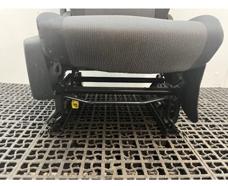

Can someone advise me if this seat
VAUXAHLL COMBO PEUGEOT PARTNER CITROEN BERLINGO
2019 2020 2021 2022 2023 2024
FRONT DRIVER SEAT
Will fit a 2017 Mark2 Doblo Maxi cargo van (263)
Hello,
Opel / Vauxhall Combo 2011-2018 is the Sibling of a FIAT Doblo 2010-2022. They were both produced in Bursa, Turkey.
Then after Stellantis took over, since 2022 a new generation of the Doblo is based on the Partner / Berlingo and Combo (and the Toyota Proace City), which were produced since 2018. They are produced in Spain and Portugal.
So, the this line:
reffers to the newest generation of the small van. Most probably the seat won't fit. But there's small percent it will (if they are using the same parts for the newer generation to cut costs). However I wouldn't count on it.
