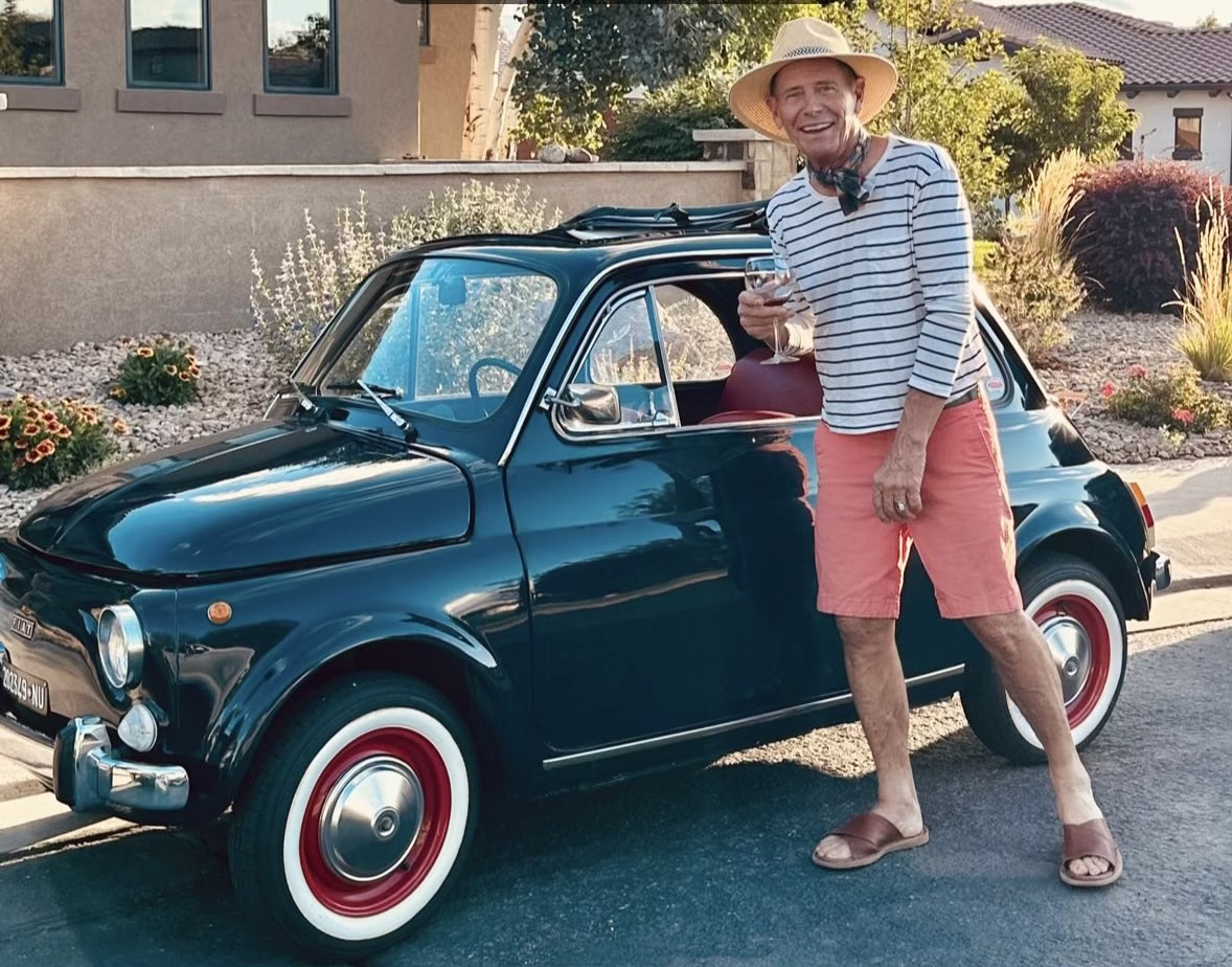

Good discussion about the tires. Does the 17 front pressure differ whether you have traditional bias ply. Vs radials. I could bet get myself to spend 300 $a tire to get wide white walls. So elected for a nice radial. About 100$ and then purchased portwall add on white walls.
I have been running higher pressure all the way around than the original recommendation and car seems to drive well

I trust that is Italian red in the glass.;)

Chianti Classico ! Good eye
