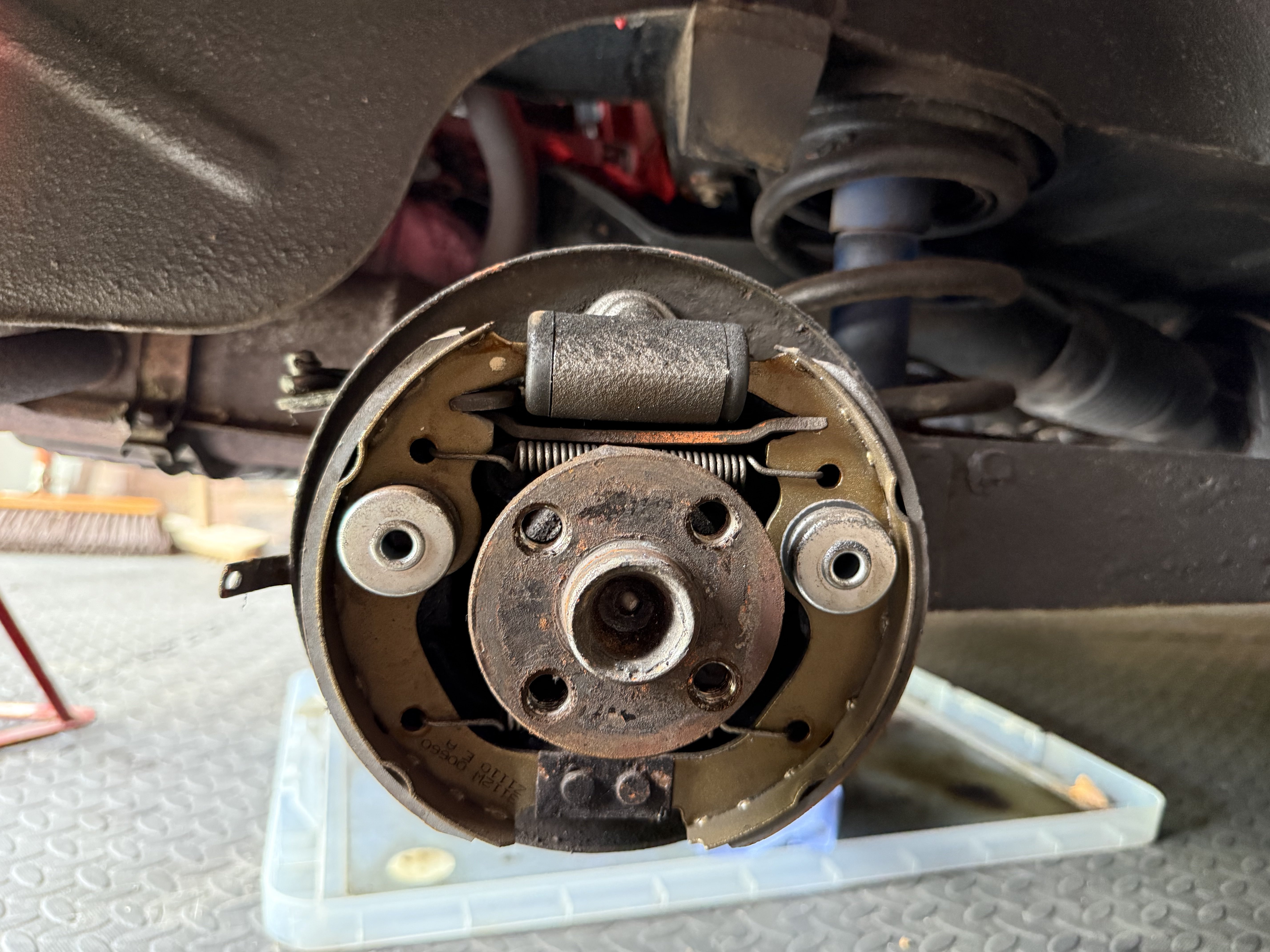

When my 500F car is cold all wheels are free and I can roll it just fine. But, after a 5 mile drive, the rear left wheel feels like its binding (I put it up on a jack and confirmed that's the wheel that is sticking'. It smells very hot too of course...
Before I disassemble the hub, any tips on what I should be looking for? Seems weird it only does it after a drive - maybe something sticking...?

Something is wrong with this brake, from your video I think you are missing the pin that connects the two levers, the spring that brings the handbrake lever to its initial position is also missing. The brake cylinder that controls the brake shoes seems blocked, its pistons should go back slightly when pressed by hand. If the brake shoes have worn out because they were not properly seated in the drum and if the brake cylinder is blocked, I would replace all these parts with new ones... bad brakes can put your life in danger,,, especially in this Fiat that does not even have 0.10 Euro NCAP safety stars. 😁
That would explain why the handbrake doesn’t retract properly!
Missing pin would explain why handbrake doesn't work at all.
In your video it is clear the handbrake mech is loose and pistons don't move at all. So zero braking effort on that wheel by foot or hand.
It appears however did the brake work gave up on it and manually forced the shoes out until it was very hard to fit drum over shoes and handed vehicle back-I have no words at the moment to describe that action given it puts lives /health at great risk

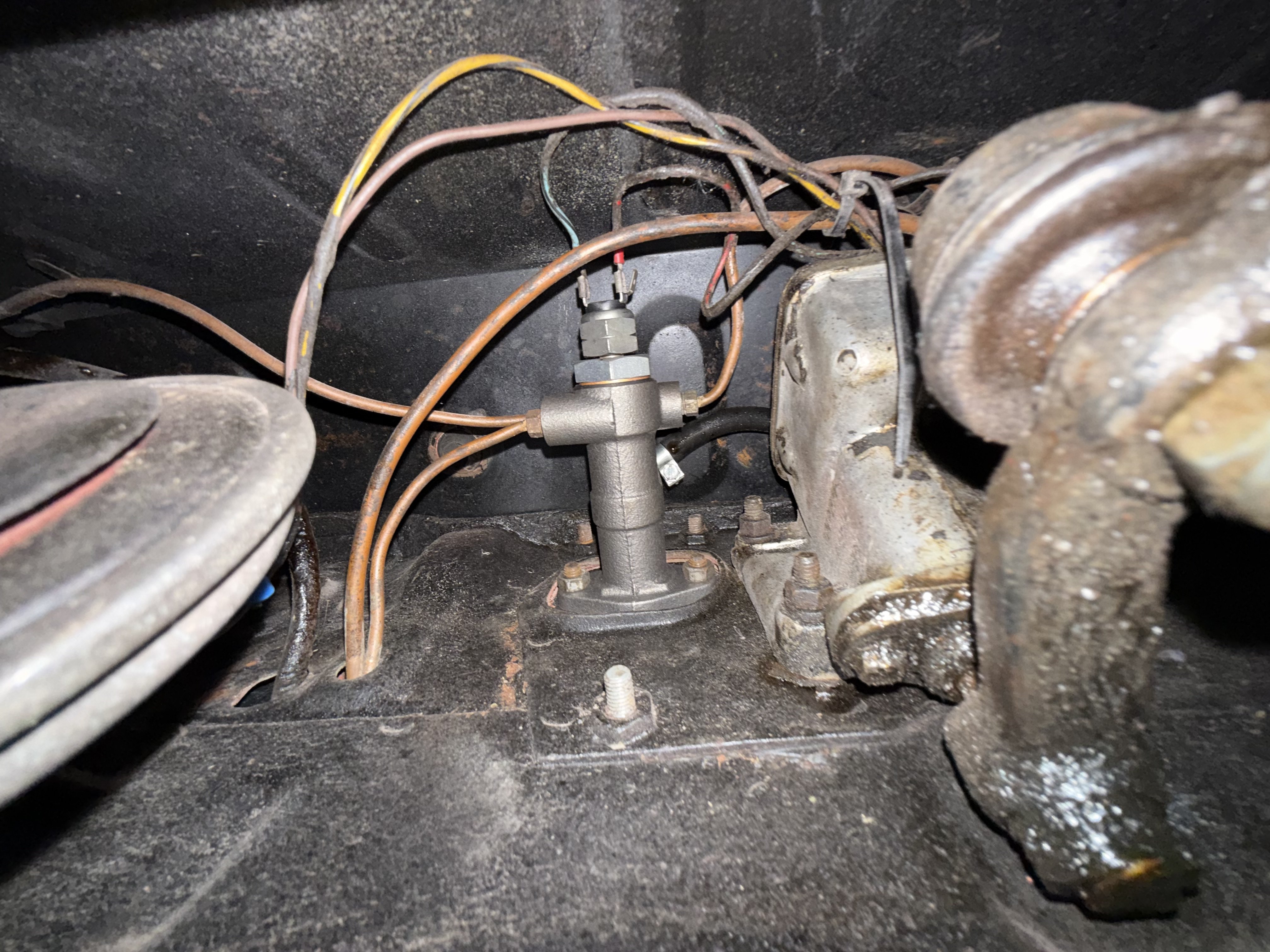

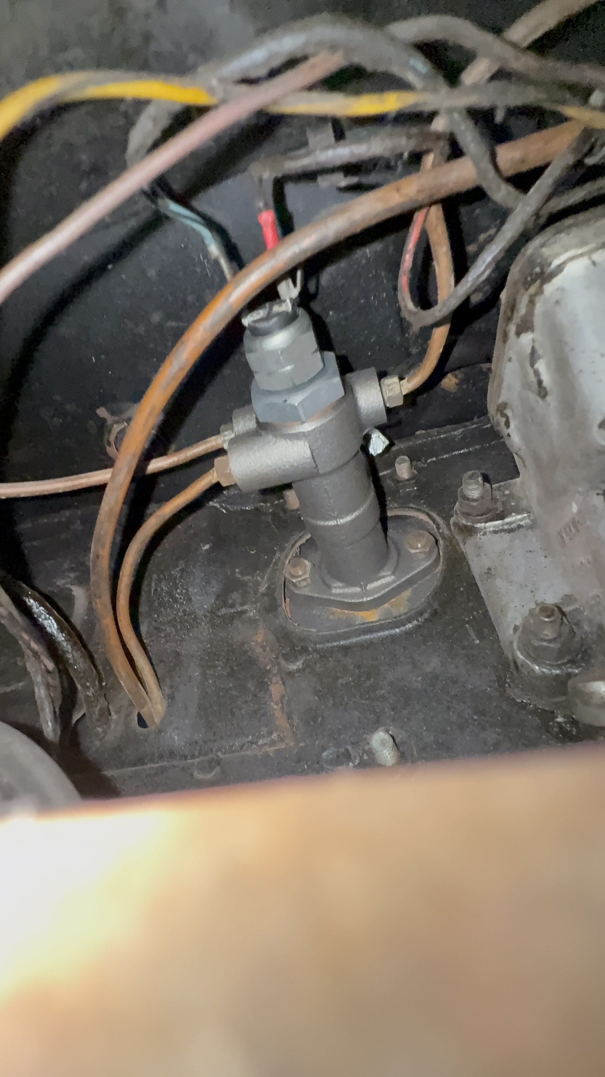

A quick Google heavily hints that original brake system is single circuit.
A dual circuit conversion is available that puts front on one circuit and rear on another circuit.
Please post pic of your master cylinder.

Attached some pictures of the brake master cylinder and slave.
Just disassembled the back right hub it is also missing the handbrake return spring, but the brake cylinder and handbrake work fine. Pictures attached.

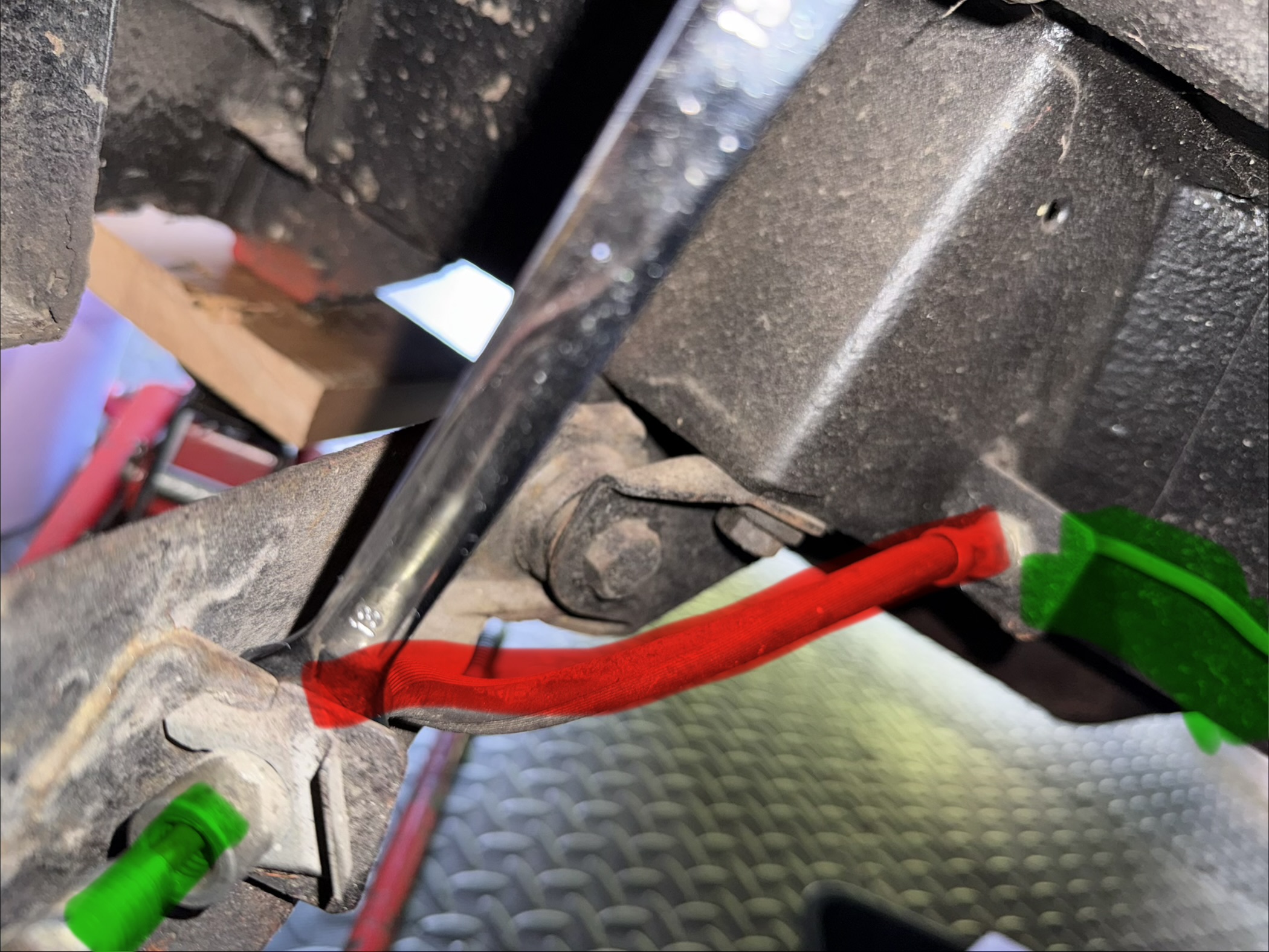

Well, I think I know where the problem is. I’ve backed off the bleed, and nothing came out. So I went backwards on all the joints on the brake pipe, and it would appear the rubber joining part is blocked. Either side is ok, but nothing passes through that segment.

Well done . Brake hose.
Be very careful when you tighten the hose union nuts , the copper pipe is very soft and hose union nuts easily deform sealing flare on pipe. Do not over tighten.
