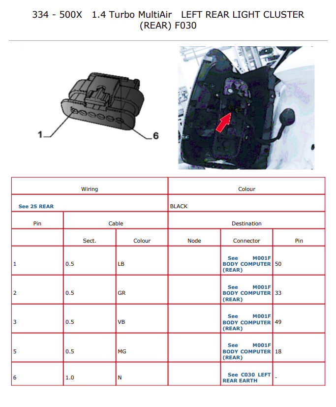

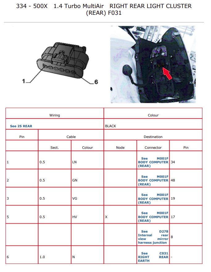

1. After removing the tail lamp fixture (use a 30 torx bit) there's a connector on the back of the lamp fixture with some wires that come from the car body. After pulling off the connector, check the outer area on the connector where the BLACK wire is inserted. If the plastic on the outside of the connector where the black wire is inserted looks melted, you'll have to replace the connector (see below link). You may also have to replace the light bulb panel too (the plastic piece where the connector attaches). There are pins on the rear of the panel the connector is pushed onto AND the pin for the black wire of the connector might be destroyed. BUT WHY??? Keep reading.

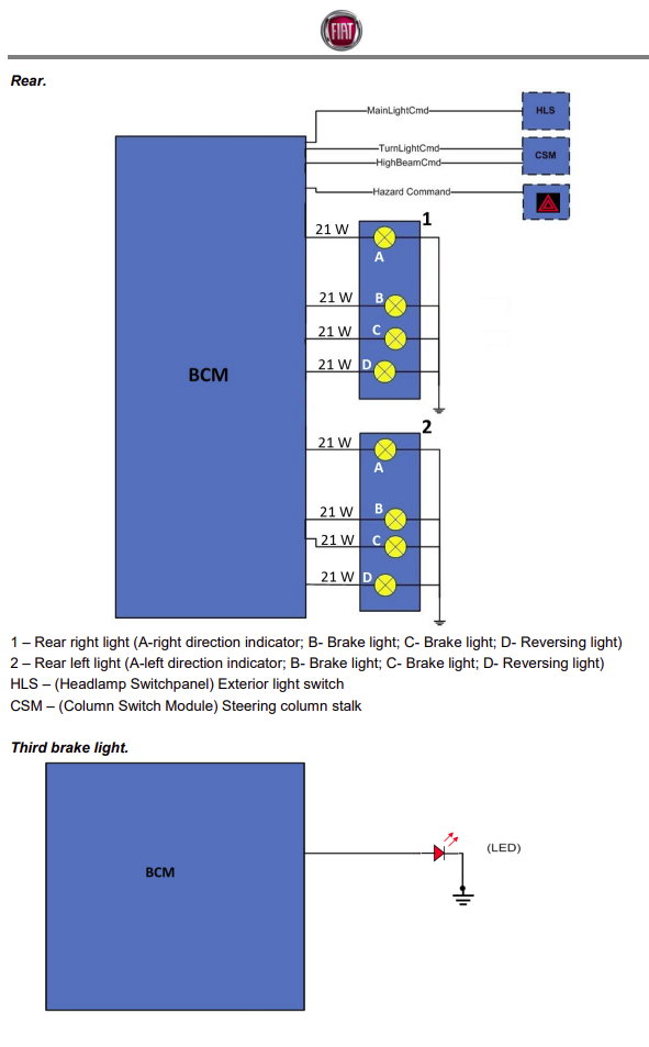

2. NOW, inside the tail lamp fixture (the actual tail light, NOT the bulb panel) you can find two wires with metal connectors that are stuffed into two plastic slots. This is where the problem lies. Although the metal connectors APPEAR to be in separate slots, they actually make contact when you push the light bulb panel back on to the lamp fixture. When the connectors make contact, this causes an electrical short which fries the plastic connector with the black wire. Electrical shorts cause overheating which can melt plastic, even metal. I had to buy a new light panel because the panel's pin for connector's black wire was destroyed. I was also on my second connector.
