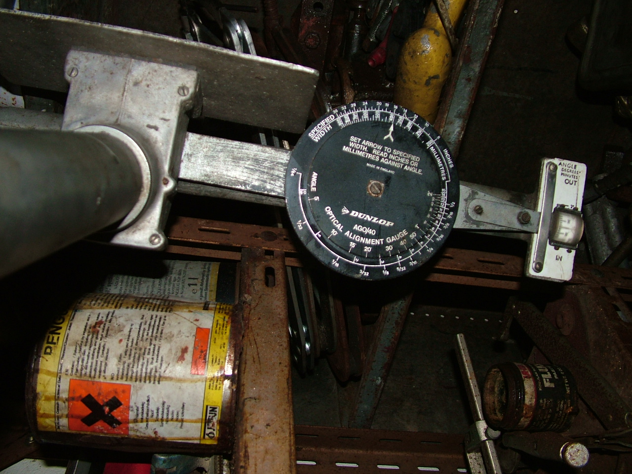

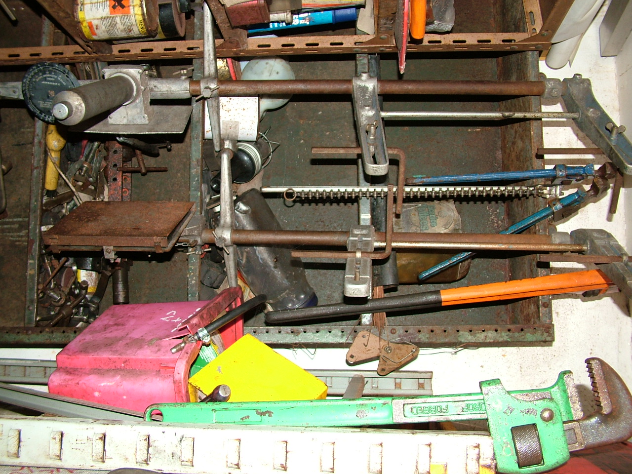

This is my set of Dunlop wheel alignment gauges at back of garage :)
I think from memory the mm or degree readings are the difference between the two points that the wheel alignment gauge touches the wheel rims.
You can probably read on the gauge first photo what the degrees equal in mm, note that varies on wheel diameter which has to be set on gauge when checking.

The beauty of these gauges is if bent they can be zeroed before use, which you should do any way.;)

We also had the Dunlop Caster/Camber and King Pin Inclination Gauges as well all in it's nice wooden box.
I notice these days on eBay they are selling the empty boxes for more than I have paid for the whole kit s/h in the past.:(
