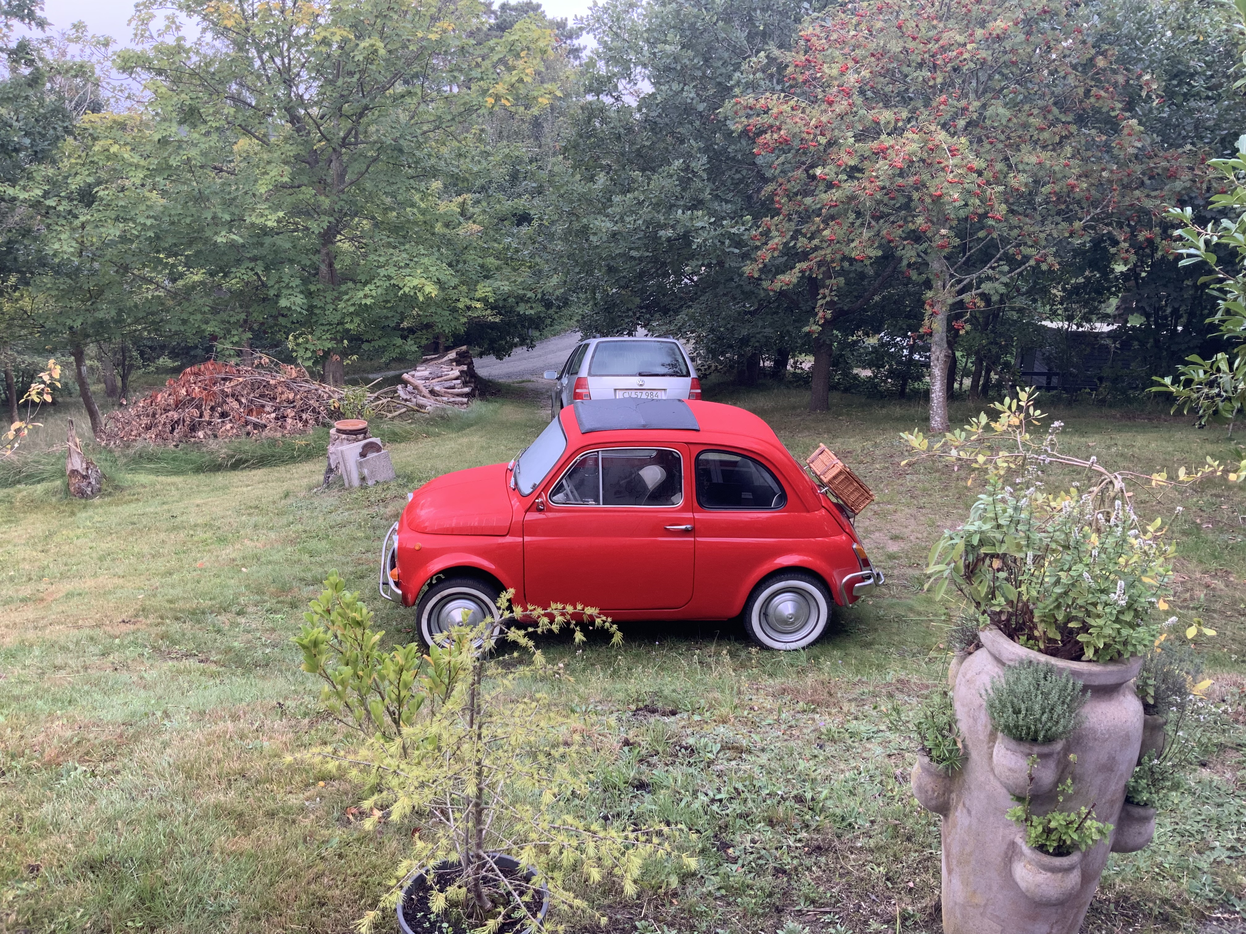

Hello forum. Car is 1969 Fiat 500f. QQ……what is the STANDARD rear spring height? I want to purchase new rear springs/shocks, but I keep running into 17cm, 19cm, 22cm…. The current springs seem very sagged, which is affecting steering and tire wear.
I am not interested in any kind of modding/lowering…just complete standard.
Let me know. Thanks.
According to the "Factory" book of words, the 'standard' length (it is called the "free height") of a rear spring is 221mm (8.7ins)
