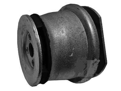

Are you talking about the one in the photo attached ?

Ok, I have the same problem, Mechanic has told me the rear, of the rear subframe bushes has gone, re the above post I have informed him that the Vectras Bushes will work. Question though are the front of the the rear subframe and the rear of the rear subframe bushes the same size? Will this Vectra bush work on all four of the rear subframe bushes? Hope this makes sense.
