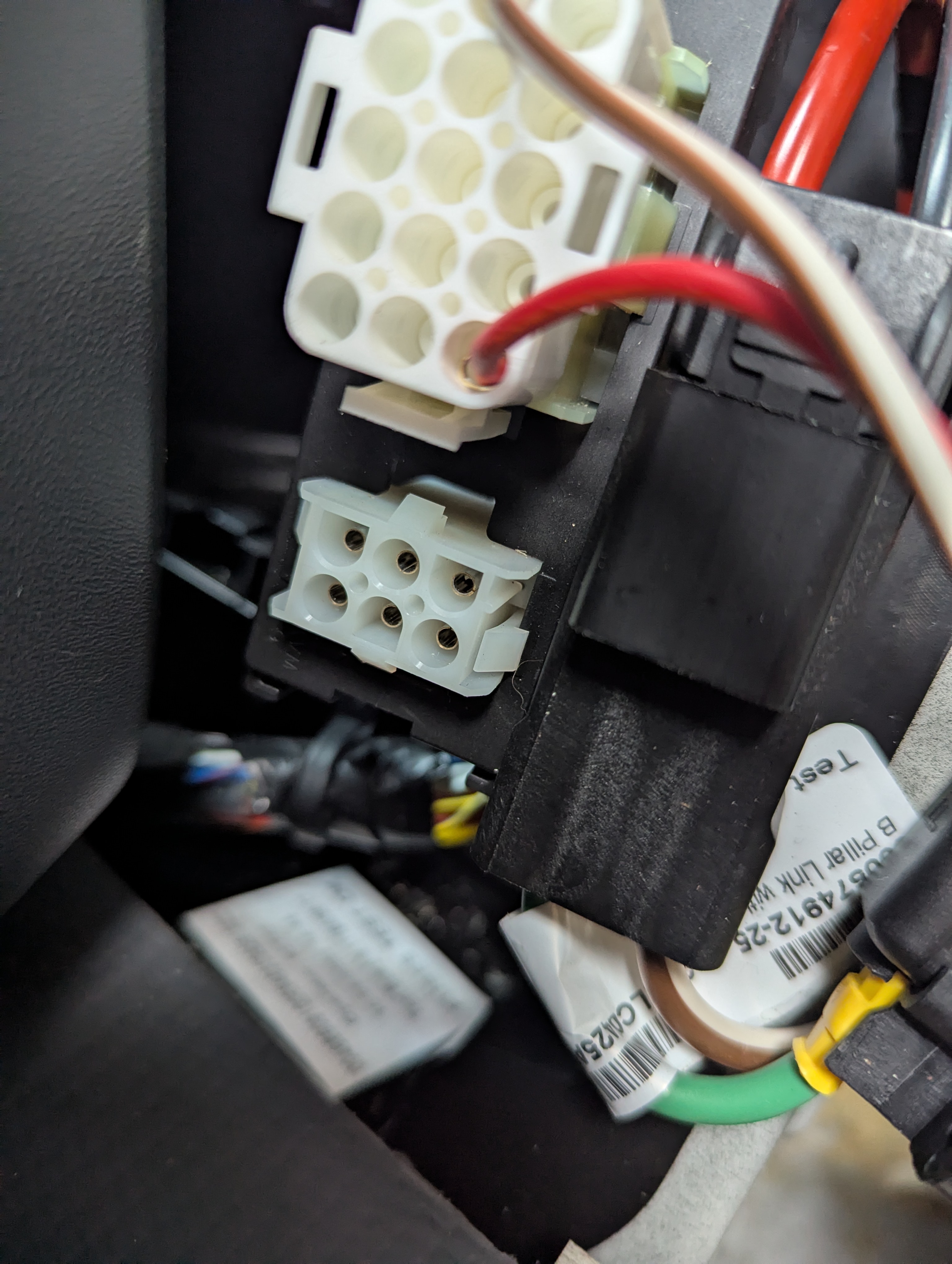

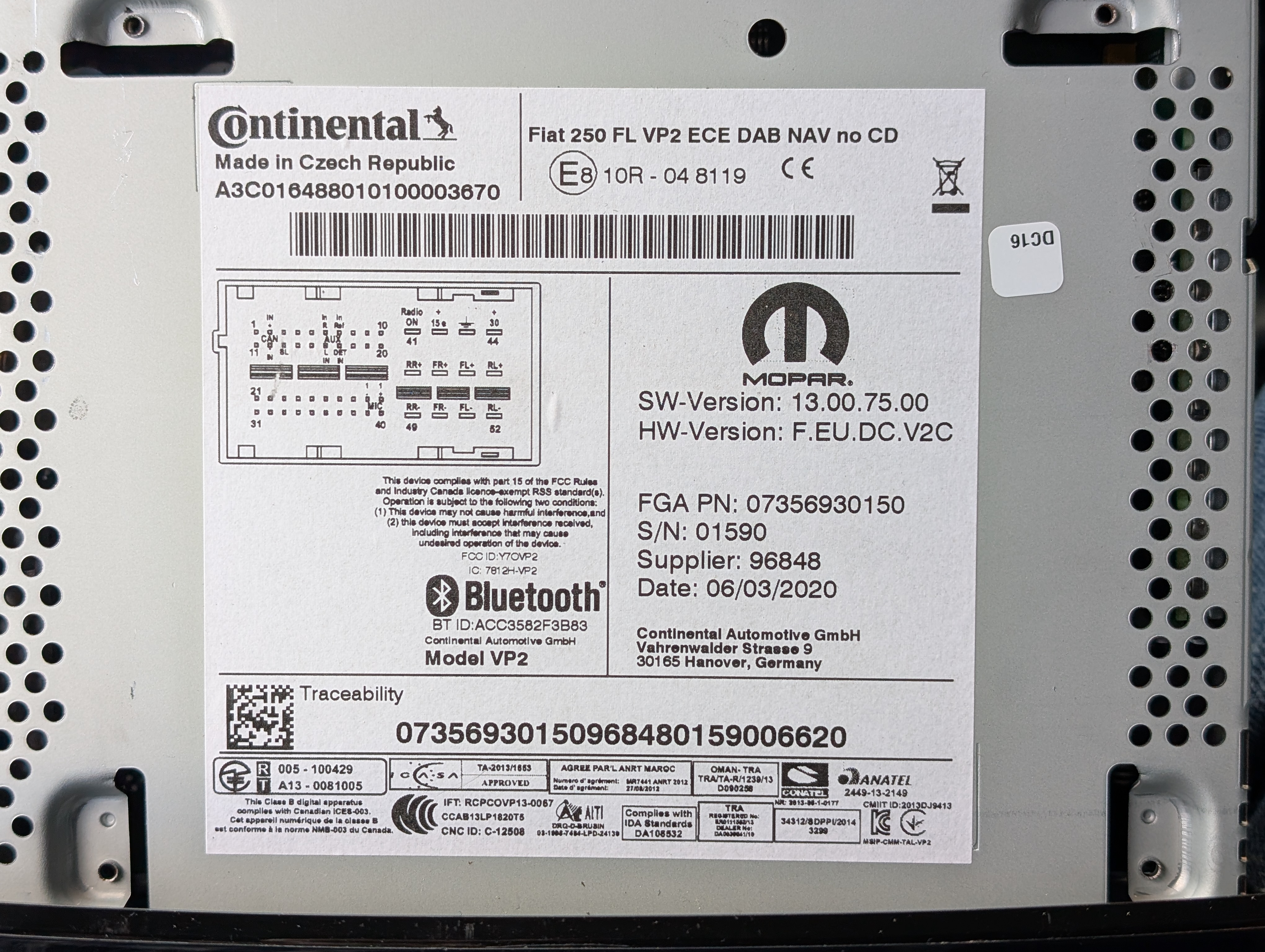

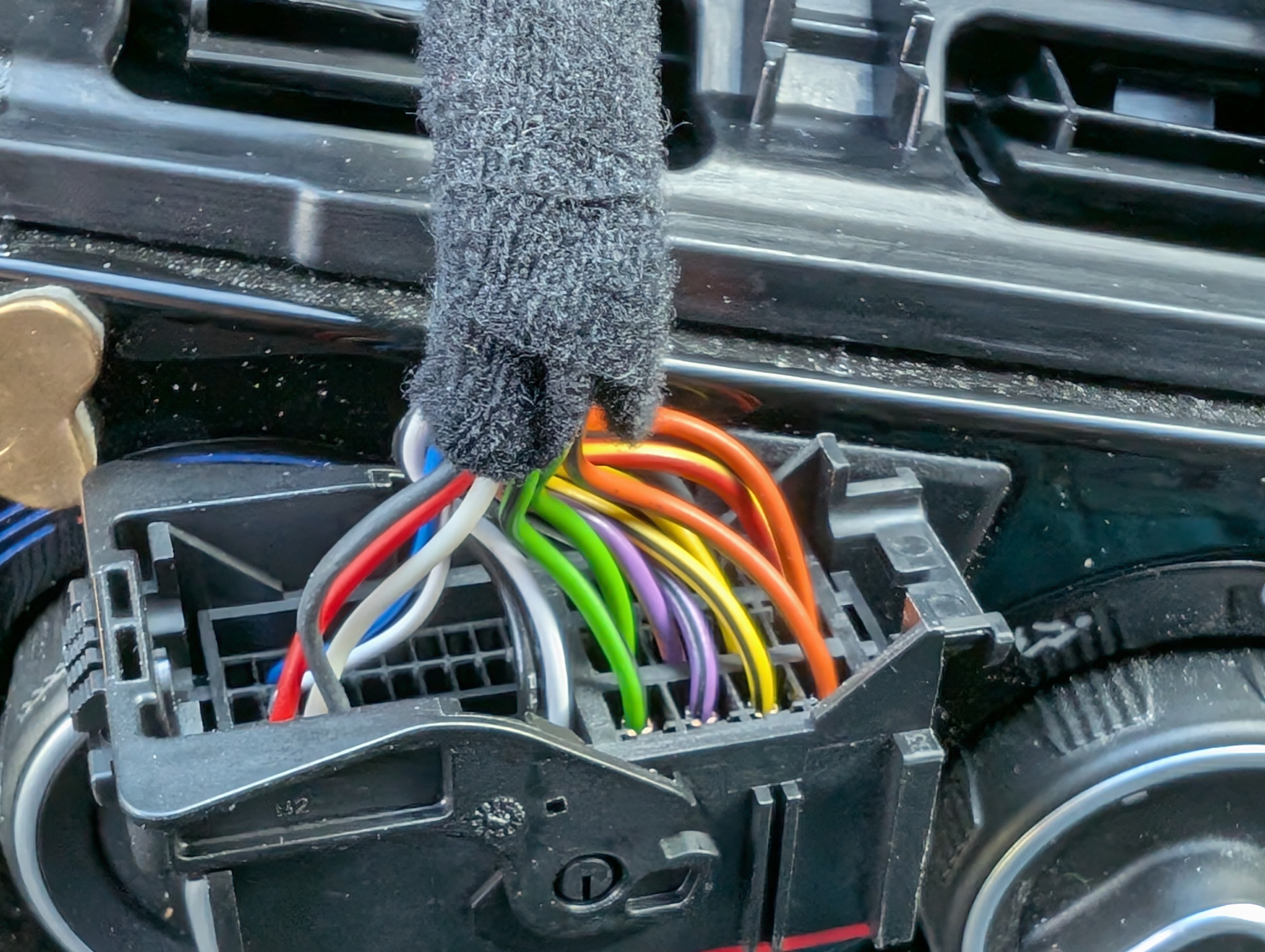

Hi, newbie here....I have a 2021 2,300 Euro6 Ducato 250 based CV40 campervan and I want to fit rear speakers. Where can I pickup rear spkr wiring pls. I can see that the connector at the back of my radio/nav unit does include rear spkr wiring, but where can I best access those wires?

Hi Nick, I recently added rear speakers to our CV80 using the info found on the CV FB group. Connections are bottom of the B pillar adjacent to the drivers seat behind the black trim. I ordered the mating 6 way connector from eBay Here

@nickmair pg93 in the X250 manual is what you need.
