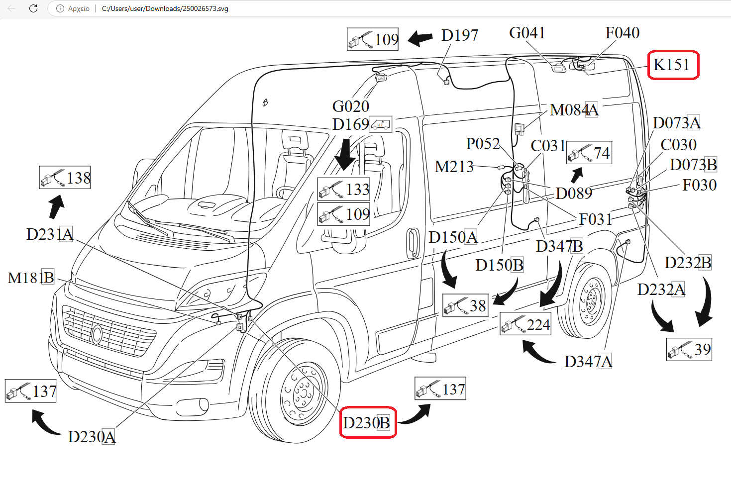

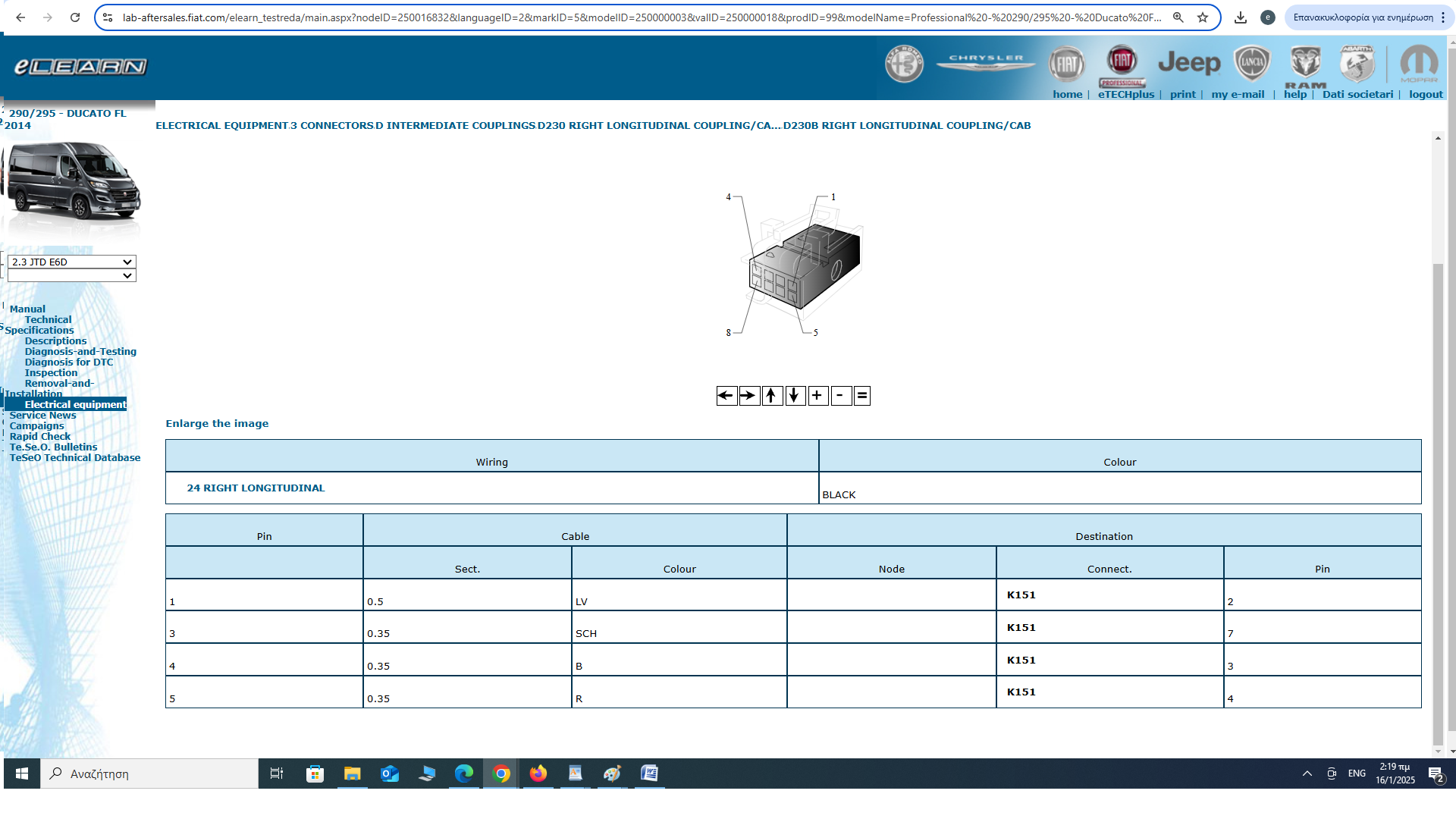

I noticed that there are some differencee of the 290 rear camera wiring vs 250
apparently it appears that 290 8pin connector has 4 wires whereas 250 8pin connector has 6 wires. I wonder why
no elearn info regarding the ducato 290 k151 connector
below the info for the ducato 250
