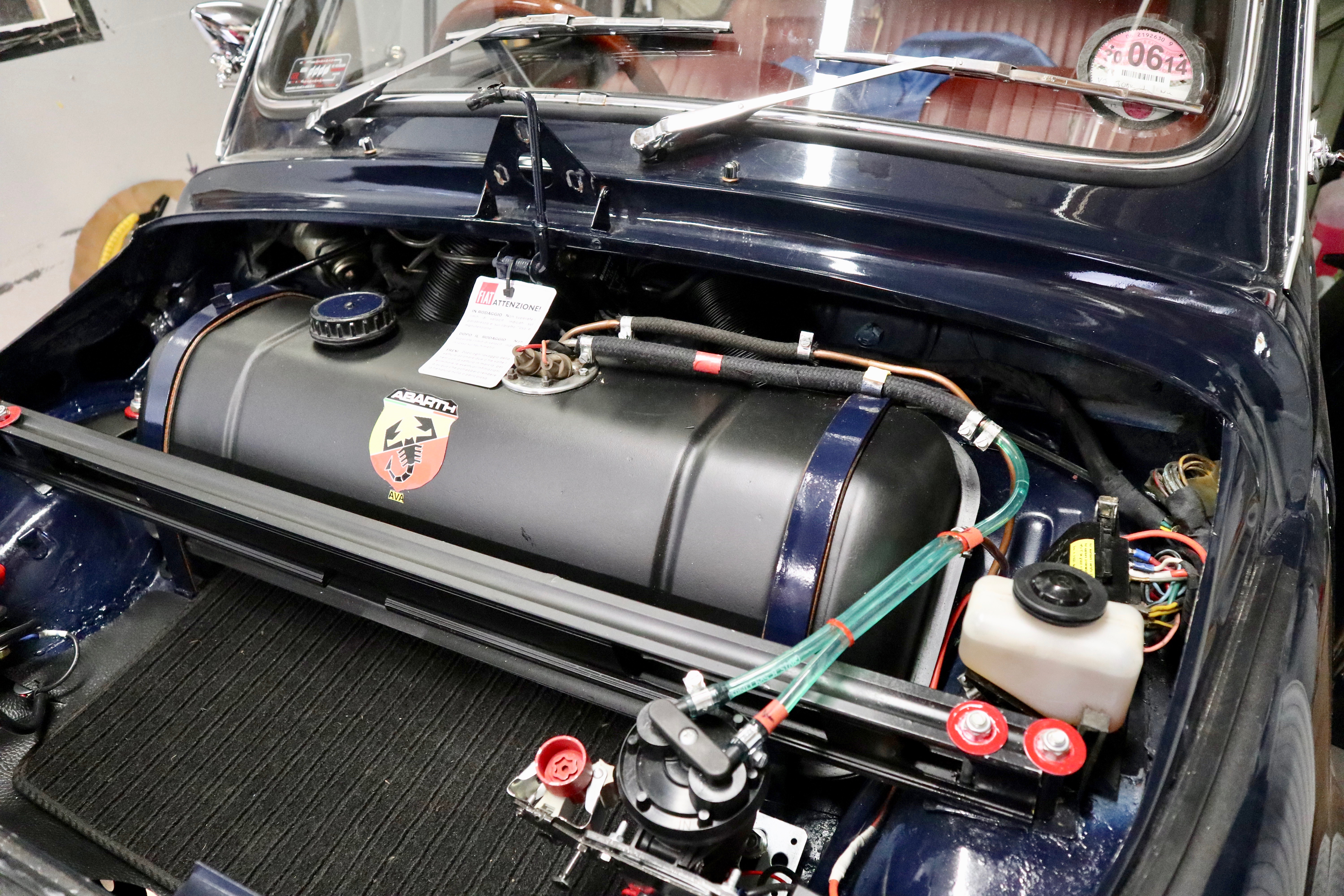

Just refitted my front suspension after cleaning all the old under seal off, I then found the bushes were all worn to nothing so I changed them all for poly Bush's.
After several other posts the consensus seems to be Fit a Brace Bar! I had a look they seem to be from £50 to £80 but the it looks as if they just fit onto the original shock absorber bolt, this would mean all the stress would be going through the shock absorber & relying on the strength of the wheel arch. So I fabricated two sheets of steel then bolted them in front & behind each of the shock holes, then believe it or not i had an old aluminium spirit level made up from 1.9mm thick box section, I wont waist anything) cut off the ends off & bolted through the new fabricated plates with U Bolts. This not only gives great protection for the fuel tank but also braces the two wings together.
At the same time I removed and sprayed the fuel tank, which just slides out without having to remove the new brace bar.:)
Hopefully the photos download

Hi The Hobler The cross member was on the car when I bought it in December.I made the brace bar from a very strong aluminium spirit level ( see pics I have downloaded below) cut to the correct length then sprayed satin black with a plate bolted front & back of the shock bolts, also changed all the bush's for poly. (Had to find something to do whilst lock down) thanks for you advice re the brace bar.��
