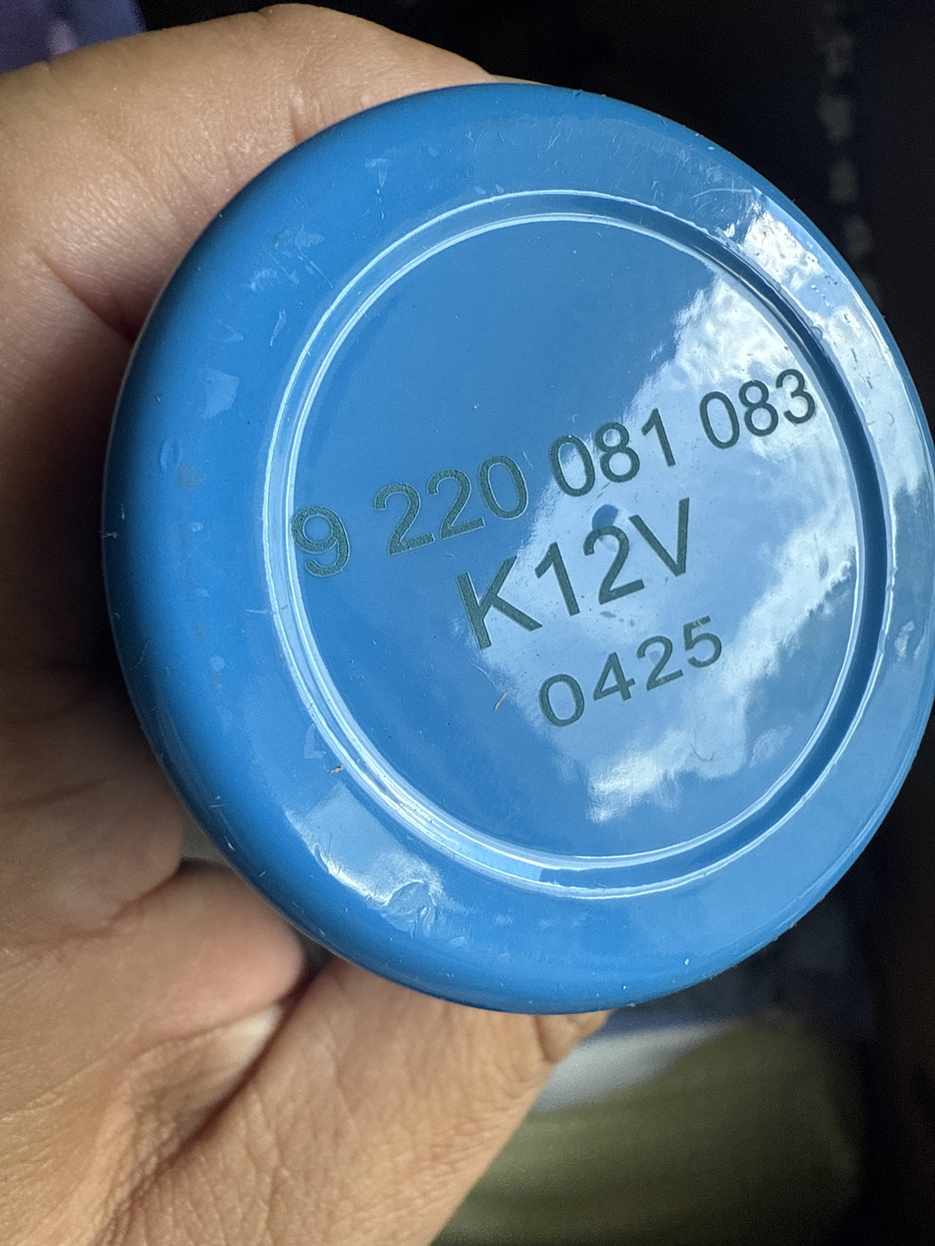

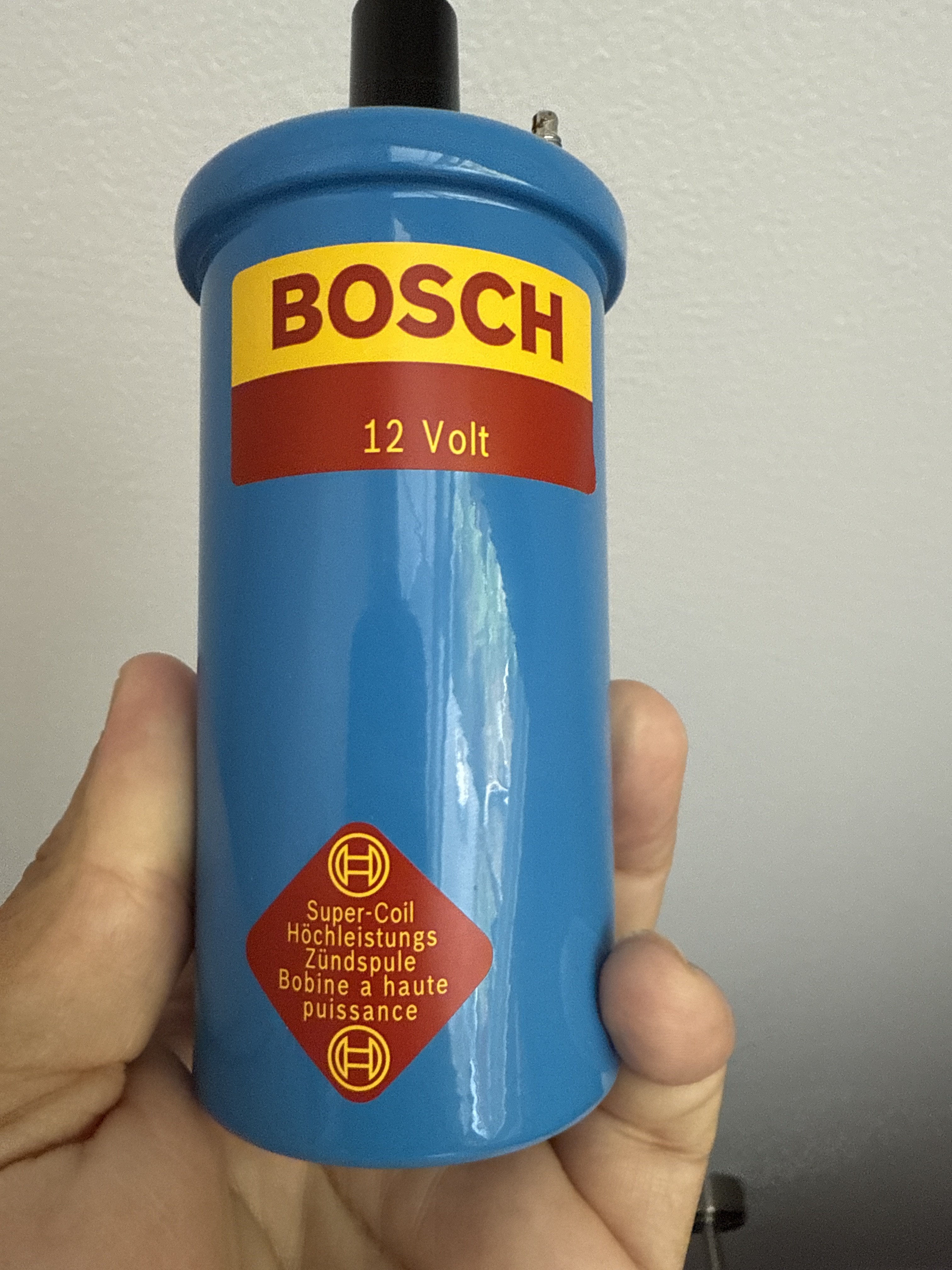

is this the Bosch blue that they say is good and works with our cars? I have 72 fiat 500 L. this coil is from Brazil.
The one recommended by a reliable supplier in the UK has the part number 0221119027.
Entering the part number of the coil in the image shows it to be compatible with some larger engined Fiats. But then checking against the licence plate of my Fiat 500 (in the UK, the licence plate links to a central database which identifies the make and year of the car), the coil is incompatible. Using the same database against my vehicle, it suggests the 0221119027 which is recommended elsewhere.

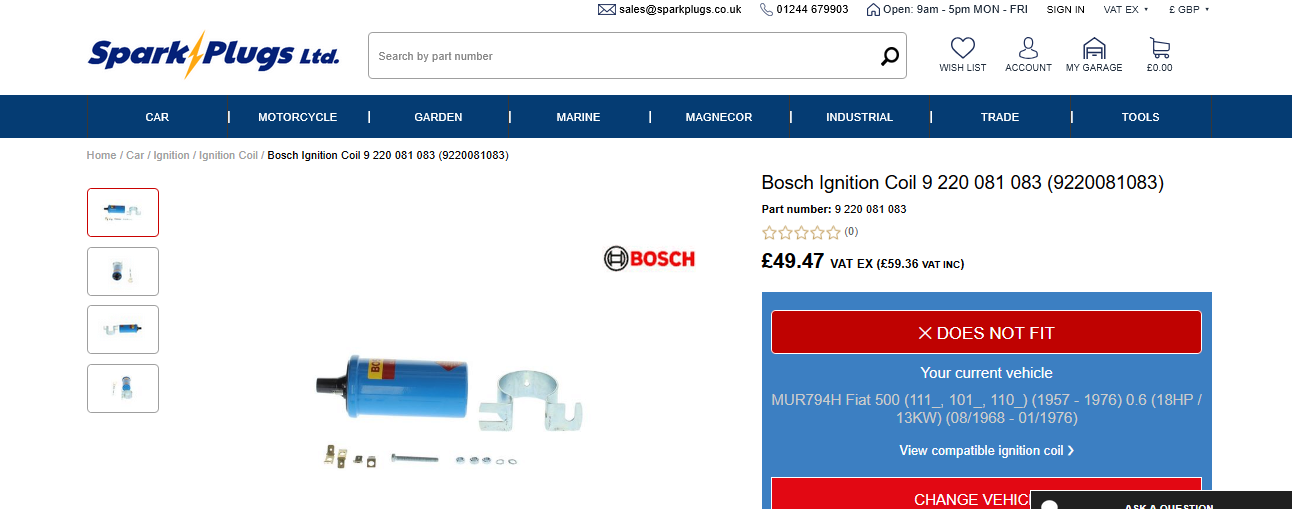

Fair enough....I would trust Motobambino better than I would trust myself. However, the screenshot is attached, and there was quite a lot of online discussion about this elsewhere when I bought one a few years ago.

I've just checked out on Motobambino, and the coil that is listed is not the one shown by @Hawaii five 0 0 , but is actually the 0221119027, as I recommended based on multiple recommendations online for unballasted classic car ignition systems....see screenshot.
PS. 3.4 ohm.

The Bosch coil that Peter has highlighted is available from"VW.NOS" in Houston,Texas---much nearer to Hawaii than we are! Peter---the Bosch "Blue coil" that Mark (Motobambino) is selling has 0221119027 on the side of it, and that is the one that I have used---thank you for high-lighting the 9220081083 coil, it might well be the better one to go for.
