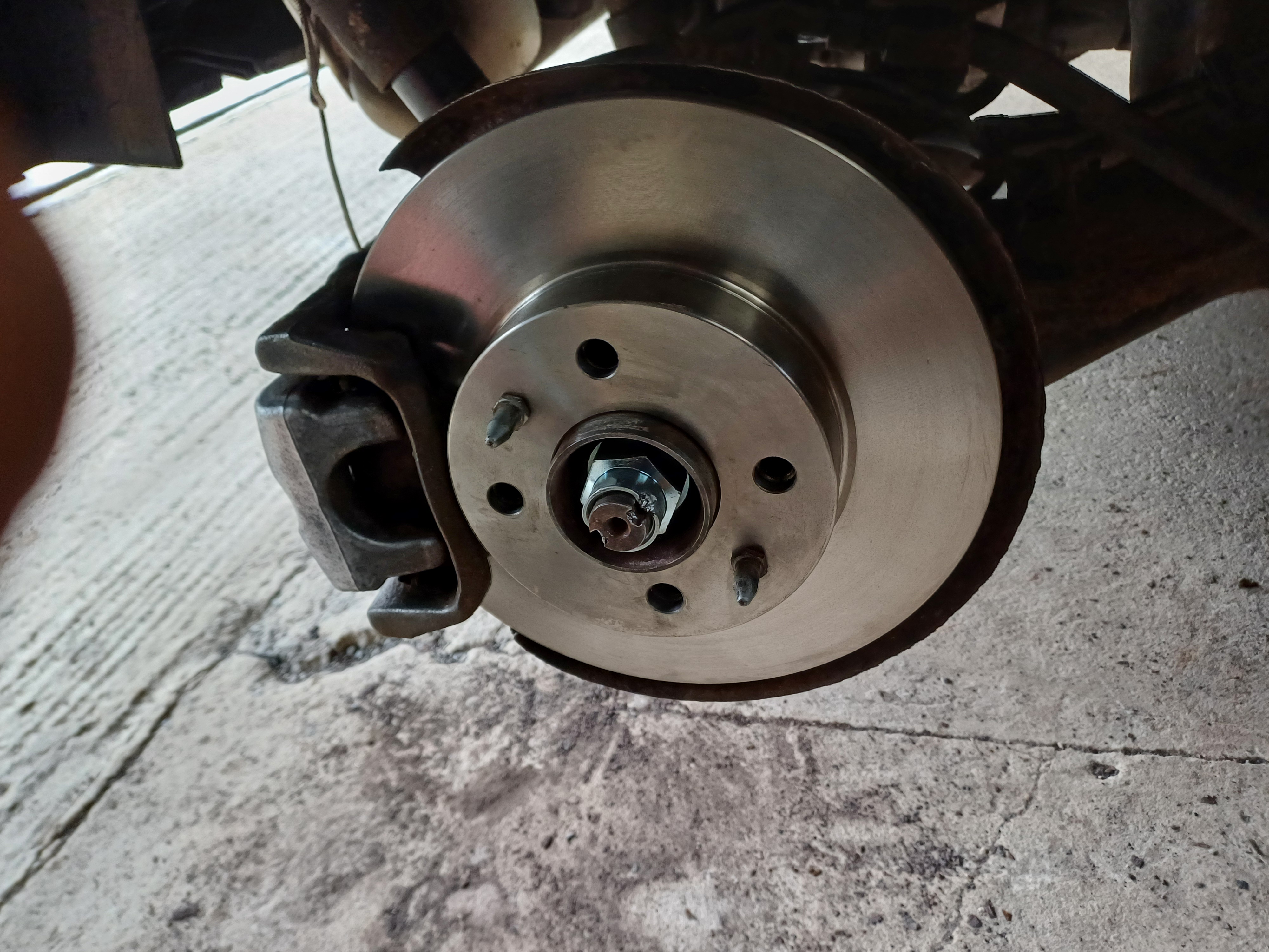

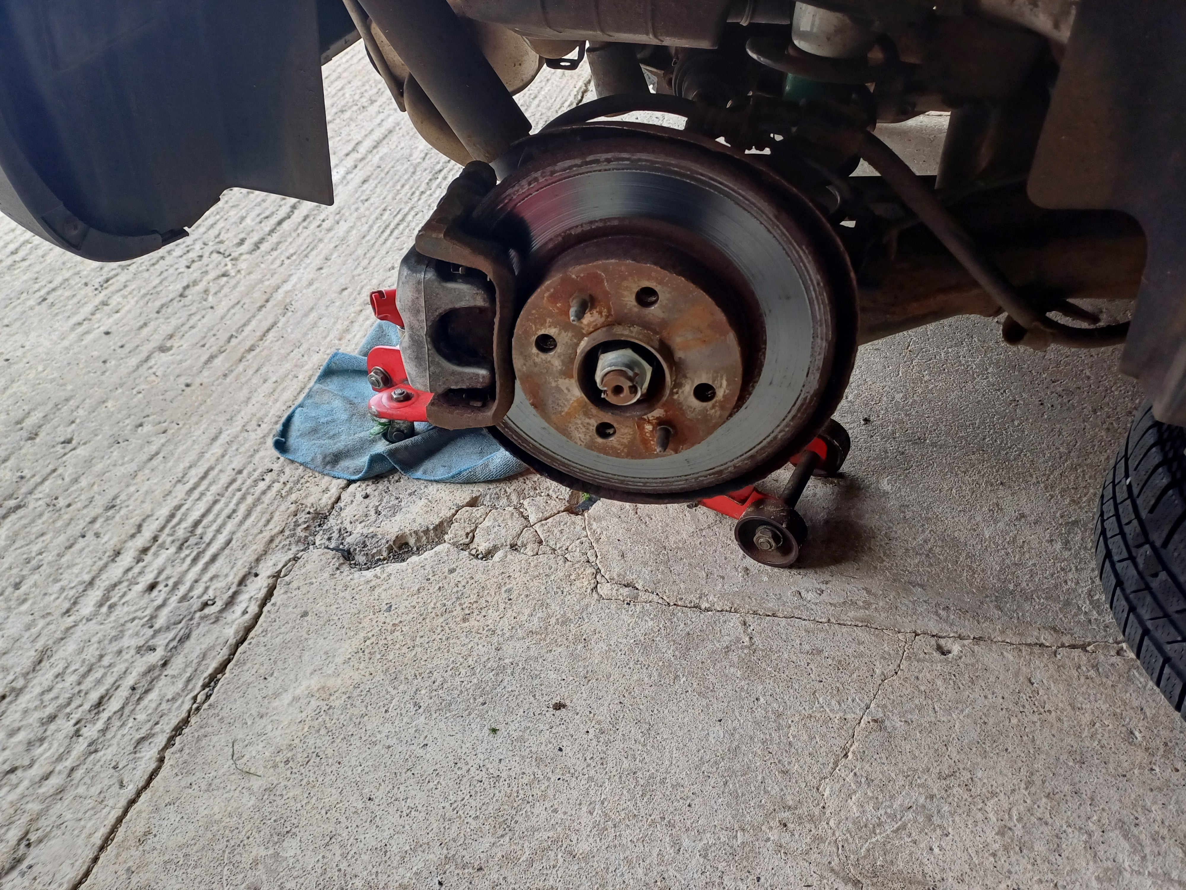

I've loosend off the wheel bearing carrier bolts which took a breaker bar to crack them off so that part shouldn't give me too much grief the I will remove the abs sensors stop them getting broke, then I hoping after that it should be pretty straight forward just a lot of hassle for a pad and disc chang seeing I changed both front ones in an hour

I've got a double garaged arranged for Thursday to finally get on with this,was going to do it at work but there's too many distractions and nosey sods at work and the way the weather's been I'm not going to do it on my drive! so I binned those 2 ideas, I'm going to try left side yellowcar way and the right side the with hub nut hub off way for the benefit of experiment and see whether it does actually damage the bearing or whether that's bs

I don't think there is any reason there will be bearing damage if you are sympathetic to the set up; you probably just don't want the bearing to separate...
When I do them I will take photos of everything I do I might try one side the yellowcar way and the other side by removing the hub, and see if I can get the wheel hub off without knacking the wheel bearing, what annoys me is if fiat had used their noodle they wouldn't have hidden the caliper carriers bolt behind the bloody subframe!

You'll be fine; first side took me 2+ hrs as I went up the learning curve, second just 45 minutes (and that was with a G-cramp and adjustable for the brake pistons). Have to say I did take the Yellowcar route - I'd want to know a replacement bearing was available before I messed with the hubs.

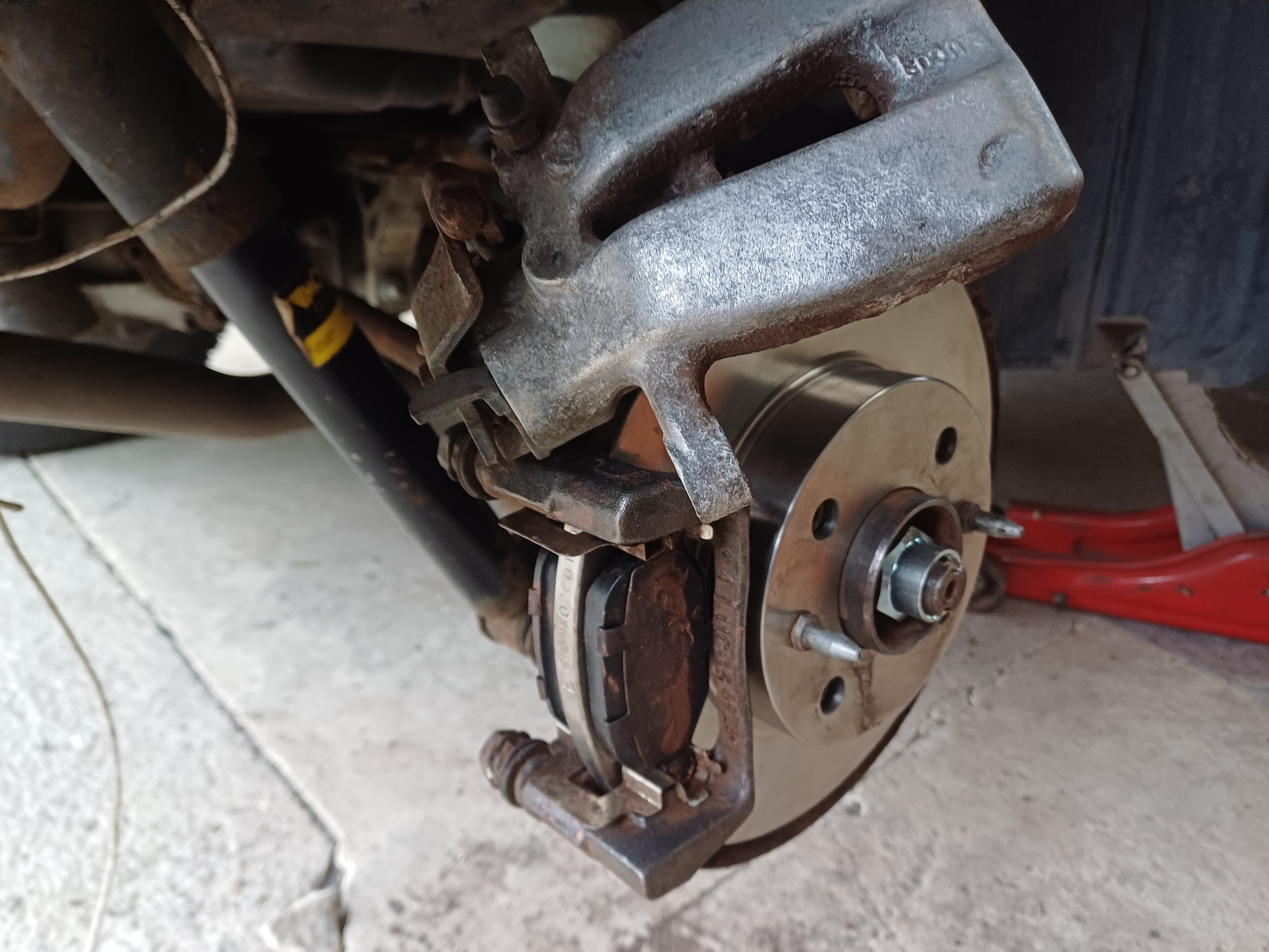

Done the offside, every bolt was mega tight and corroded having to heat up bolts to get them out, then the bleed nipple decided it didn't want tighten up, so I had to clamp the pipe take it out and clean it up and bleed it so best part of four hours, only part that went smoothly was winding in the piston, I cracked off all the bolts to do the nearside tomorrow
Very thorough I'm afraid I did the calliper clean up on the car (no brake bleed). On the tight bolts thing (you probably noted) all the bolts on mine appeared to have blue thread lock on - a bit of heat (hot air gun) helped this situation otherwise just very well fitting tools (read new!).
One of your photos triggered a memory about removing the bottom shock bolt which I think gets you some more room (allowing the radius arm to drop some more) in the wheel arch (I can't think I would have done this for any other job back there?).
