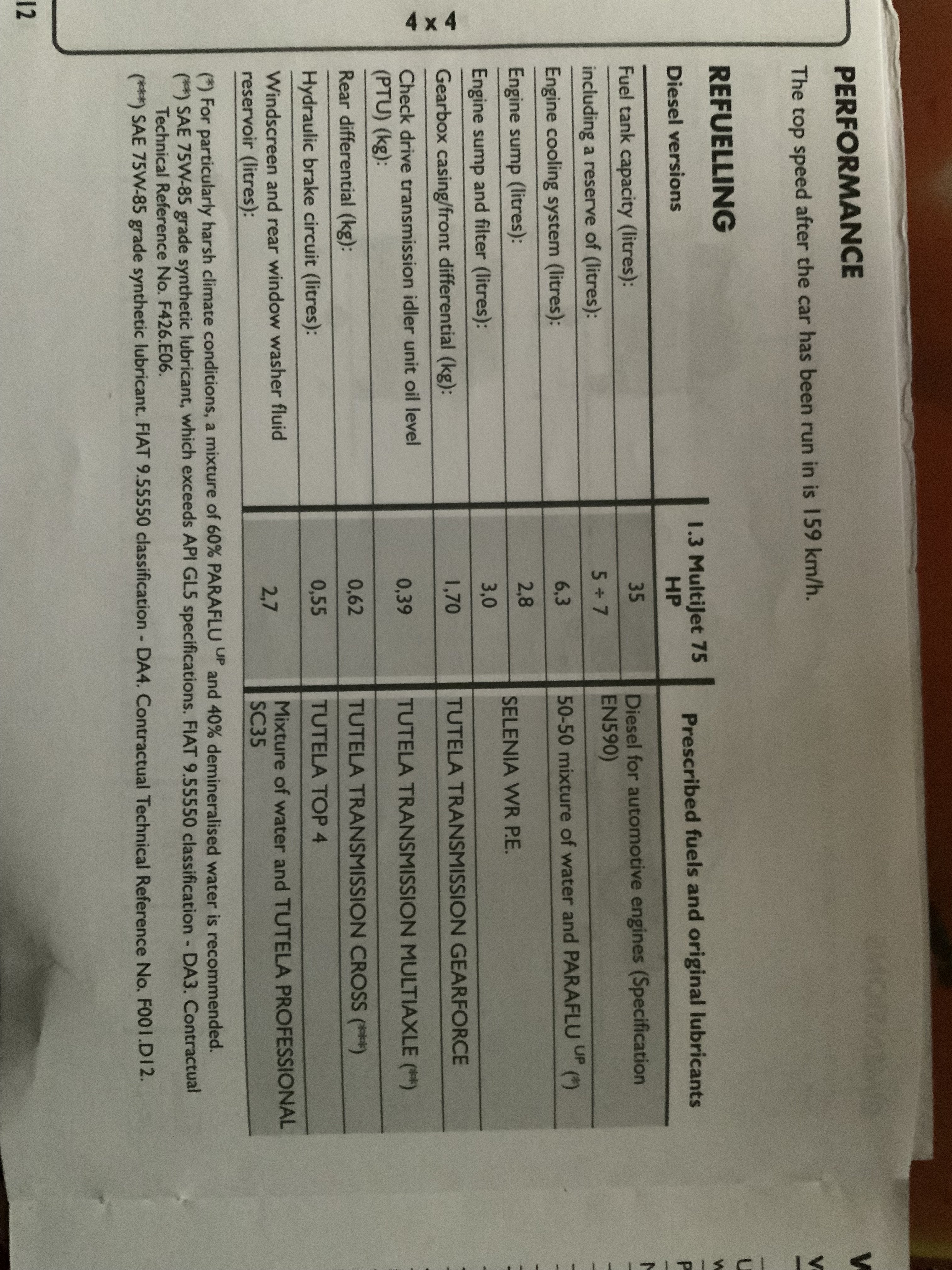

I know this is for a diesel, but the rear differential the same a cross the range and note different from the front differential/ gearbox. ( whilst the gearbox and front differential share common oil, In reality they are compartmentised. I.e. when you drain you will see significant change in colour between the two zones.) Some vendors have not realised that front and rear different.
I know this is for a diesel, but the rear differential the same a cross the range and note different from the front differential/ gearbox. ( whilst the gearbox and front differential share common oil, In reality they are compartmentised. I.e. when you drain you will see significant change in colour between the two zones.) Some vendors have not realised that front and rear different.View attachment 475781
Thanks. Seems I bought the wrong transmission oil. I will send it back and get the transmission cross one because I bought the gear force one. I was looking in the main manual and I had forgotten about the little 4x4 addition booklet and like yours mine mentions the rear diff and the transmission cross oil and the volume required. Thanks everyone!
That image is for the older 169 model supplement I think (based on the graphic design of the pages)
The latest manual (mine's dated June 2017, supplied with a 2018 4x4) covers both the 2WD and 4WD versions (Cross and Non-cross) in the same 200-plus page handbook... This doesn't show the quantity in ml, but the weight in kg... but it is the same rear diff oil as the older model (@euroben Note the newer spec for the main gearbox on the TwinAir model -- Technyx, not Gearforce-- and that there's a little more oil in the front end with the 4x4 versions)
The latest manual (mine's dated June 2017, supplied with a 2018 4x4) covers both the 2WD and 4WD versions (Cross and Non-cross) in the same 200-plus page handbook... This doesn't show the quantity in ml, but the weight in kg... but it is the same rear diff oil as the older model (but note the newer spec for the main gearbox on the TwinAir model)
No it from the 312 from a 2013 vehicle 4x4 supplement .
I stand corrected :) (Its a while since I sold my 2012 4x4)... My 2017 and then 2018 models had it all in the one book. I edited my reply above to include all the relevant lubricant info pages as it may be of use to those reading this thread at a later date
