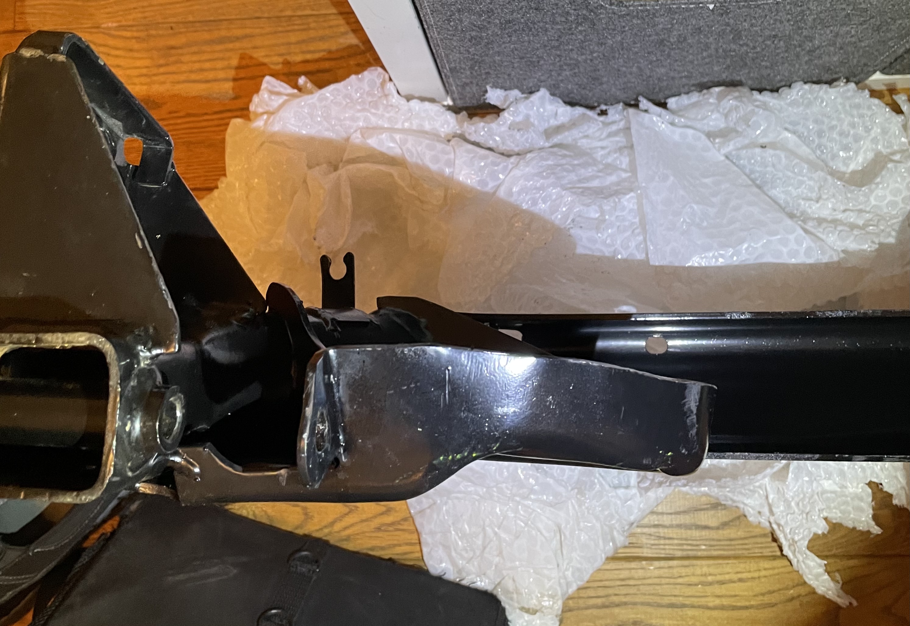

Hi, would I be correct in thinking that all the near side spring cups on the Panda and 500 appear to dip slightly?

Hard to tell from the photo but I am guessing your talking about the nearside slightly twisted round (lower) towards the road than the off side
If thats the case then every panda I have looked at, its yes
Whether they came out of the factor like that I dont know
replacement 3rd party axles don't, there level

That’s why I asked, bought a new replacement one thinking mine was bent and it was exactly the same. On the plus side it turned out mine was fine and I didn’t have to modify the new one to fit my 100HP.

It does seem a weird design though as the spring is not in full contact with the cup.
yep seems weird to me also
I have knelt down in car parks and looked at the rear spring when there were more pandas about. I thought my cars looked wrong
everyone I looked at was the same.
my 05 and 06 were the same, never looked at my 2010

I think they are both supposed to be level, but were wrongly jigged at factory. I have also looked under quite a few, and found they all dip, but not all the same. Some aftermarket replacements also dip, as they are an exact copy of the original. (Mine also came with most of the little brackets for brake hoses, etc., also bent. I saw a whole pile of them, all new, all exactly the same. I guess the original they copied had been damaged in transit, and got copied exactly. From that, I assumed they would have got the metal thicknesses right too.)
If the latest aftermarket axles have straight spring cups, that is a good thing.
If the car sits level don't worry about it. It the car is higher on one side the easiest solution is a spring spacer to adjust the issue. Obviously, the best of all is a properly made axle.
