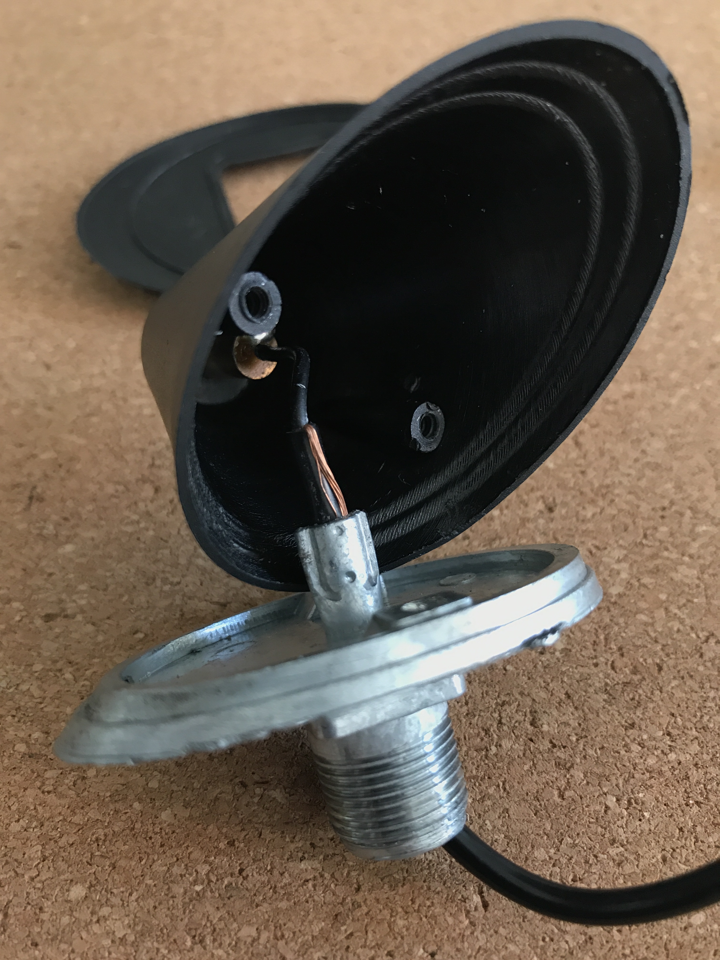

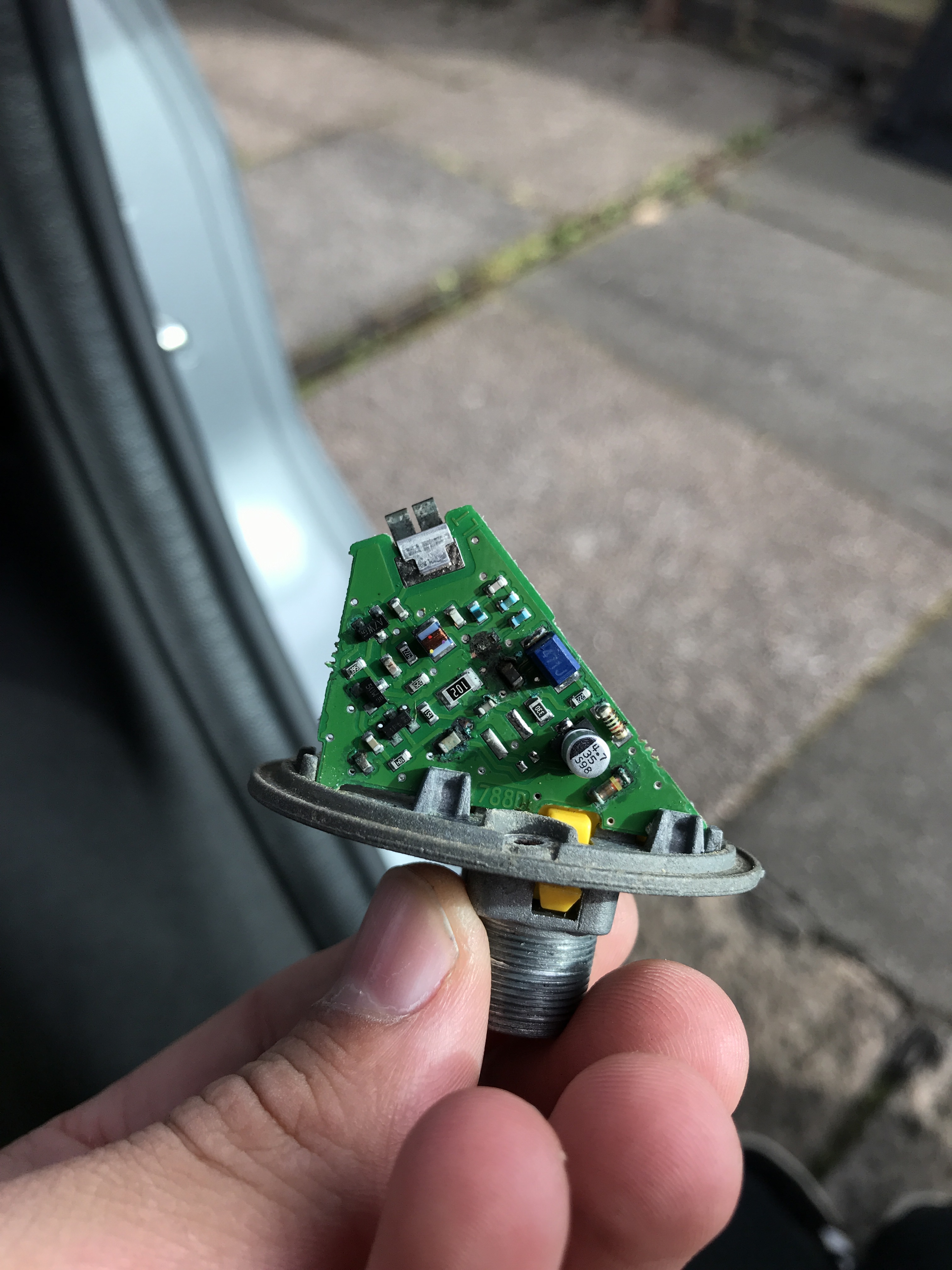

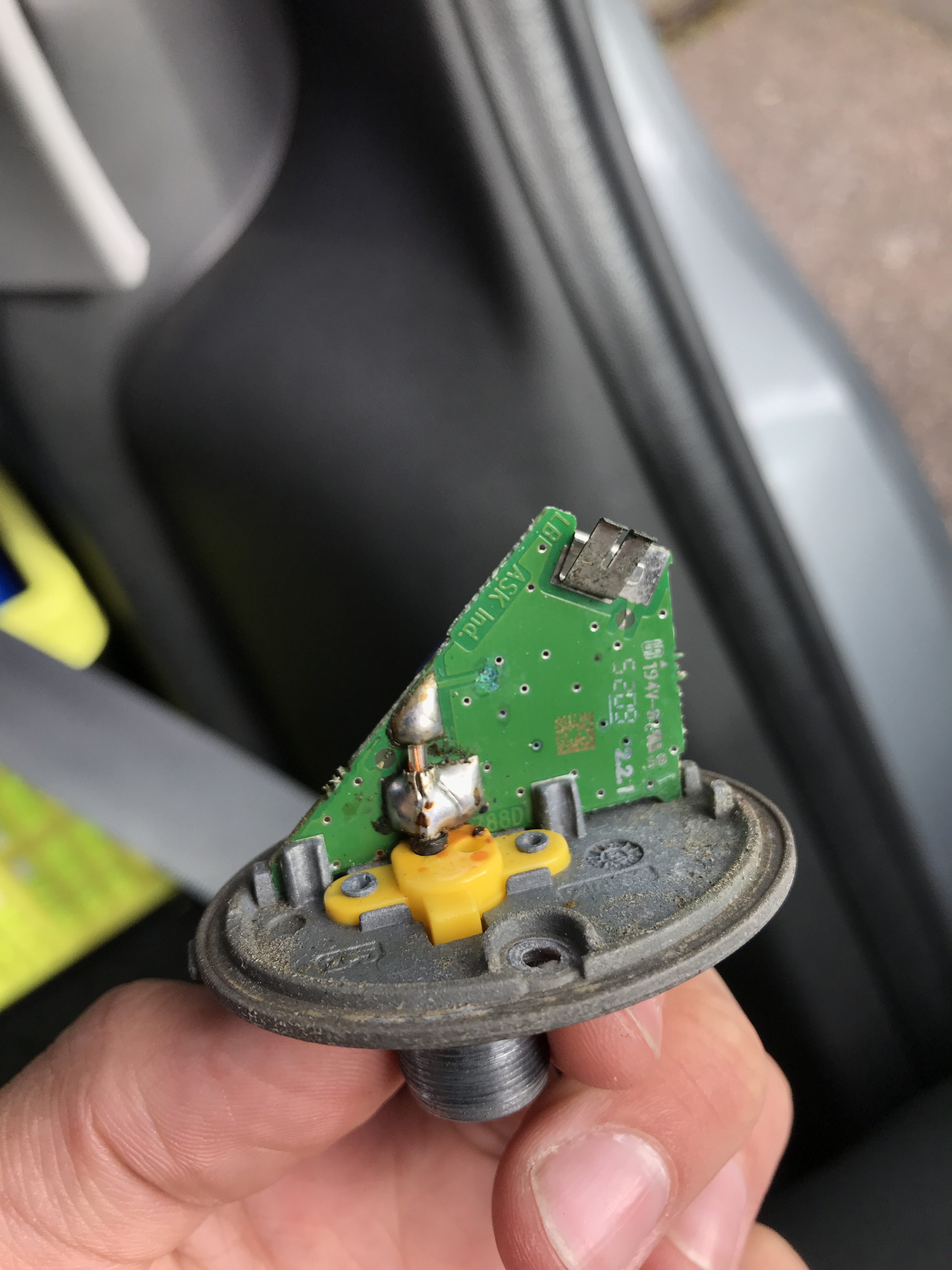

There is a electrical circuit in the antenna base! Just bought a T5 bit and got it open to find this... looks knackered in my opinion [emoji31]
I’ll have to buy a new base now, bye bye £30.
(The previous picture was of a replacement on eBay but this clearly isn’t adequate as there’s no circuit like in the original base).
