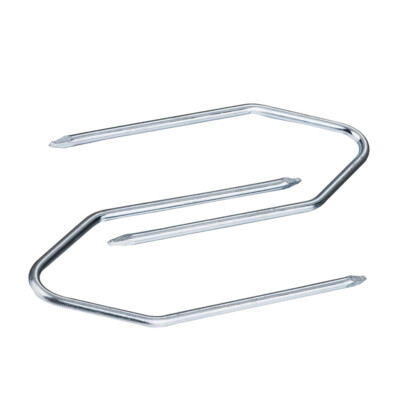

To take the radio out of the console, you'll need some special tools of this kind:
It can also be done out of a drycleanings' hanger :)
