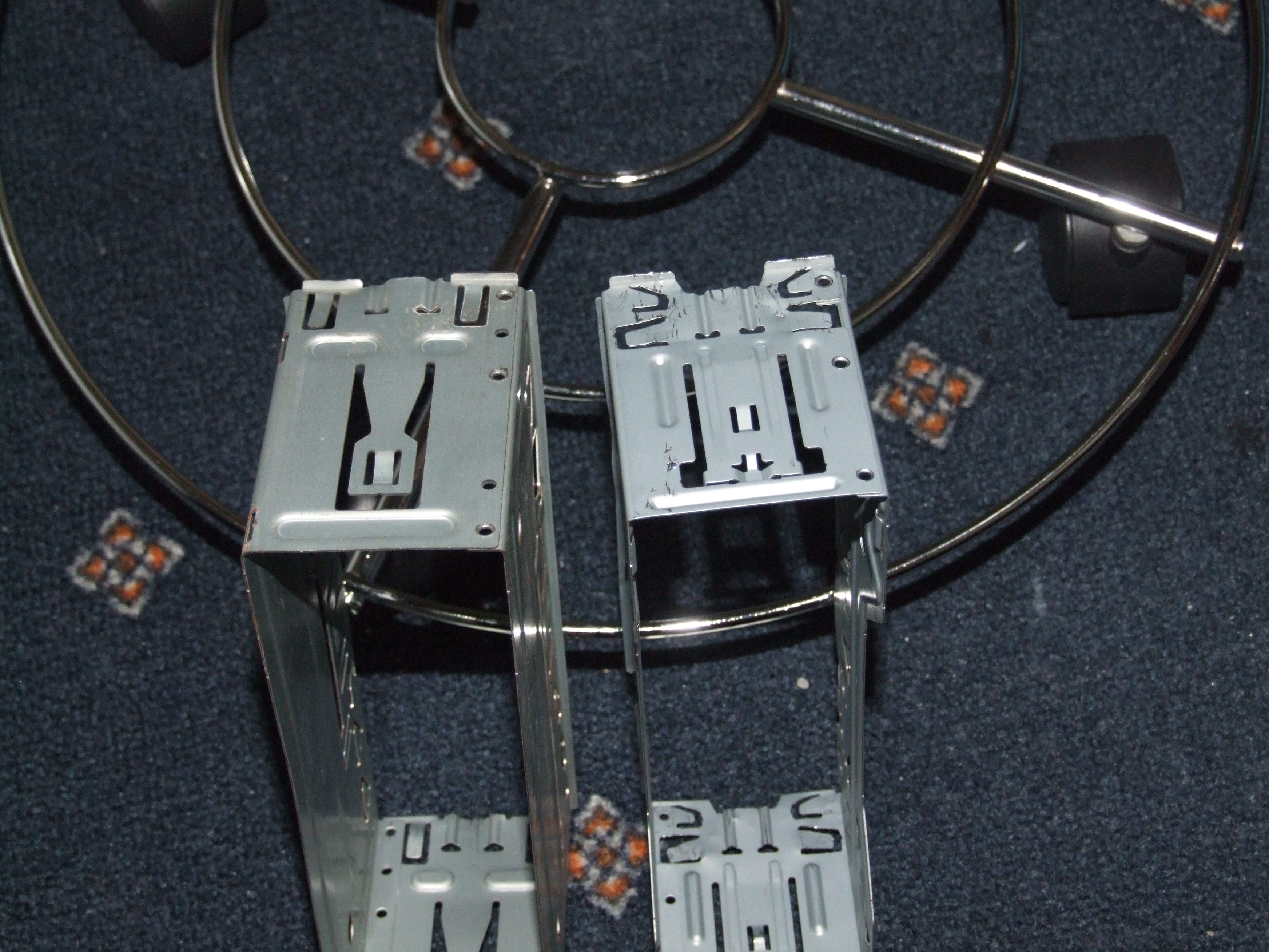

I have dug out a couple of the cages I have floating around and as you can see they have differing latching systems but in general you need to depress them.
As I said sometimes I have pulled the whole lot out, cage and radio, by getting at the tabs around the edges.
