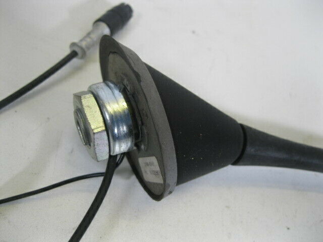

the base of the aerial may have one or two cables coming from it
one power for the areal amplifier if fitted
one for the aerial
here a photo of a base with amplifier. I am not sure if they were fitted to all models
both connectors should be close to each other
the single wire type without the amplifier look to be a different shape to the one below looking through ebay.
