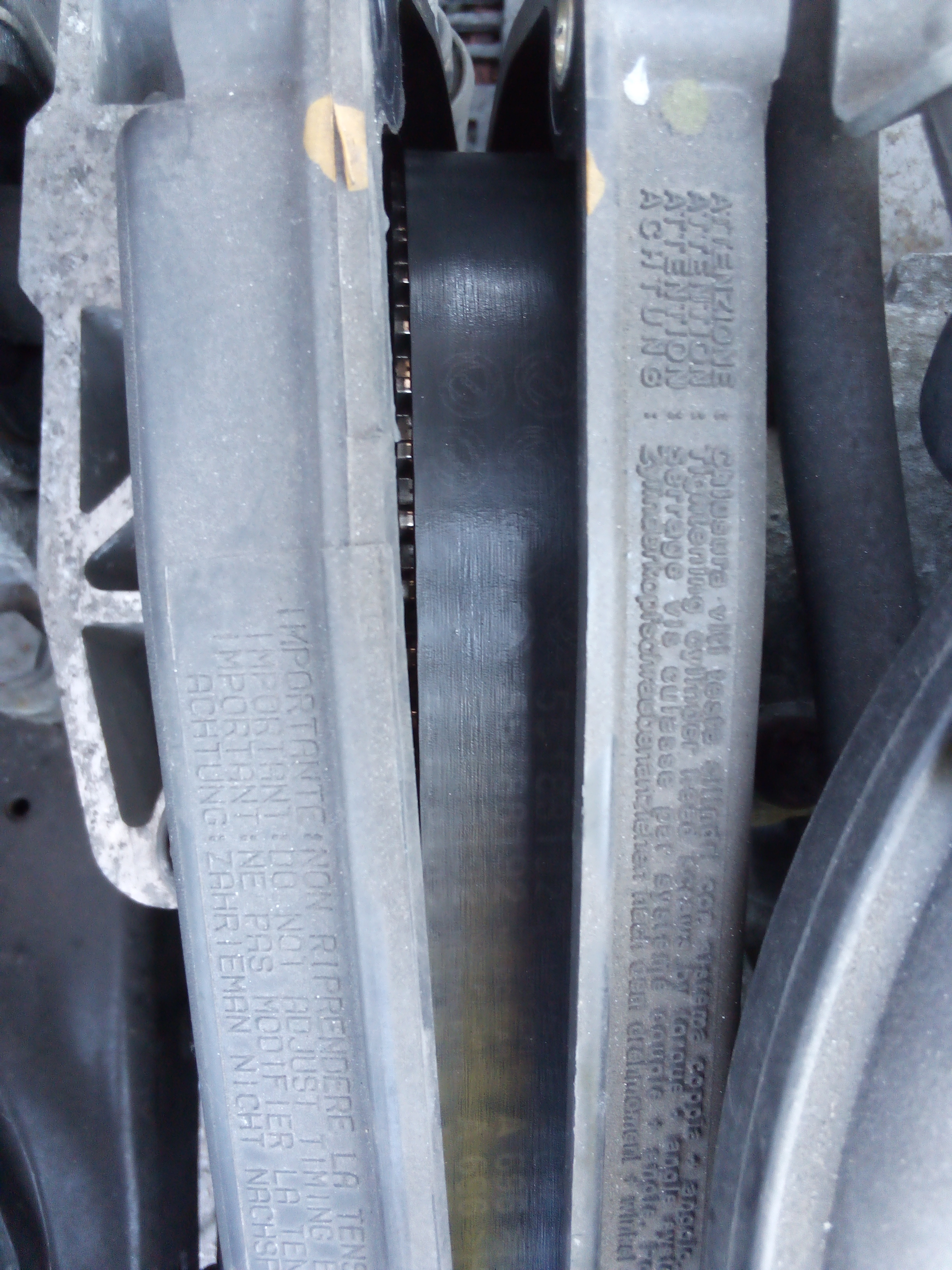

Have been busy elsewhere though, gave the Stilo an Oil + Filter change, Air Filter and Pollen Filter.
Air and Pollen Filters were certainly overdue, as they were the original Fiat Items. Pollen filter just fell to pieces when I removed it.
Also thought I'd inspect the Cambelt too while I was there, yep original 14 year old Fiat Cambelt too. :eek:
So hopefully I can get it to a garage asap to do the Belt, as they no way I'm leaving that to chance.

I'm curious to know how you ascertained it was a 14 year old original ?
Well I'll do my best to explain why I believe this to be correct. Given all I know about my Stilo and it's history.
As previously mentioned, my Stilo despite it's hard life has only covered 49,000 Miles from new. Which I'm pretty certain from the way it drives etc to be genuine.
Also bear in mind, that the Cambelt service schedule is at 72,000 miles or every 5 years according to the Fiat handbook.
I know that my car was involved in a accident to the nearside, at about 3 years old after it's 1st Mot in Aug 2009 at 27,481 miles. When a Insurance Company decided to class it as a write off. So then it stayed off the road somewhere for almost 6 years. Until it was sold on and repaired, then Mot'd again in July 2015 at 32,165 miles and 9 years old.
Which you can also see by viewing the gap in the Mot history online, at the GOV.UK website.
So the car wouldn't have had it's Cambelt changed at the 5 years interval, as it was then still sat off the road and hadn't yet reached 72,000 either.
An when the car did get finally repaired, it was done the cheapest way possible and poorly. The panels have all been badly painted with run's etc and the nearside door's have a comedy level of bad filler repairs. [ Hence me buying a used pair of Doors. ]
If there happy to bodge the bodywork so blatantly. I'd say that them changing the Cambelt for a genuine Fiat item. On a 9 year old car that's a previous write off, with a lowish resale value. Would have also been highly unlikely at the time.
I know after it was repaired, it was then sold to the last keeper in 2015 till last year. When I purchased it.
The Trader who I brought the car from, said he also personally knew the previous owner. Which he said had traded in the Stilo for a Van he was selling.
When I asked him about the car and it's history, including the cambelt. He told me that the previous owner hadn't bothered changing it. An given the state of the car when I first brought it. I'm inclined to believe him.
Hence me checking the belt the other week, as the car has mostly just sat since me buying it until now. An as I want to press the Stilo into daily use once this situation over. I want to make sure that the servicing is up to date.
If you enlarge the pictures on my last post of the Cambelt. You can also see that the belts are clearly genuine Fiat part's. With the part numbers and logo's still visable.
So coupled with the fact I have no service records of the cambelt being changed. The length of time the car sat off the road and the poor workmanship on previous repairs/ neglect etc. Then after actually checking the belt myself. Which upon close inspection has also gone hard with fine cracking with age. Plus there is the original paint marks from the factory that are still in line on all the covers etc. I'm pretty certain that nobody has bothered changing it.
I've decided to hopefully have a full Cambelt and Water pump replacement fitted next week, for piece of mind. An I'm also having the Alternator Belt and Aircon Belt changed too.
I'll ask for the old Belts back if anyone want's to see them.:)

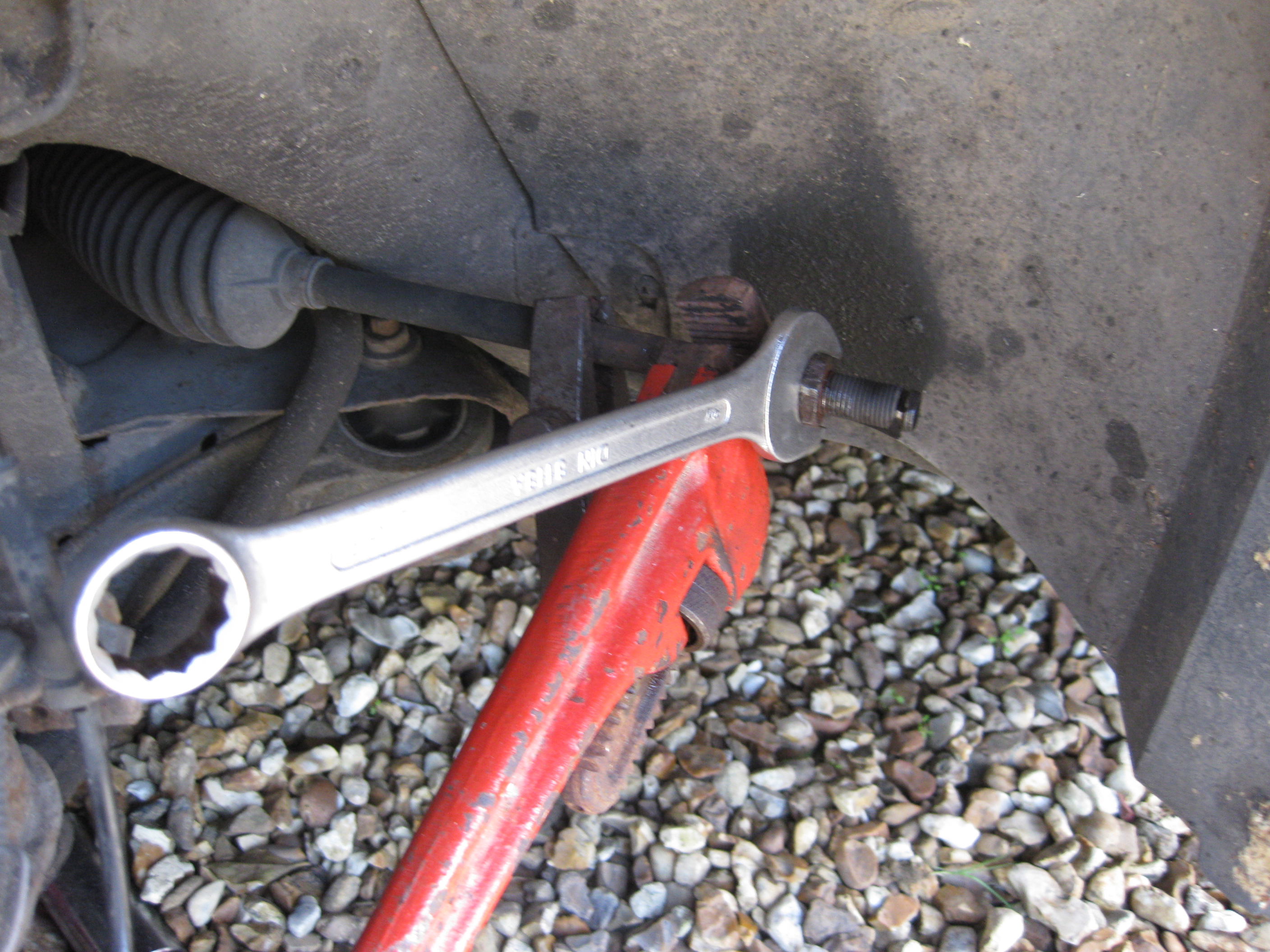

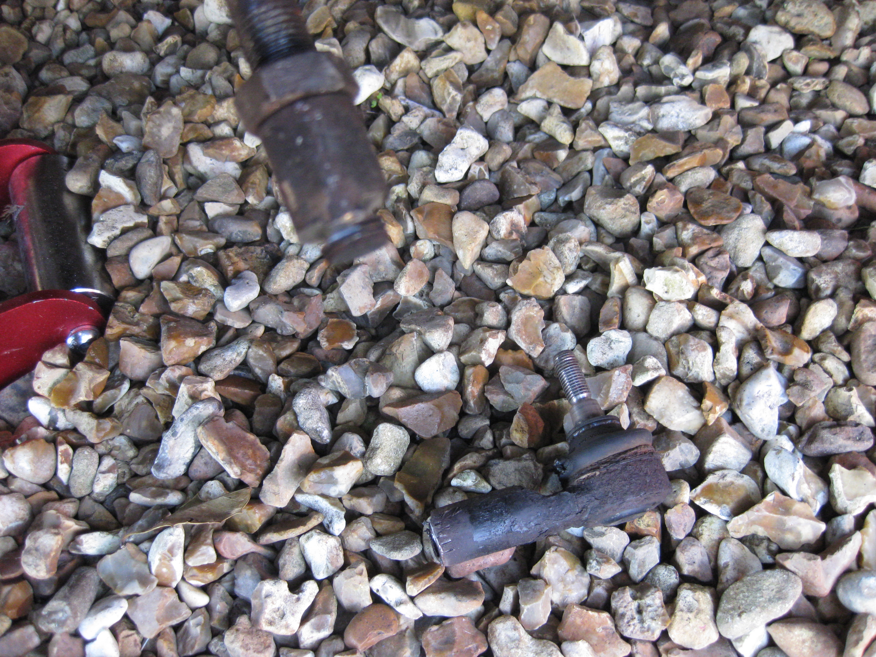

I'm waiting the arrival of a pair of Track Rod ends.
Okay figure this, I put it in for an MoT with the Crystal Clear Instruction that if it passes then please track it, or if it fails on something other than steering/front suspension, then please track it.
I pick it up, they charge me for tracking, and on the MoT sheet under 'advisories' it says "Track rod end ball joint has slight play Nearside front". W.T.F. is it me or am I dealing with a bunch of ***ts :bang:.
So we agreed that I'll buy and fit a new pair of ends, and they will re-track it for free :D.
So now the furore is dying down and my local garage has reopened, I thought I'd get the ends on and get it re-tracked before they 'forgot' they hadn't done it properly and owed me a free one.
Not sure how they managed to do it (track it) as the offside was extremely stiff/rusted and need heat to get it off. The near side was completely rusted on and I had to cut the old end off. Both were marked TRW so possibly were originals and not moved for a number of years.
With the new ends on and retracked it now steers superbly :).

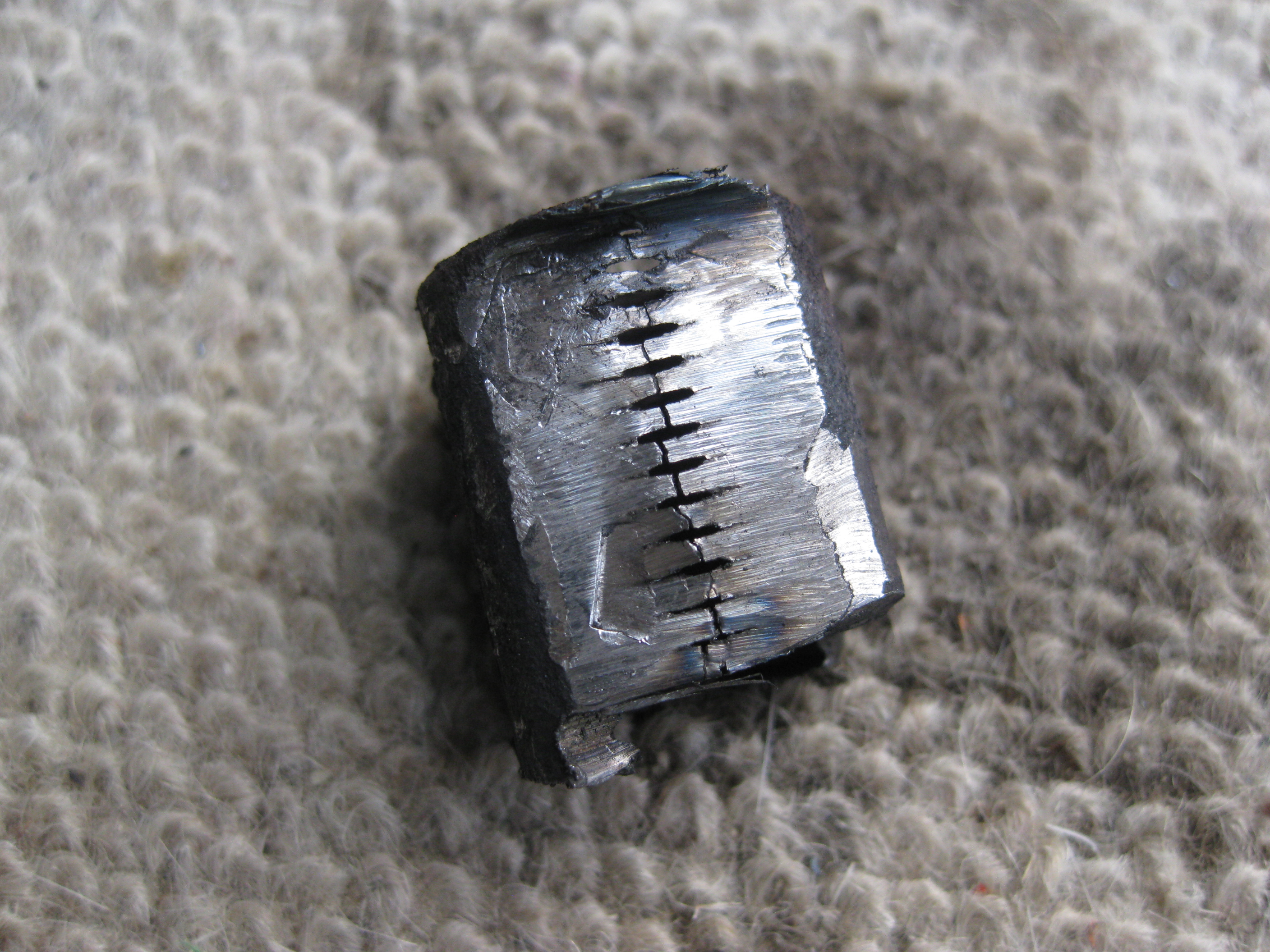

Would have been a full success story, but I noticed when I got back home that the hand wheel on the Drivers seat reclining had come off and was missing :(, okay it could have come off at any time, but I didn't notice it before and have my suspicions :mad:
