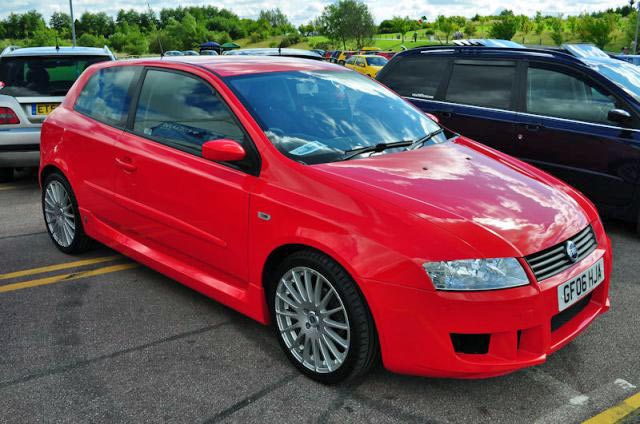

Looks great! Good work with the sunroof, wish mine had it... What colour code is your car?
Quite an old pic, but she still looks the same.

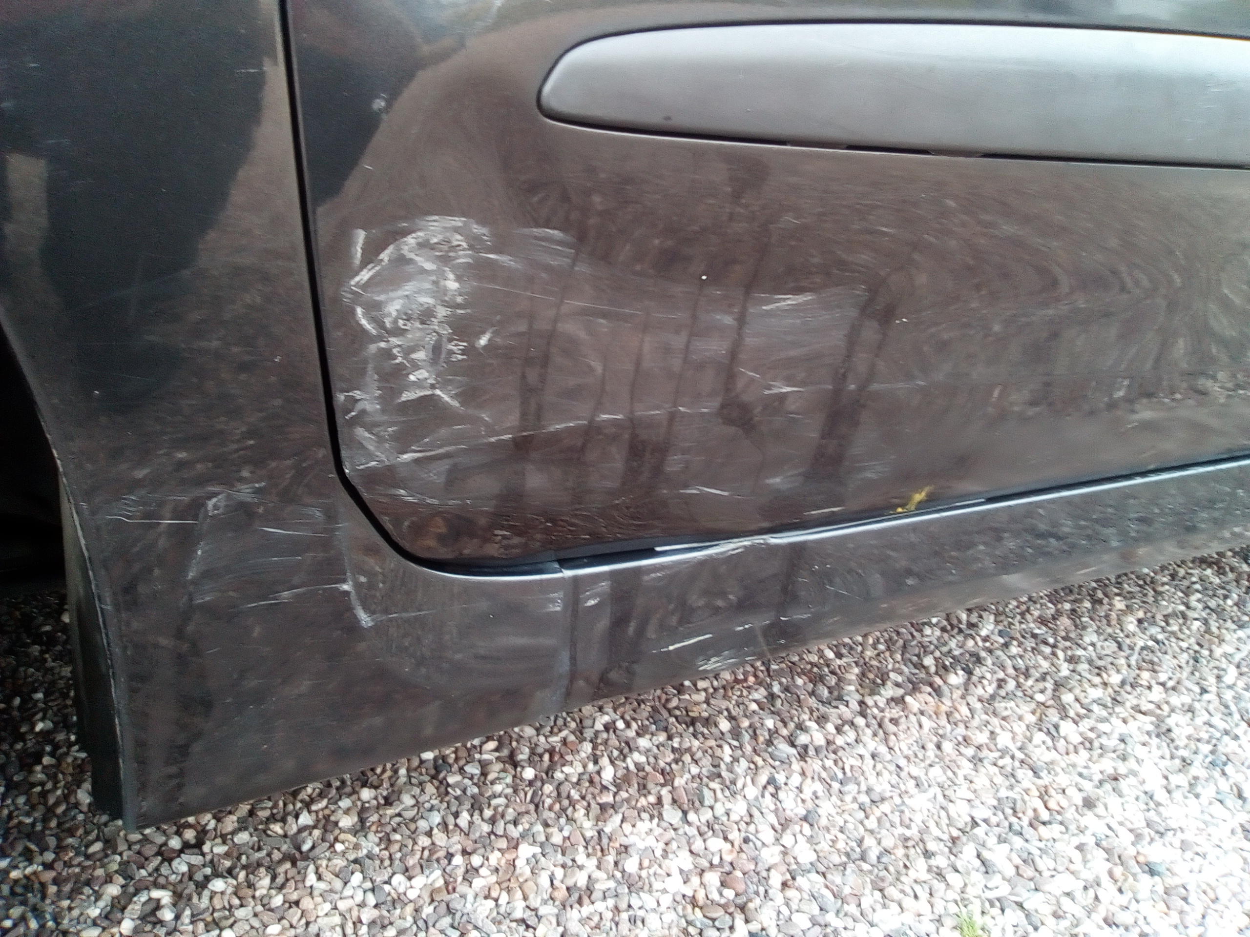

I have my 2006 1.6 Active SW which has been sat awaiting attention to keep me busy during the current situation. Brought locally last year as was looking out for a cheap estate car, although I shouldn't have as it's a Estate in a State!
But I felt so sorry for the Stilo when I saw it, that I brought it anyway after a test drive. Amazingly this has only done 48,000 from new. I reckon it's likely genuine as driving wise it feel's pretty decent despite it's look's.
The interior is pretty well destroyed and was disgusting to sit in before and smelt horrible too. Headlining is torn and dirty. The nearside front door card was the wrong colour and smashed. The car has previously had poorly repaired damage to the nearside, mainly the rear door. As it's mostly filler and the nearside front door and sill has been dented again by the previous owner.
The Roof is dented above the offside door's, how someone managed that I don't know. Also the offside had a smashed rear light and bumper.
Plan's are to get it looking tidy again as best I can, although being a SW mean's finding decent used trim is proving difficult. As most have been used as cheap workhorse [like this one] and get run into the ground.
With help from my Brother. I've already fitted a used rear bumper and light. Replaced x3 Door cards and the rear Boot carpet all brought before the lockdown. An fitted new number plates.
I've made a start this week on trying to cut back and polish the bodywork as best I can to remove the scratches etc.
I'll try and add some photo's soon to show how it look's now. The photo's I've hopefully included were from when I collected last year.
