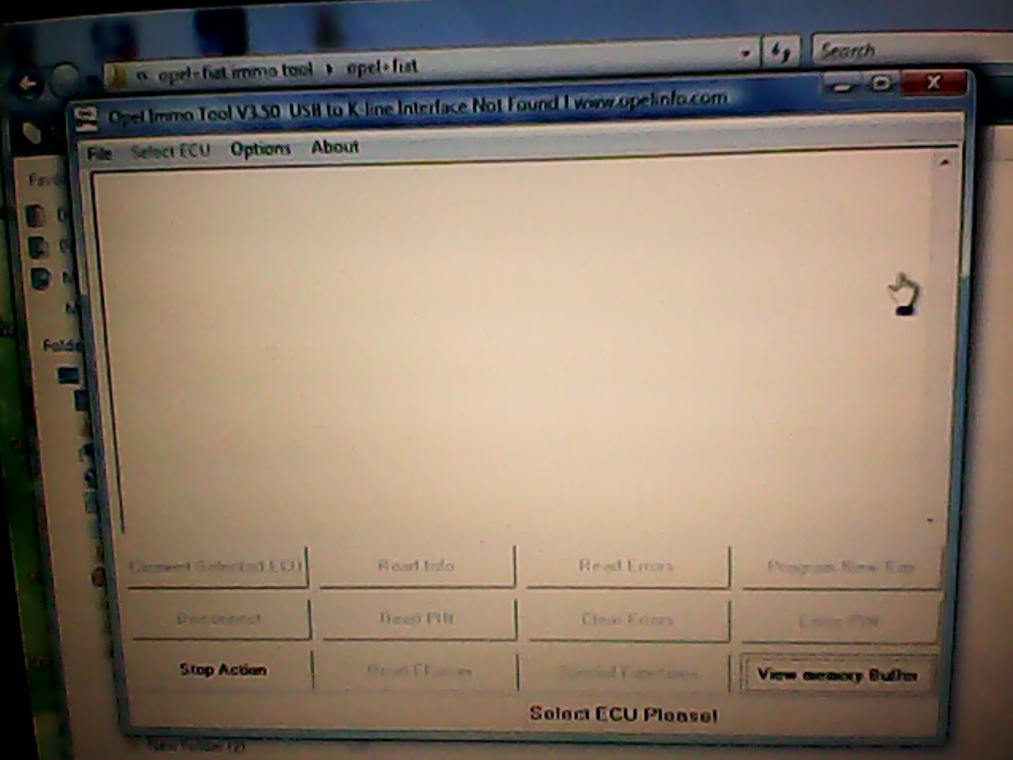

Hi fellas , I might have a solution to your key programming, so you can do it yourself and save a bundle.
Programming a new key , the software is called Opel+fiat immo tool.
Here is a pic of what it looks like
I really haven't got a clue on how to use it, I haven't tried it.
Here is a link to YouTube, someone using a software called cryptowork to add a second key
[ame]https://youtu.be/kxrXOdrdaQo[/ame]

Cryptowork was part of Nasratech the company is now pretty much defunct. No support and plenty of owners ended up with dead equipment (including myself)
The only BCM reading it covered was the Delphi units used in the mk2 Punto and the early Marelli units on the Stilo and Doblo. It gives you the dump file from the BCM but you still need other tools to make use of this information and actually program the key.
The Qubo has a different BCM its the same unit used in the Fiat 500 and Grande Punto. There are tools that can read and match remote keys to these units but Cryptowork isn't one of them. Although if you just want a non remote spare key they can easily be cloned.
If your wanting to make remote keys then your talking relatively serious amounts of money in equipment. I personally have and use Zed-Full or AVDI to make spare remotes on these cars or if the keys are lost the BCM can lock meaning you have no communication by OBD in which case I use TMpro to add a new key directly to the cars memory.
