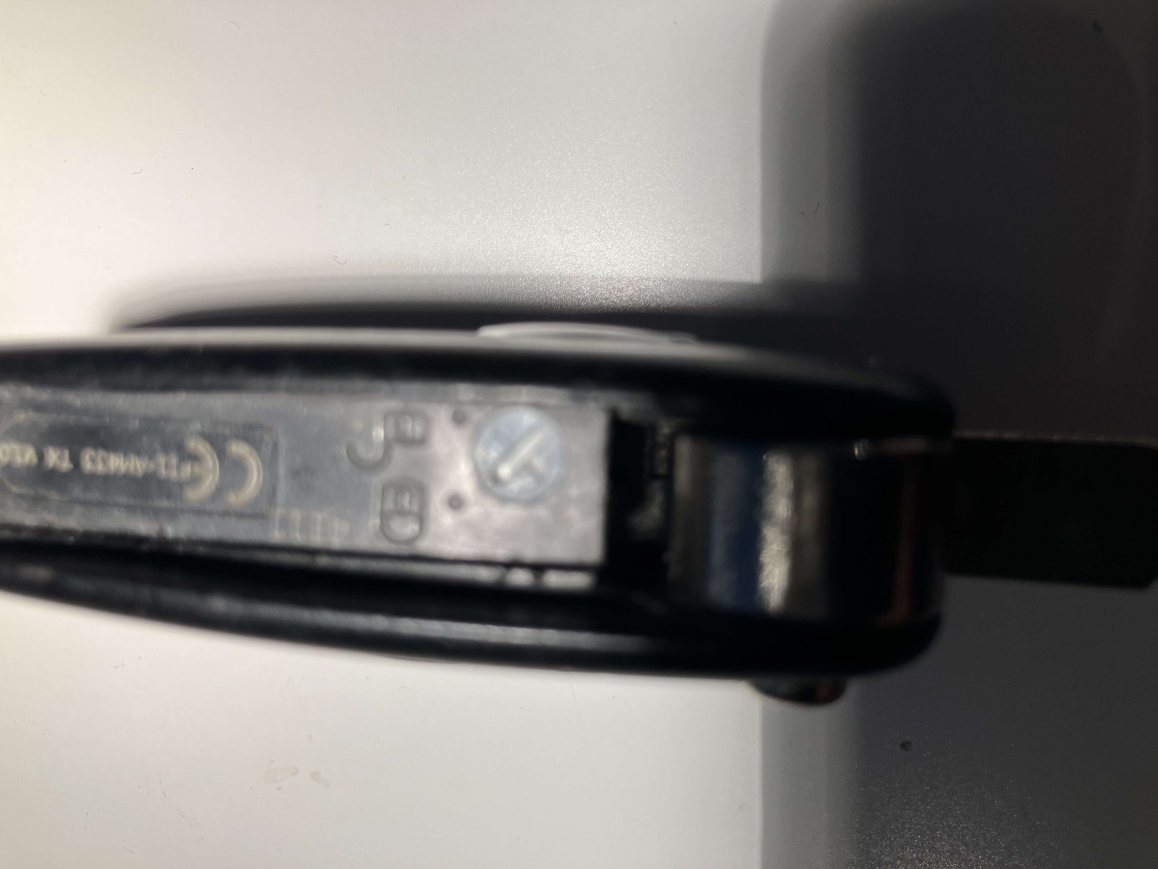

The Dribbler Member Joined Nov 3, 2024 Messages 8 Points 80 Location Kilmarnock Nov 3, 2024 #1 Keyfob-I’m trying to get my fob apart-one photo shows how to unlock it but can’t seem to do it. Is there another secret way of doing it-2012 Qubo Any help appreciated Attachments IMG_0790.jpeg 2.2 MB · Views: 531 IMG_0789.jpeg 2.5 MB · Views: 748
AnthonyH Patron member Written a guide Written a review Joined Nov 5, 2023 Messages 4,699 Points 1,384 Location UK Nov 3, 2024 #2 Theres a little screw which needs to point to an unlocked padlock icon, then you have to prise.
OP OP The Dribbler Member Joined Nov 3, 2024 Messages 8 Points 80 Location Kilmarnock Nov 3, 2024 #3 Thanks AnthonyH-worked a treat
