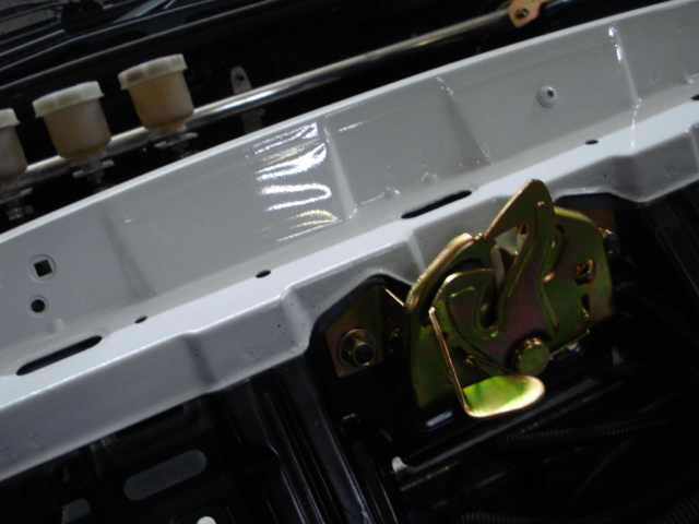

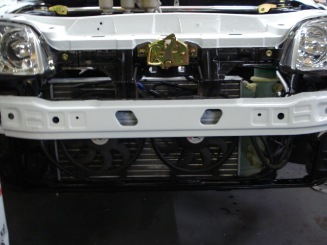

bonnet bumper ... and new active sport grill on way .......... brake air ducts in place of front spots .... air fed right on to front calipers .... get number plate re made ....
front shox are gaz units with 1 degree of camber ... made special by gaz
drilled and grooved discs .... with race spec pads .....
standard anti roll bar ...........
standard rack ... with mk1 punto steering column ..... (no city button on this baby )
two fuel pumps ..... low pressure and high presure .....
