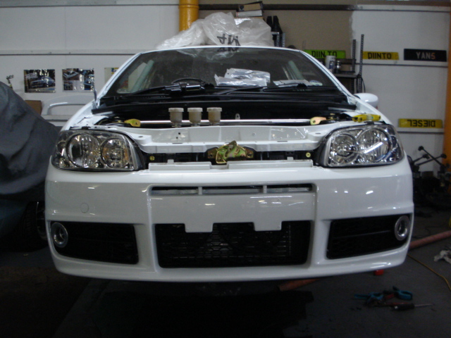

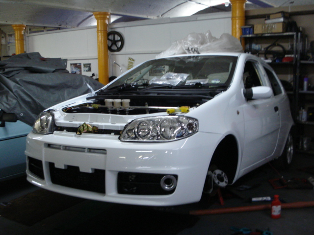

FRONT BUMPER ... NOW WITH FRONT BRAKE DUCTS ...
more air to the front brakes .... dont need driving lamps .... get rid and dont need a switch .(so no lighty make lighter ) paddy mcgunipig is right ... :idea:
looks the dogs now with bumper ........

took o/s n/s lower bumper vent ...... removed some plastic from rear of driving lamp hole and trumpet fitted flush .... then sikaflexed into place ... down to both sides ... and left over night to let set ......
PHOTOS OF TRUMPETS IN PLACE ..........

HERE WE HAVE THE BUMPER FITTED WITH ALL NEW BOLTS AND CLIPS
AND WITH THE TRUMPETS IN PLACE .....
TOMORROW WE WILL FIT THE BRAKE DUCTS INTO THE PLASTIC UNDERGUARDS .... (yes sikoflex again ) then conect them with ducting hose 52mm

thats all for today .......... fitting air ducts next to calipers .... and then getting the super smart bonnet on ... with active sport grill .....
anyone seen a carbon bonnet badge ... may use one
next ..... put wheels on and then for the interior and paint the cage and floor .... (inside ) and have pedals cleaned and polished .. got to remove ... seats dash wiring ... fuse box .... fire extigusher ... polish all alloy parts ....
