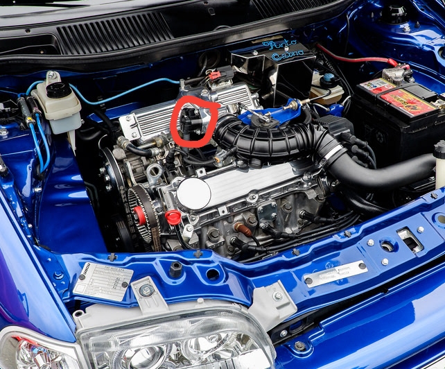

Can you direct me to which sensors are the idle and throttle position sensor (I assume these are different sensors?) ?
Thanks!
Yes
Circulated in red (idle is in front of you, back one is the tps

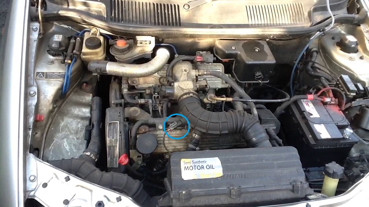

Another thing you can clean with carb spray, is the air sensor. it is located on the air filter body. I've attached picture (circulated in blue).

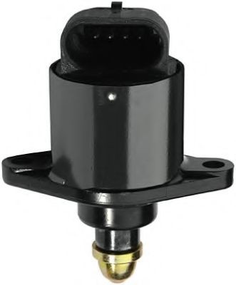

I cleaned the 2 sensors with carb cleaner, as advised. I have a question regarding the idle sensor: if I depress it hard, with my hands, should it move: "go down", or not? I ask, because when tried pressing it, after cleaning, it will not move.
If I buy a new one, would the one of Opel 1.6 be good here, or from the Punto 1.2? As I see it, there are many parts in this car that are Opel or GM. For example
these articles:
https://www.ebay.de/itm/LEERLAUFREG...e=STRK:MEBIDX:IT&_trksid=p2060353.m1438.l2649
https://www.ebay.de/itm/Leerlaufreg...e=STRK:MEBIDX:IT&_trksid=p2060353.m1438.l2649
https://www.ebay.de/p/ERA-Leerlaufr...ung-556045/1768296442?iid=162854290712&chn=ps
These parts look exactly the same as the one in my car.
Thanks!

From what you say, the idle sensor doesn't seem the problem here.
Bad idle sensor would cause the car not to idle correctly.
Try to disconnect it's wire from the sensor first, and check if there's any different.
If you want to replace it, it's part number is: 7778983
you will need to see what are the replacements of it. it's different than the 1.2 sensor, and yes, the tip of it shouldn't move that much when you clean it. it's ok.
