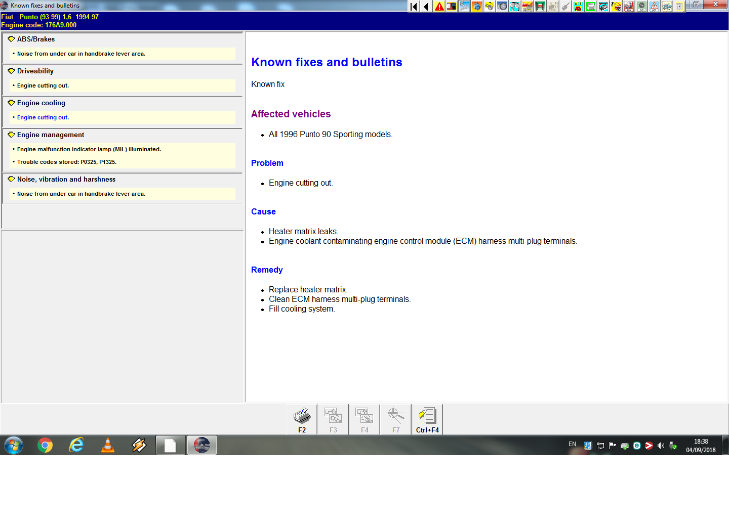

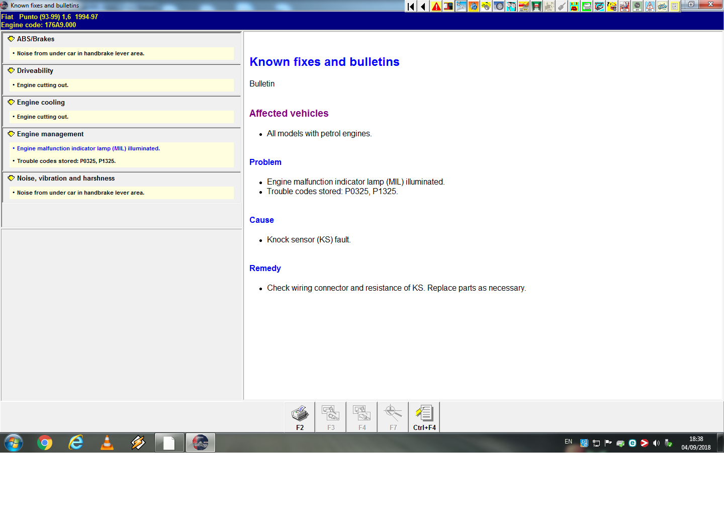

There is a long list of common problems on Autodata, I'll try to take a picture from the program when I get home.
Other than that, I always prefer changing 20 years old sensors to new ones (it cost peanuts on ebay).
Other than that, always prefer changing 20 years old sensors to new ones (it cost peanuts on ebay).

Known issues according Autodata
