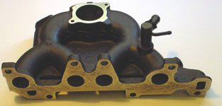

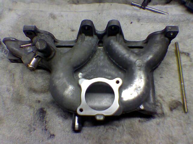

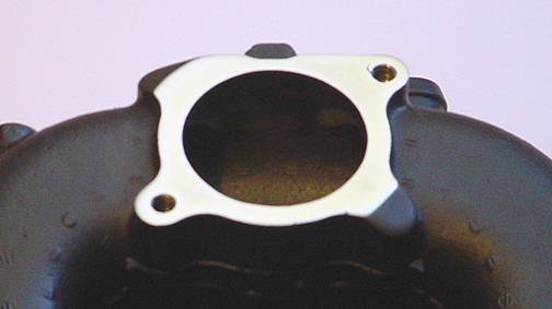

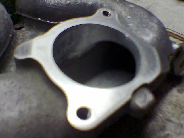

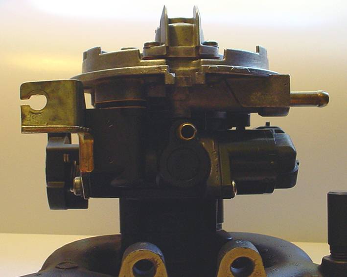

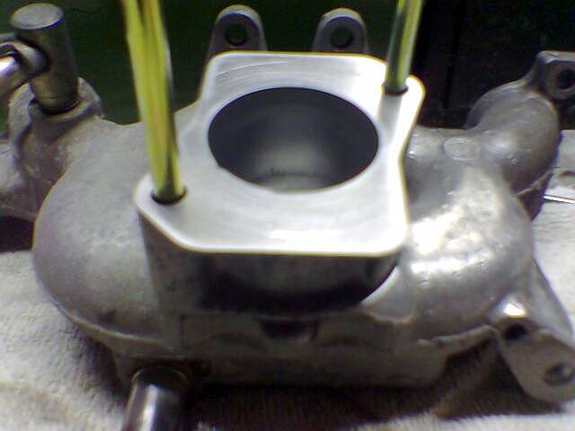

The 1st picture shows the inlet manifold, and the 2nd a close up of the enlarged inlet hole, (now at about 42mm instead of the normal 40mm).

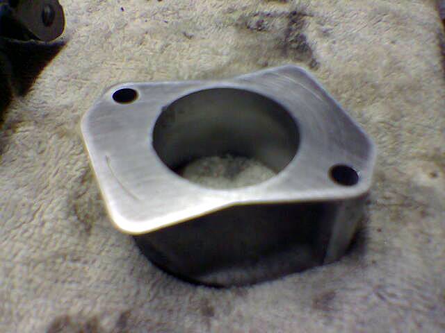

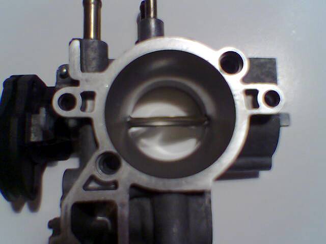

The 3rd picture shows the mating face that goes onto the inlet manifold.
Because the Punto 75 spacer was 10mm taller than the standard Cinq one both the top and bottom surfaces had to be machined down.

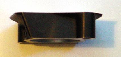

The 4th picture shows the side profile of the machined Punto 75 spacer.

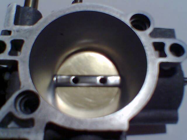

The 5th picture shows the top mating face that mates onto the underside of the throttle body.

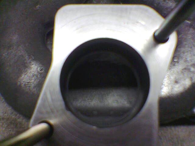

The 6th and 7th pictures show the Punto 75 spacer on the inlet manifold, it isn't very clear but the 7th picture shows there is no longer a lip on the inlet manifold as it has been enlarged by 1mm all the way round.

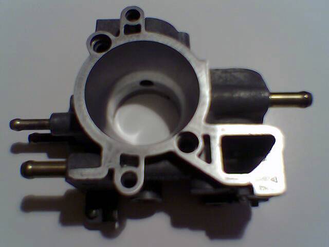

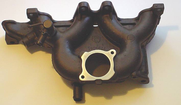

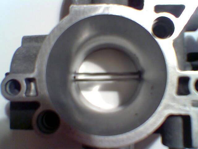

The 8th, 9th, 10th and 11th pictures show the machined Punto 75 throttle body, so that it will fit the top part of the Cinq throttle body (containing the injector). Picture 10 shows the machined throttle body sitting on-top of the spacer.
The 12th picture shows the gas flowed shaft in place.
And finally pictures 13 and 14 show the gas flowed butterfly in place.

Today I took my modified inlet manifold to the local powder coaters and got them to blast it, and I also dropped off my smoothed Cam cover so they could Powder Coat that.
The lad blasted my inlet manifold while I waited, and it's looking really good.
Upon returning home I smoothed the inside of the inlet manifold to help aid the air flow as smoothly as possible.
Once that was done I began to spray it with black high temp paint, at the moment its still drying so I haven't got any pictures of it painted, but below is a picture of the inlet manifold as I got it back from being blasted.

because the spacer block on the Punto 75 is made form alloy and is 40mm tall compaired to the standard Cinq spacer of just 20mm tall, it would mean the whole of the TB and airbox would sit 20mm taller and not allow me to shut my bonnet :(
When I got the rest of the TB machined I had 10mm taken off the spacer as this was really as much as could realistically be taken off, however this isn't enough. I'm going to have to go and get another 10mm taken off it and hopefully this won't effect the strength of the spacer itself.

Looking at the side profile pics of the spacer you have I don't think it can be reduced anymore with out a compromise in it's sealing quality's. why not just get a new spacer made up from a blank piece of aluminium, this is what Tricker does on his 40mm TB and its very good and seals very nicely.

Those of you following this thread will remember I had a slight problem with the spacer being 10mm or so too tall, meaning I was unlikely to get my bonnet closed as I've also got a Novitec Carbon Fibre Airbox fitted.
However this problem has since been resolved, by taking it back to "Black Peter" (my dad's mate) and getting the extra 10mm machined off. Its now exactly 20mm (the same thickness as the standard Cinq spacer), which is about half of its original height. Meaning the Punto 75 throttle body will sit in exactly the same place as the original, allowing me to close my bonnet, (which is always a good thing I've been told :) ).
Pictures 1,2 and 3 show the top, underside and side profile of the newly machined spacer.

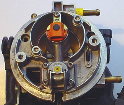

We'll start with the top part of the throttle body (this is the part that contains the injector), I got this part from Brickfoot (thanks mate(y) ) as he didn't need it seeing as he’s now sold his Cinq. However seeing as I’d be doing work on the rest of the throttle body and the inlet manifold I couldn't just leave this standard.
From the factory the chamber that funnels the air to the butterfly and the housing that holds the injector has a number of mould lines running along it. These mould lines disturb the flow of air going to the butterfly, so to start with I simply filed these away until the chamber and injector housing were nice and smooth. I then used various grades of wet and dry to increase the size of the chamber funnelling air to the butterfly, and smooth off the entire surface to allow the air to flow as quickly and smoothly as possible.
The next step was the Punto 75 butterfly part of the throttle body. Here the butterfly shaft was filed down and then wet and dry used to smooth it even more. The butterfly was also given a knife edge on either side, this again would allow air to flow as smoothly as possible. The main job however was to get the 38mm butterfly housing machined down so that it would mate up with the top half of the 1108 / 1242 throttle body.
My dad's mate "Black Peter" machined this down for me, so that the opening at the top of the butterfly housing matched perfectly with the underside of the injector part of the throttle body. The assembled Punto 75 throttle body can be seen in picture 4. From this picture you can see just how close to the bolt holes the machining was.
Picture 5 shows a side profile of the throttle body, this shows how smooth the throat leading to the butterfly is, again this was gone over with wet and dry after the machining had been done to get rid of any of the cut lines the lathe left
Picture 6 shows the underside of the throttle body. In this picture you can clearly see the profiled butterfly shaft as well as the cut down butterfly screws. This was all done to aid in air flow.
Picture 7 and 8 shows the back and front of the flowed inlet manifold after it had been bead blasted and painted with high temp exhaust paint.
Picture 9 clearly shows the modified mating face to accept the Punto 75 spacer. Because the Punto spacer block increases in diameter from 38mm to around 42mm, the inlet hole on the manifold had to be increased in size to ensure there was no lip restricting the air flow.
However because the Punto spacer has been machined down the diameter of the final opening was reduced and for this reason the inlet manifold opening only needed to be increased by about 1mm
The inside of the standard manifold is quite rough, so seeing as I had spent all this time working on making the air flow as smoothly as possible while in the throttle body I thought I might as well take the time to make sure the air flows as smoothly while in the inlet manifold.
Placing my finger inside the inlet hole on the manifold I was surprise to feel quite a noticeable lip :eek: . In no time at all I'd decided that this lip was coming off so I broke out the Dremel and equipped with sanding drum.
After spending a couple of minutes with the Dremel I then used some sand paper and worked my way as far into the inlet manifold as I could, the end result was that the lip had been completely removed and was replaced with a nice smooth radius that the air and fuel mixture would flow over smoothly.
