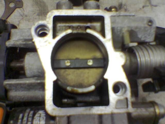

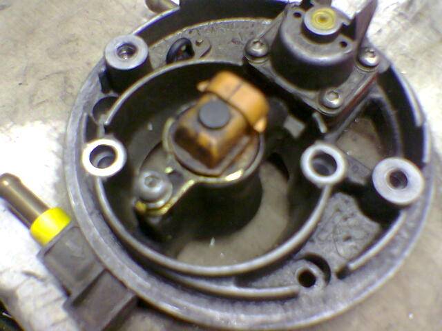

Ok having seen the post a little while ago (See link below)
https://www.fiatforum.com/showthread.php?t=8481&highlight=38mm
I've decided to bite the bullet as it were and purchase myself a Punto 75 Throttle body.
Now as many people on here will tell you it isn't a direct swop for my Cinq.
For a start the Punto 75 is a MPI engine, so the top part of the throttle body doesn't have the injector or anything on it, so the top part of either a Cinq, Sei or Punto 55/60 throttle body is required.
Lucky thanks to a very good mate (Thanks Brickfoot :D) I managed to get hold of an old Cinq 1108 TB. (See "Top Half of 1108 TB.jpg" below:)
I got my Punto 75 throttle body from Ebay and it was delivery to me on Saturday, I took some picture as soon as it arrived and these are shown below.
Thanks to Pete Gas Flowing guide (Thanks Mate :)) I'm in the process of flowing top half of the 1108 TB, the bottom half of the Punto 75 TB. The shaft is also going to get a good flowing (uh ur misses), as well as the butterfly. I'm going to get my dad's friend to turn down the alloy spacer block so it isn't quite as tall, as well as flow the spare inlet manifold I have and bore out the inlet hole so that it matches the Punto 75 Alloy spacer block.
I know its going to be quite a bit work to get all of this done, but I think it will definatley be worth it, and I should definitley gain a couple of extra bhp ready for York ;)
I'll keep this thread updated with the progress of my work.
Wish me luck, I hope I can get it all sorted.

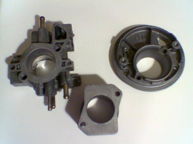

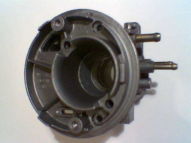

Ok here's today's update.
Having fully stripped the Punto 75 throttle body I've cleaned every single part in the parts washer, so their all nice and shiney :D
The first three pictures show the main parts of the throttle body, (the top part of the throttle body won't be used, but I thought I'd include it anyway).
I've gas flowed the shaft of the throttle body and I must admit although it took me the best part of 3 hours :(, I'm REALLY pleased with the end result.
I started shaping the shaft with a small file to get the rough profile I wanted, then I used a sponge sanding block to get rid of any of the scratch's the file had left.
After the sponge sanding block I used some 300 grade wet and dry, and then moved onto some 600 grade and finally 1200 grade. After I had done that I got out the Dremel and used one of the polishing pads with some rubbing compound to finish off the shaft and give it a supper smooth finish.
I then moved onto the butterfly. Putting the shaft back into the throttle body and re-inserting the butterfly I could see exactly which parts of the butterfly made the seal. I then marked the reverse sides of the butterfly that didn't make the seal so that I knew exactly which parts of the butterfly I could smooth.
Although the pictures are great (Ok there pretty bad I know), you can just about see the smooth edge of the butterfly. If you don't really know what I mean, the edge profile of the butterfly was very similar to that of a 2p piece.
But it now is smoothed into a thin knife edge to help aid in the flow then the throttle is open :)
Let me know what you think, and I'll keep you updated with further progress reports.
Brian
