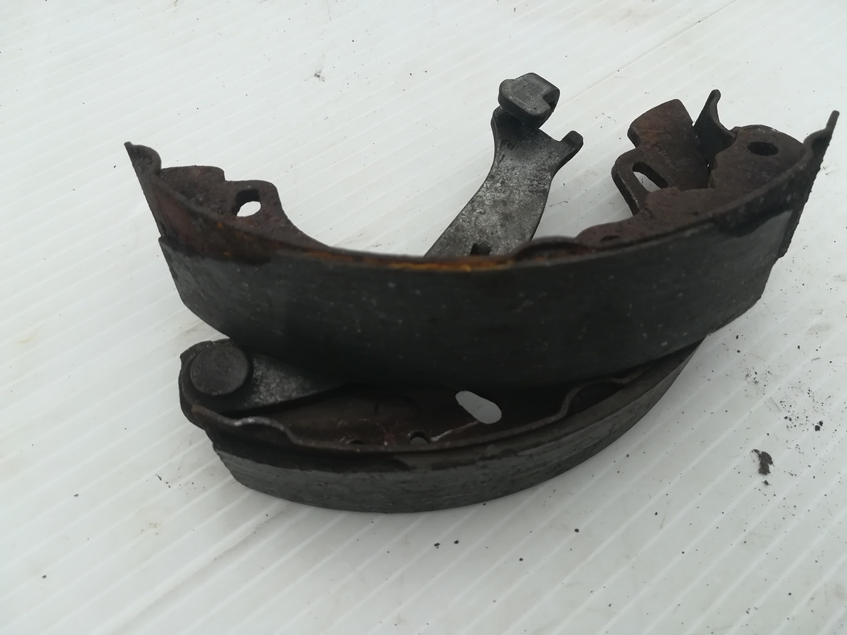

New rear shoes...not a moment too soon *ahem*
One piston had got stuck in the wheel cylinder. It was only a few years old so I stripped the cylinder and cleaned it.
New drums and shocks, and yearly smear in grease and oil of the rear axle
