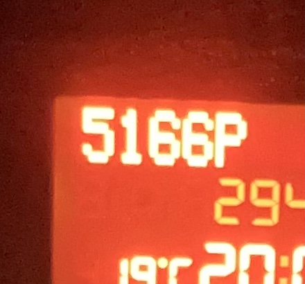

Attached below is what I get under the IMAGE ID option.
Please note @Farrah that I bought the car on the understanding that the B&M unit wasn’t working and I assumed (rightly or wrongly?) that the flashing odometer was due to the old failed unit. I replaced the old B&M unit with one of identical part number reclaimed from a Fiat 500. The new B&M unit works perfectly on all functions with my smartphone connected via the USB port. The only issue is the flashing odometer - a minor irritation.
The odometer gives a steady display for 10 seconds after opening or closing the door, after which it switches off (at the same time as the cabin lights) UNLESS the key is turned to MAR, after which it holds steady for 4 seconds, moving to flash mode when the warning lights turn off.

Hi,
I will try my best to make a bit of sense of the problems but given Fiat dealers seem very sparse of knowldge on the blueme modules and what can be done most of what we have learnt now has been hands on......
First of all you need to understand ECU modules and part numbers from a manufacturers point of logistics......it would be impossible (well logistically a nightmare) for a company to stock ECU modules for every variant of car to be specified by a dealer for the cars 'build card'.....the storemen would have a mammoth task as everyone of the modules would look excactly the same......possibly a little easier today with bar code reading machines but impossible to have separate bins on the shelf for every internal differences a car may be optioned for in specs.
So what happens is the module will carry a basic generic part number all identical all with the same part number.....the car will then get built and at some point normally the end of line there is a section in the UK we called VCATS.........here the car gets plugged into the assembly line computer system and all the features are programmed into the car ie make, radio codes etc etc, not just for what would be the blue and me module but also for the body ECU processor.......
So the problem is the blueme module will not likely be factory programmed to suit a Qubo but a 500....there is specific items identified in a B&M module as it picks up information that interacts even with the tomtom sat nav giving the cars image which then appears on the tomtom screen....that said I would not guarantee a 500 to 500 would necessarily work but it does appear I have read owners have done it with success with modules from the same car........you cannot really equate the factory programming of modules to what can be done or needs to be done on the retail market.
I would expect a main dealer may be able to reprogramme a module or possibly delete the factory part of the programming but it could be that even when they have to replace a failed unit they have to give Fiat the vin number who will have stored all the relavant LINE BUILD data then supply a bespoke module again for the vehicle at point of dispatch based on what was factory programmed.........
I would expect this maybe why the electronics is identifying something is wrong with the flashing ODO but still allows the blueme functions to work............that said you may have nothing wrong with the original module and you have been given wrong information..........my flashing ODO was caused but the sotp/start battery so what evidence is available that identifies the BM module as the cause of the flashing ODO if as you say all the BM features are working.......
