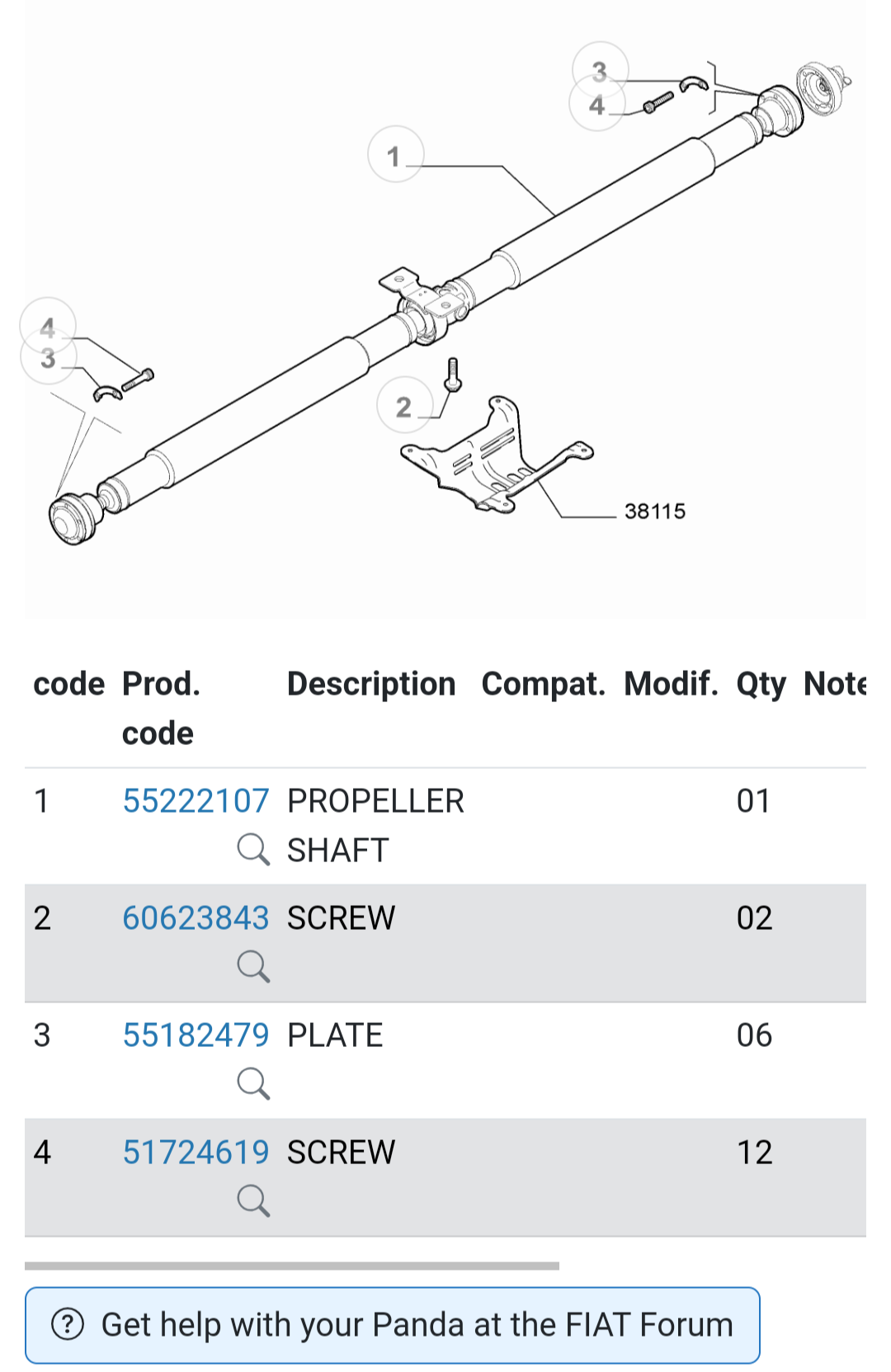

Looking if anyone can help in confirming this will fit
Panda cross 2015 diesel
NL65 UBS
And can i run it in 2 wheel drive while waiting fix?
Answers appreciated

As far as I know there's only propshaft for all models
Yes they work in two wheel drive
Normally it's the centre bearing that goes, it's cheap and replaceable

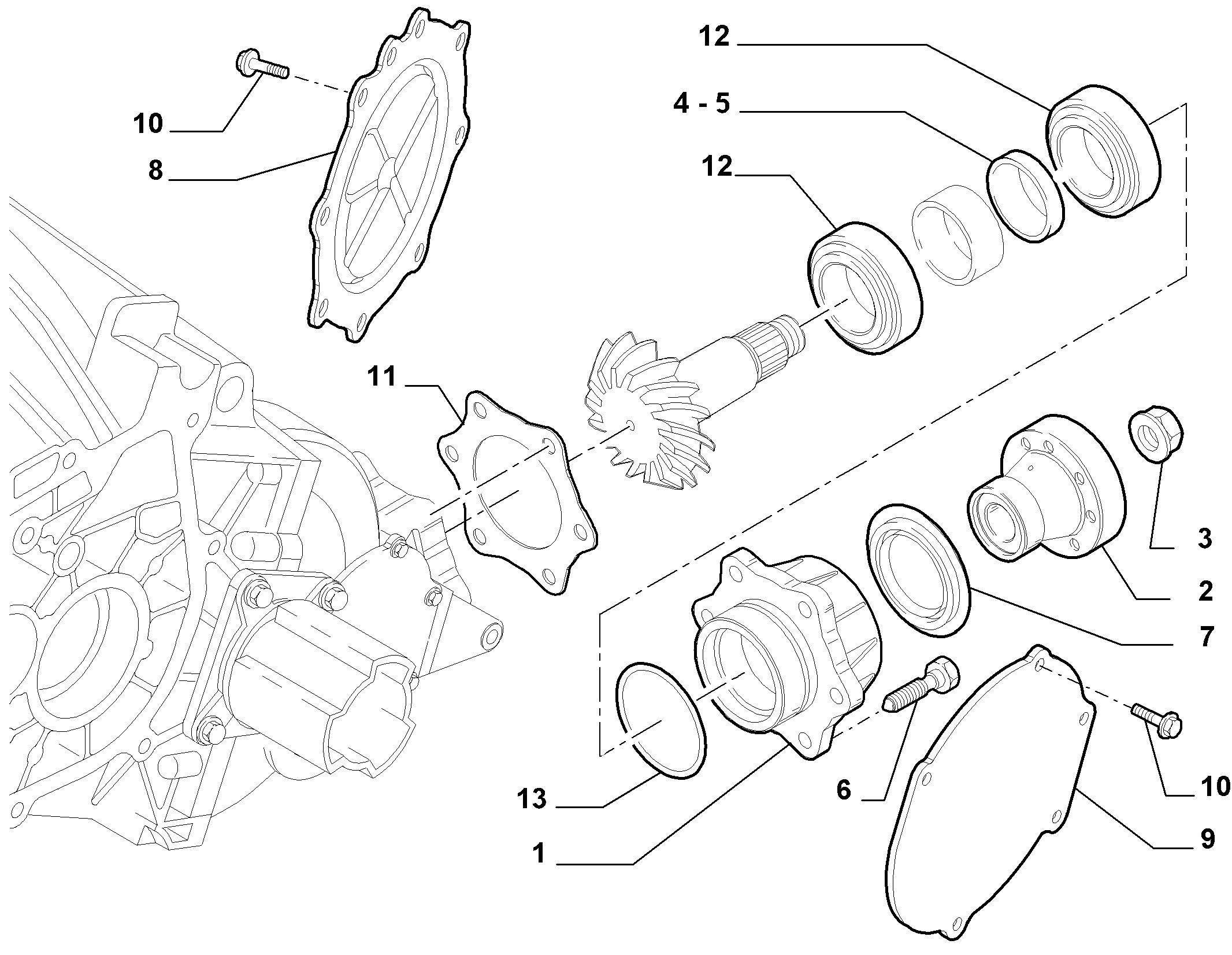

There is no transfer box. The prop shaft has a pinion off the back of the front differential ring gear. That drives a fluid coupling on the end of the prop shaft. Rear gearbox is just a differential. Take a look on ePER. https://eper.fiatforum.com/
Shaft
Gearbox showing 4x4 rear drive pinion but no sign of the fluid coupling.
Shaft
No viscose coupling fiat stopped using them in 2007
