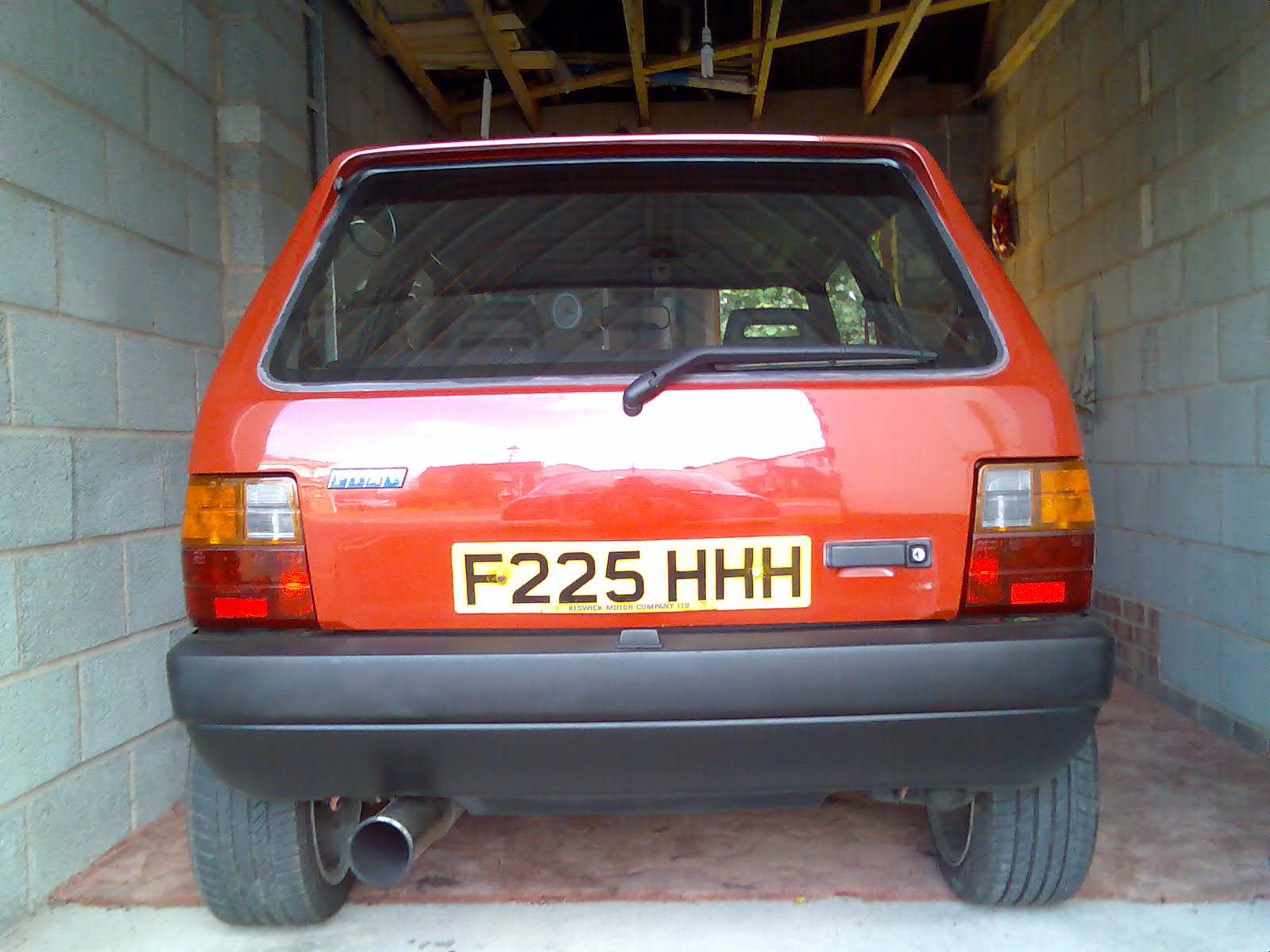

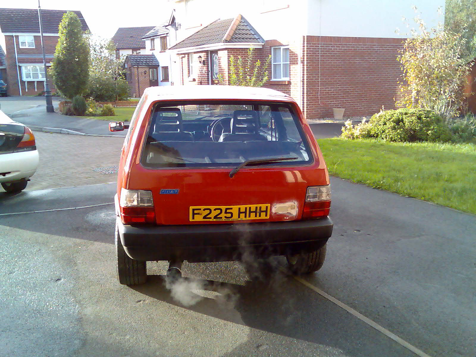

Here we go all washed and fitted on the car... what do ya think (y)
You can see the orangey colour contrasted by the lights' red. Keep the bumpers grey, but yeah, Mk2 bumper and lowering by quite a bit and it's really getting there!!
F R O S T Y said:
That looks MINTED Rob (y) I think you should get a mark 2 rear bumper and slam it on its ass!!!!!! But still love it the way it is mate!
ps is that a punto wiper arm on there??
:cool: F R O $ T Y
Yep i will do mate im on the look out for a mk2 rear bumper at the mo...
And yeah it's a punto rear wiper arm, im just in the middle of some de locking at the mo, will post more later..:D

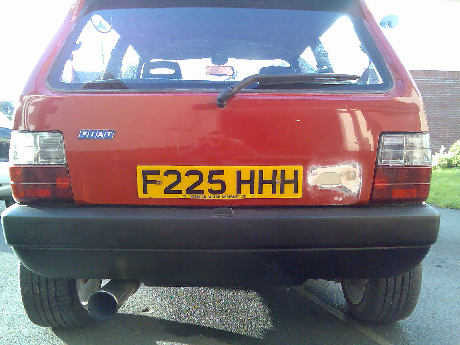

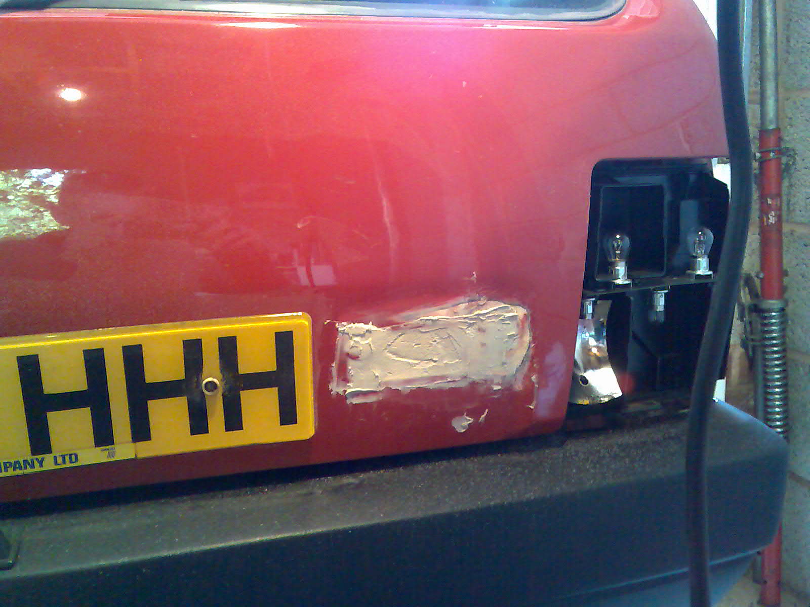

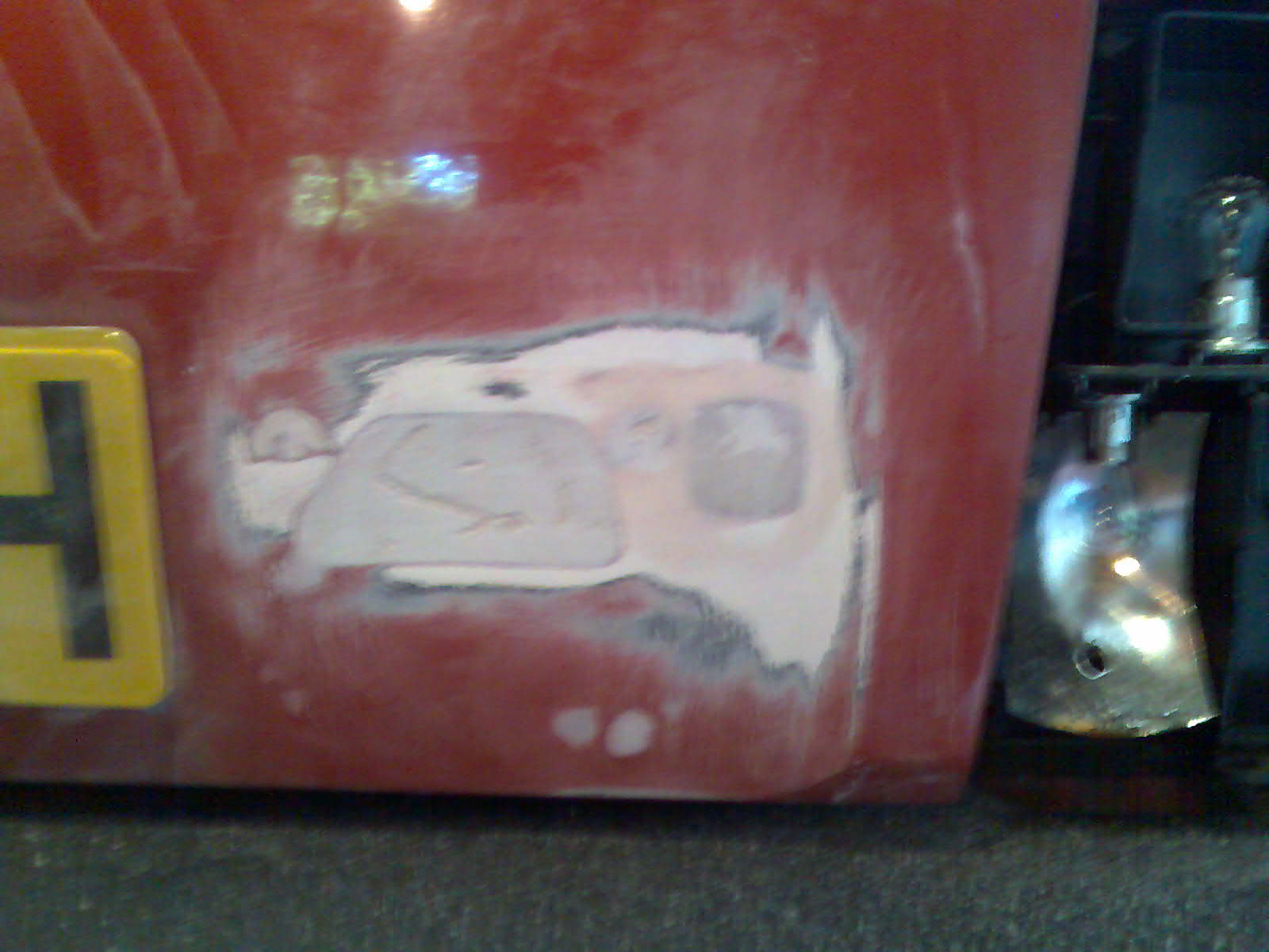

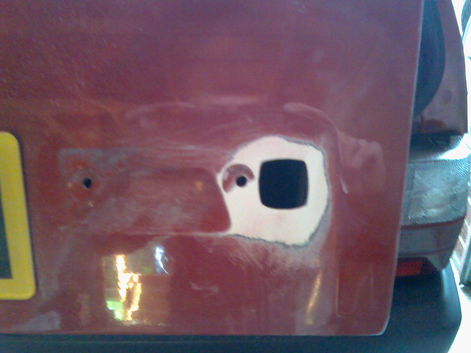

Been real busy again today, my lights are fitted as you all most prob already know and i've also been busy removing the rear boot lock and handle, really simple to do.
The hardest bit is trying to get the filler complety flat which took me several light coat's of filler and alot of sanding down.
As you can see from the first pic when the lock is removed there's a little ledge that sit's higher up so i sanded this down flat first then cut a plastic square out of thick plastic and held the on the back of the boot then using some fibreglass i filled the whole up, note i only used a tiny bit of fibreglass to get a smooth affect, then finished it off with several layers of thin filler...
It's almost there i think tomoz ill try one more thin smear then it shud be job done, ill lightly spray it in primer then the body shop will do the final preps if needed.

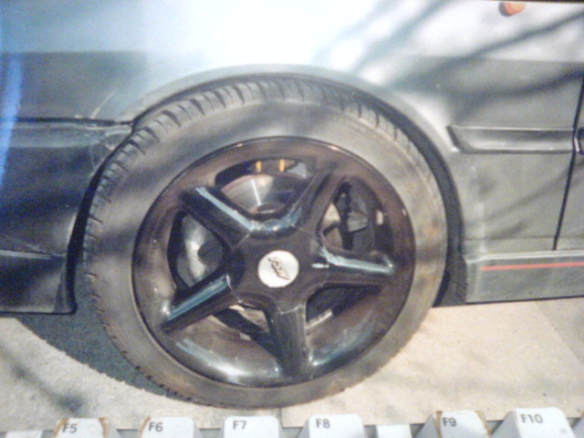

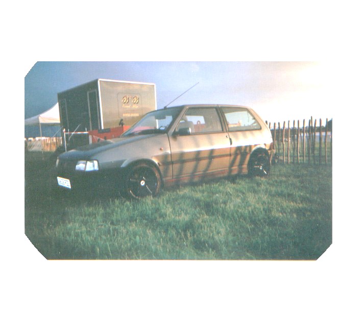

Also is a pic of the one black wheel on the car i totaly hate them black, so as you can see i have been slowly been gettin it off with thinners but it takes ages..... A couple of you wanted to see them black so here it is..

Dunc Uno Turbo said:
looking awesome mate! i love the black wheels on ur car! think they lok hard core!
Dunc
I told him to go black but dont think he's having any of it...
I dunno chap's maybe if they where a nice glossy black then they might look ok but i like the silver alot ??:rolleyes:
And about them plates i've got some gb ones a pair infact but i don't wanna fit them untill she's been painted...(y)
