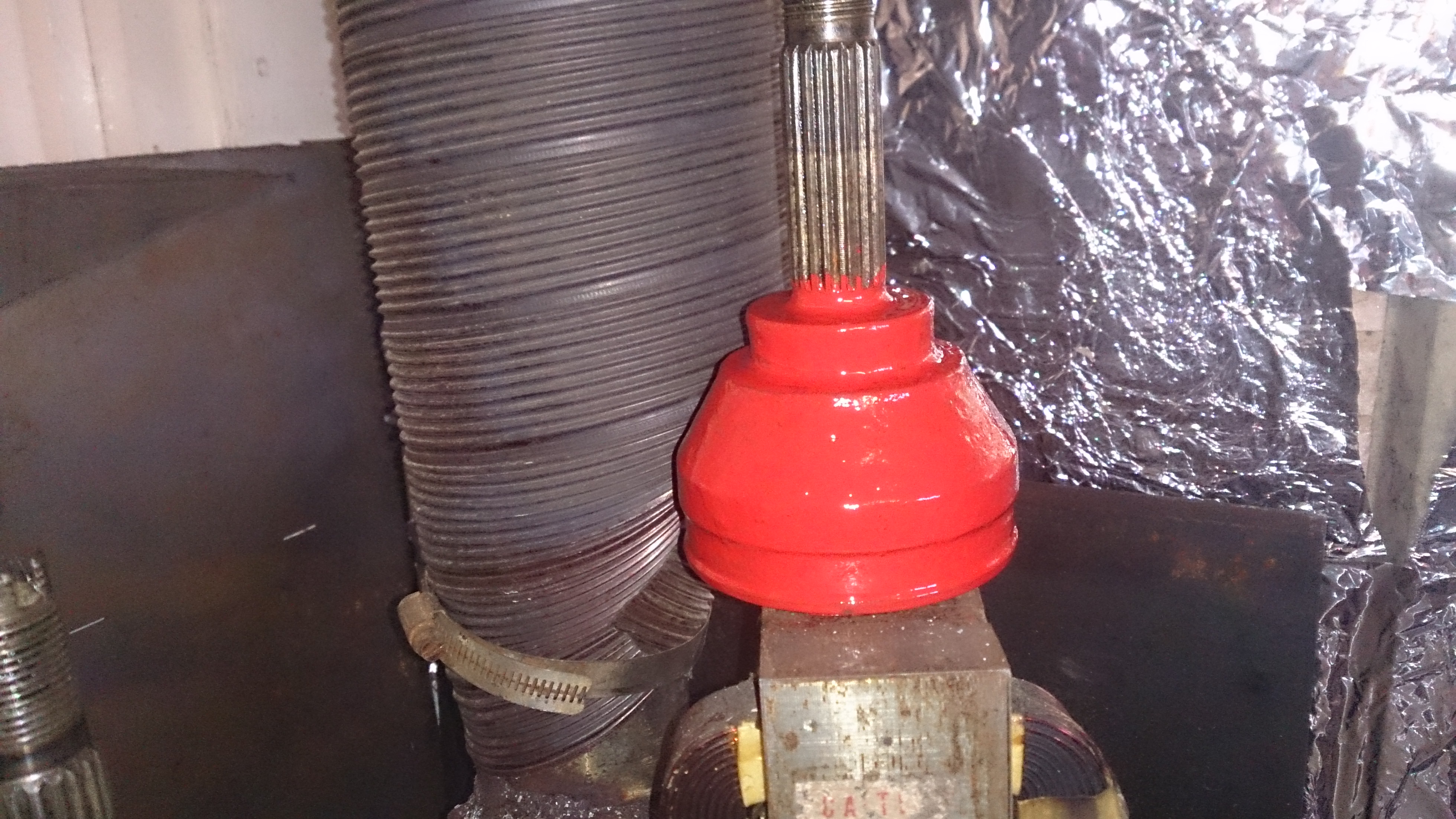

the CV joint was really badly pitted inside where the ball bearings slide around. so i replaced it with one from off bex (its in really good condition, no pitting and no ware!)

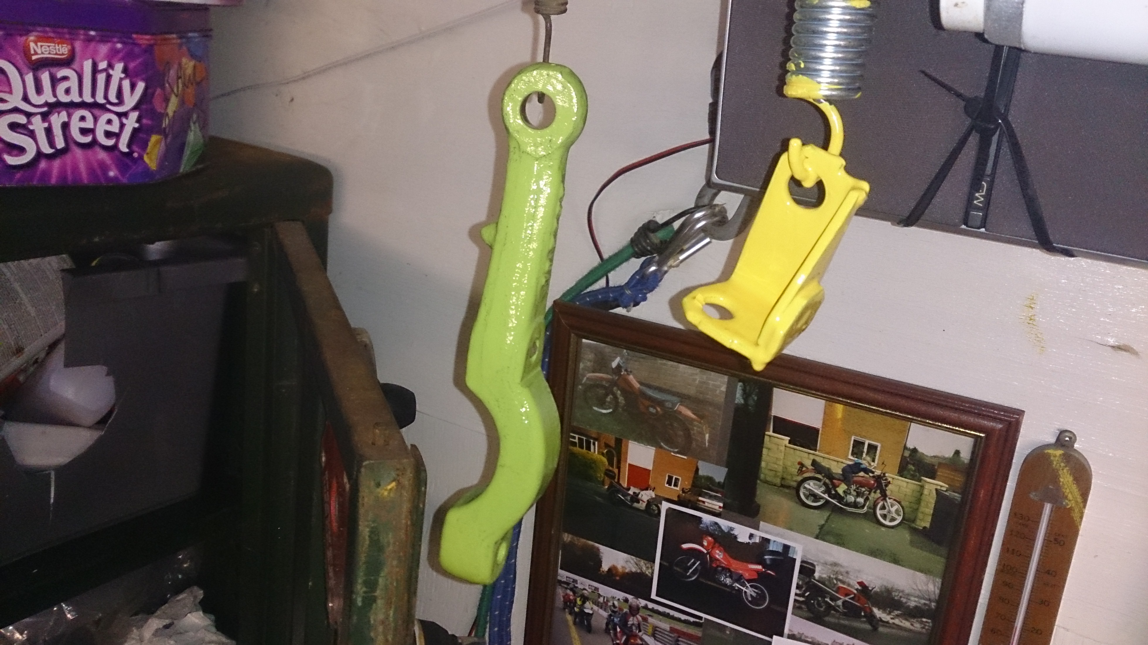

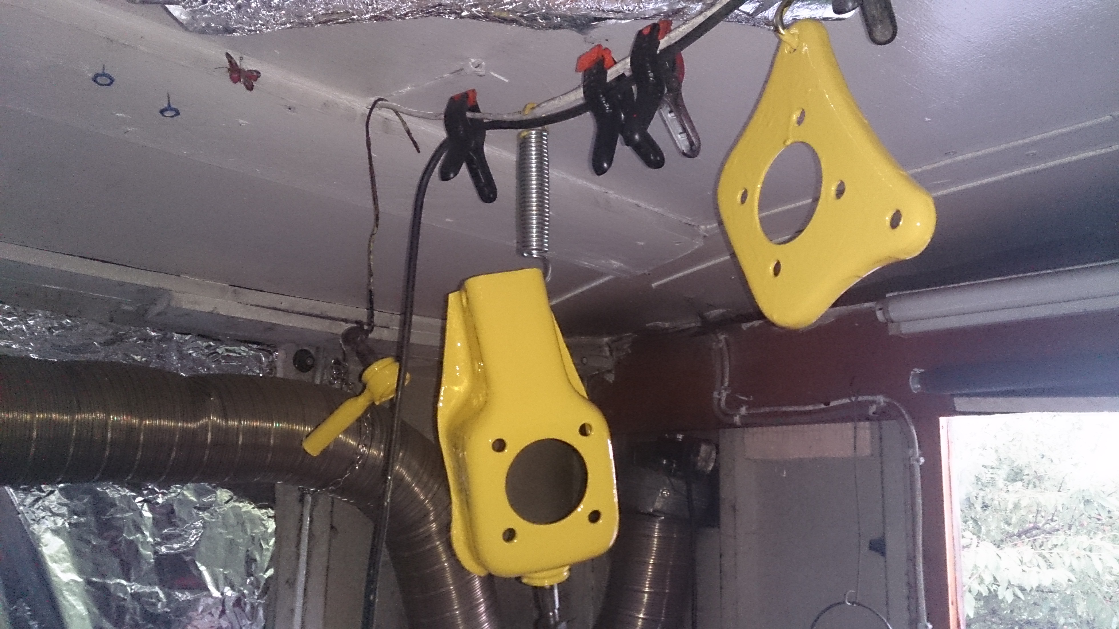

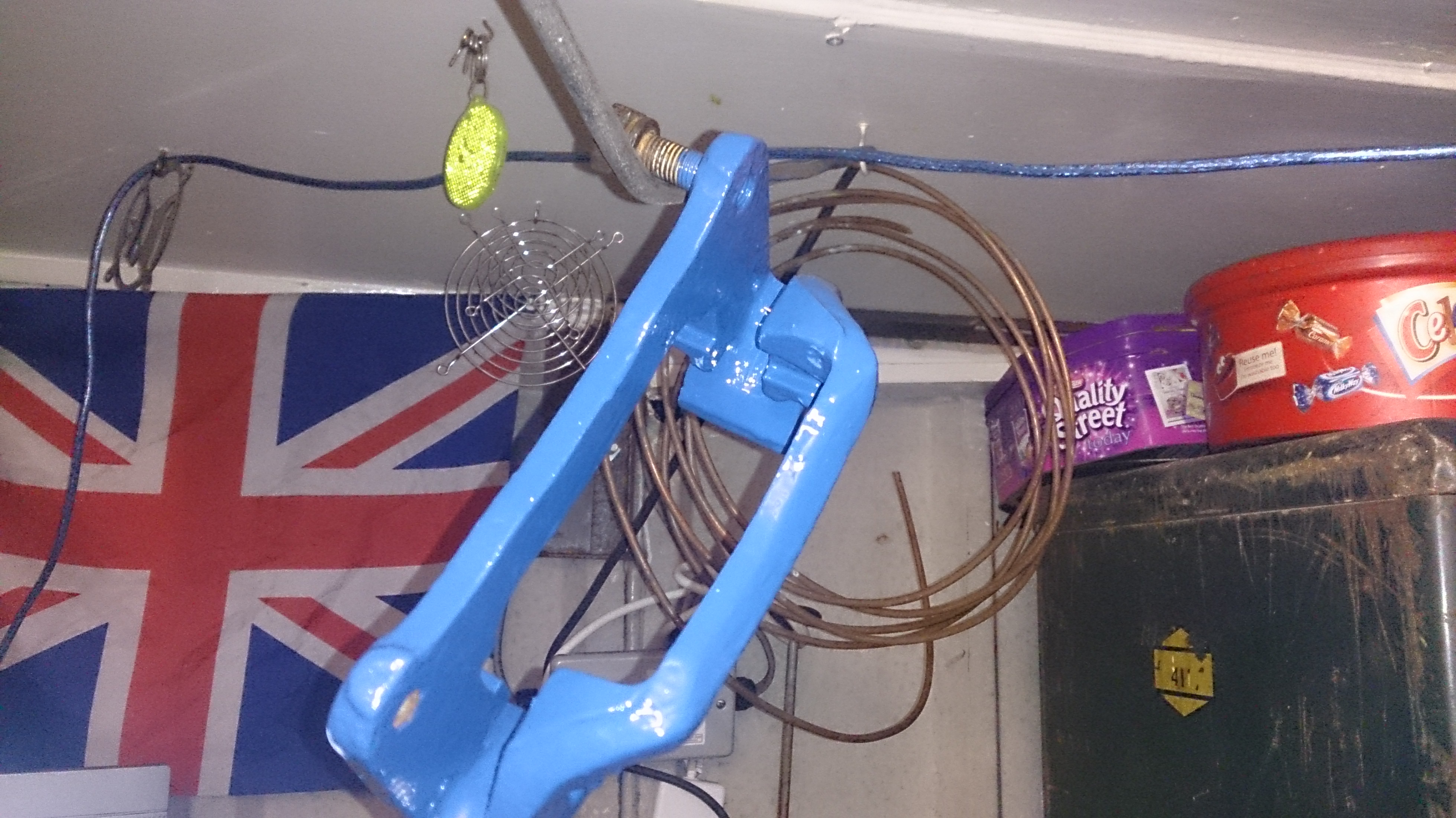

now its time for the painted stuff
yes that is me on the bike in the picture, in front of our house.. spot the difference between then and now with the picture in my sig...
drive axle has also been painted but i forgot to take a picture of that...
hope you all like so far!
You and this crazy colours John :D I preffer shades of gray and black when restoring parts, but the point is to give good antirust protection, and some aesthetic touch right? the colours are personal prefference. Nice progress with the "Wasteland Rover" mate(y)

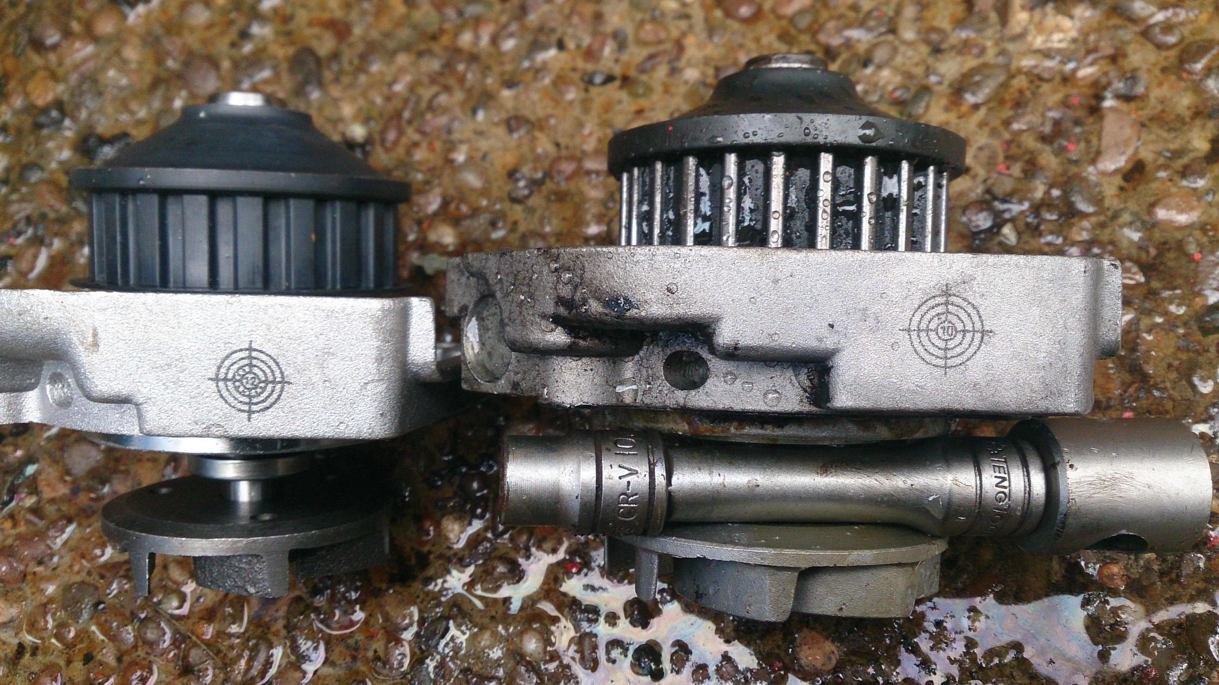

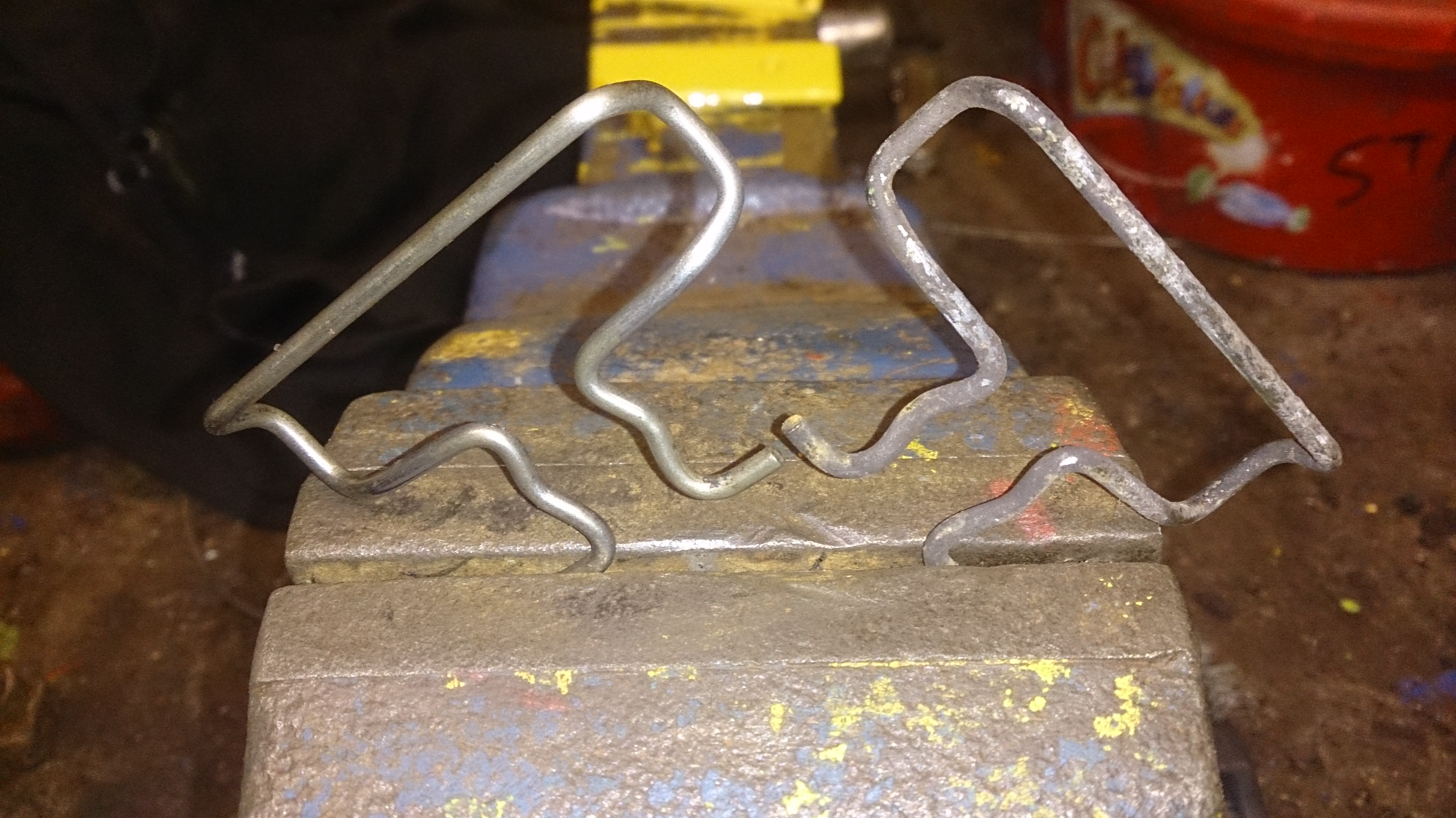

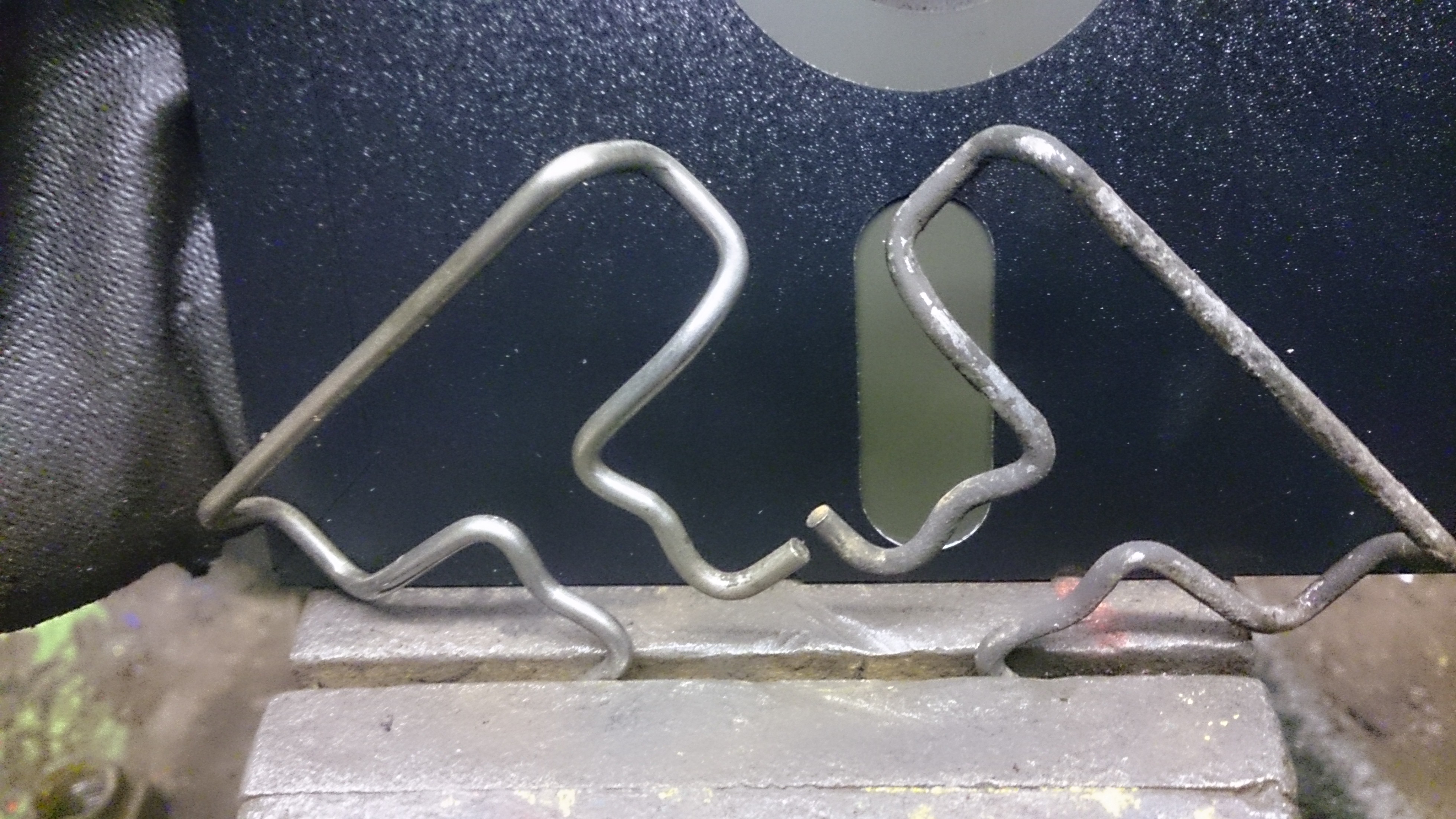

ok, so i found out why the timing belt was so gnarled.
spot whats wrong...
didnt see it? look at the cam shaft pulley, and water pump pulley. the teeth are different!

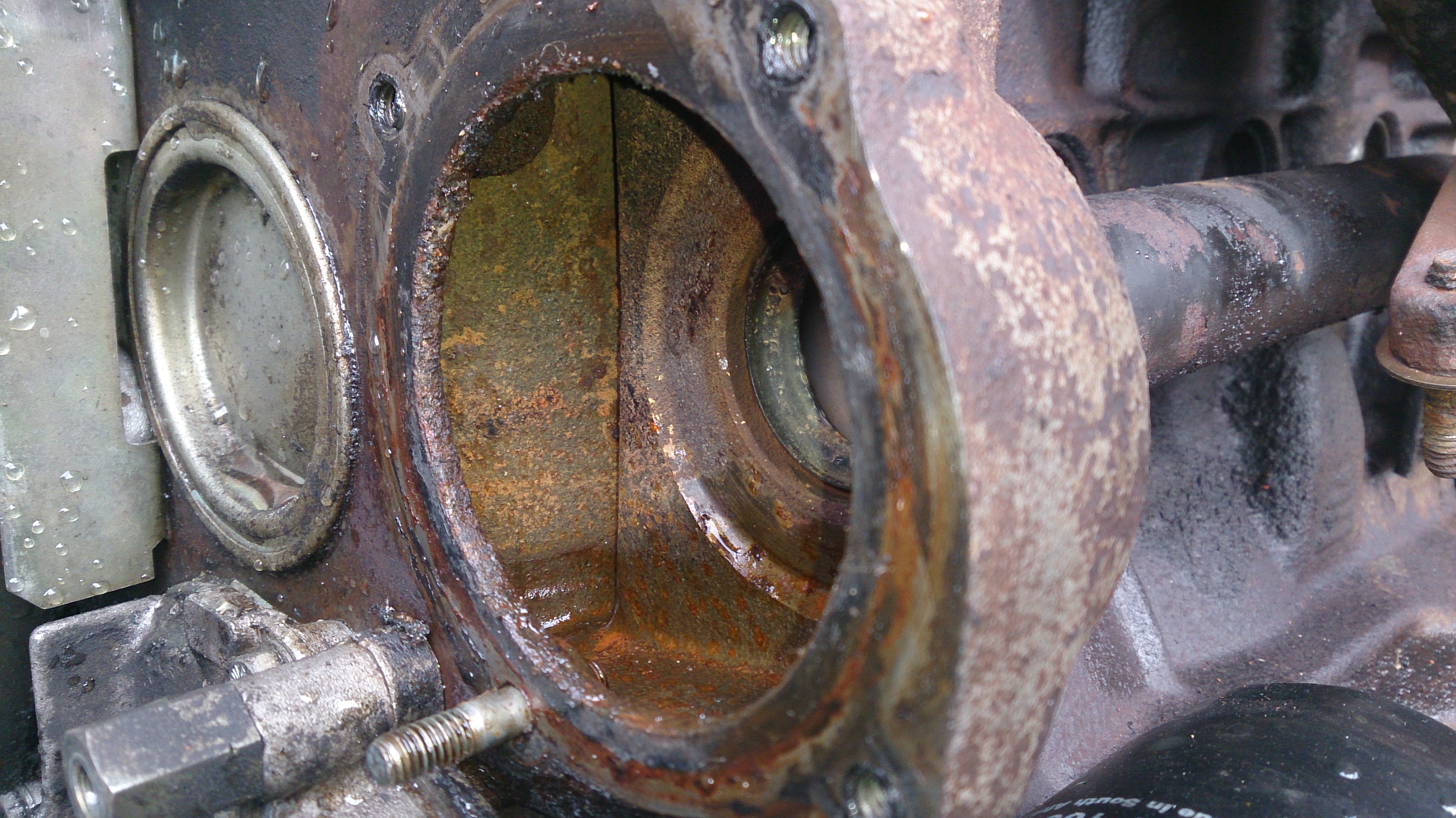

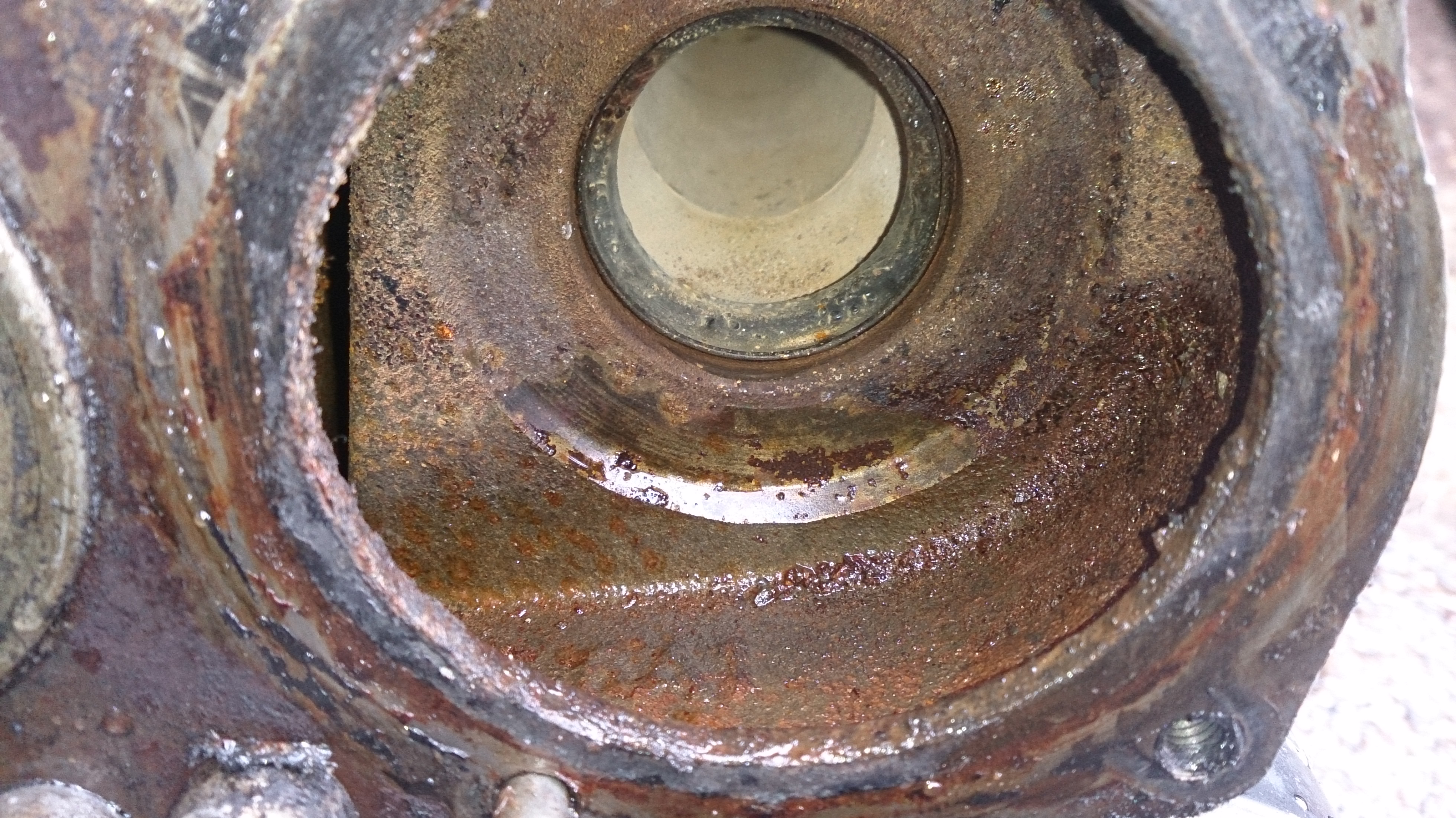

thankfully i had a spare brand new water pump.
lets have a look at that water jacket...
that looks nice and clean in there!!
no gasket? i make my own...
now we have matching pulleys!
all that with that belt and the water pump that had a January 2010 date stamp.. been running around for 4 years on that timing belt and never lost its timing. that is impressive!

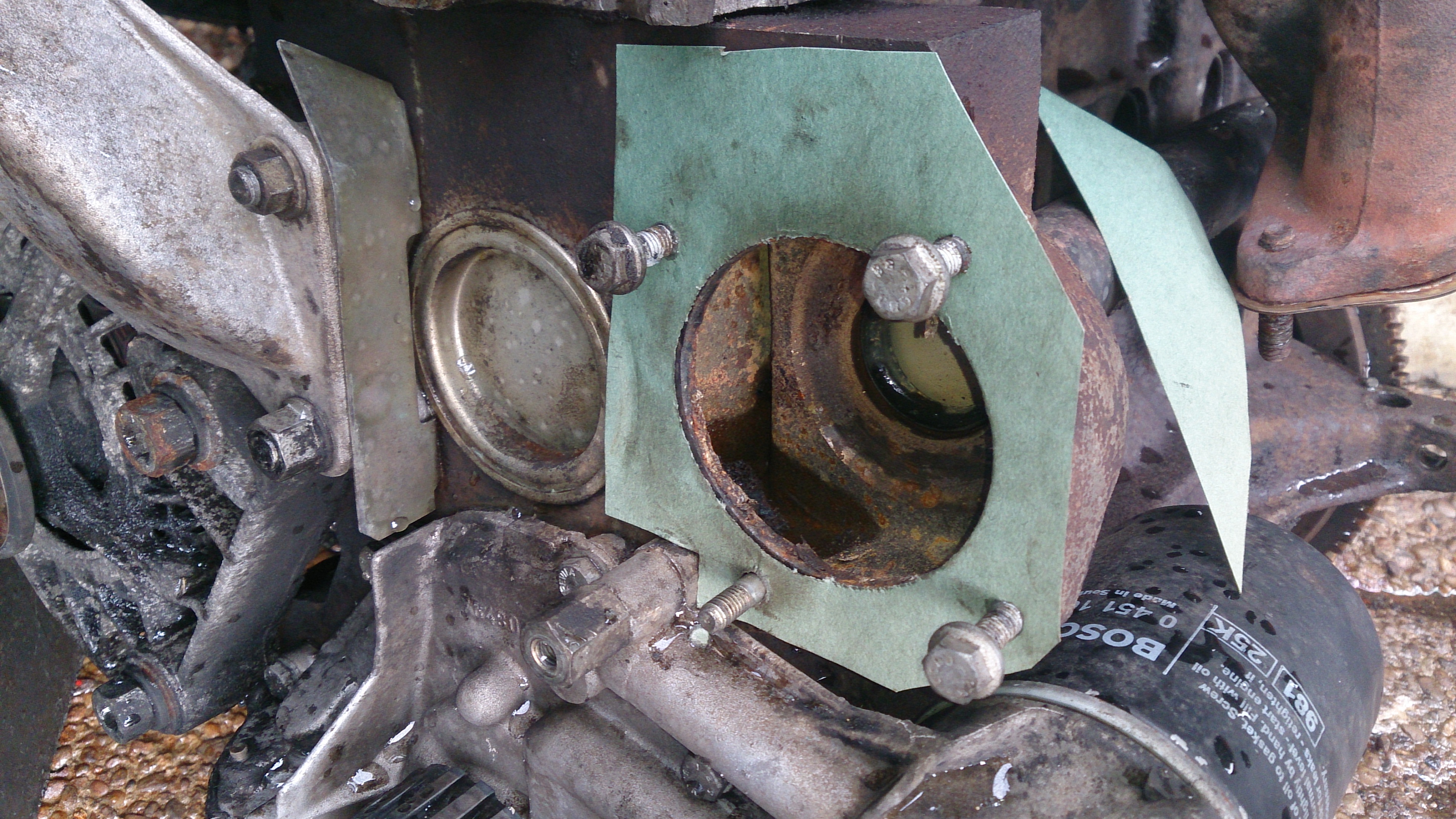

well timing belt has been fit. i have also painted the engine block black. and some of the sump.. ill paint the rest when it is in the car.
core plugs all look good. one of them was starting to rust, a bit of paint should stop that in its tracks.
yes i think this engine will be fine once i have dealt with the immobiliser. however i am going to do that :/
