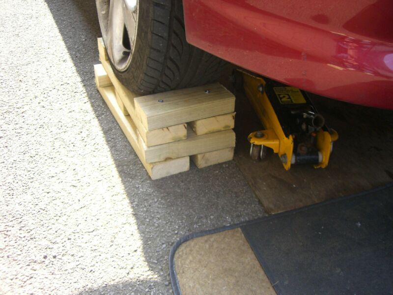

The sections are bolted together in the right places but it does look like a big puzzle. You can take it 3", 6", 9" or 12" up in to the air and it all fits nicely in the boot. Handy for when you haven't got power to drive onto a car ramp or you need to get under the front and the back of the car at the same time
Steel car ramps are expensive, heavy, a job to drive onto and still unsteady whereas these are light and can be used anywhere

dont think i have enough time; or willingness to build myself some of those bad boy car stands. i will make some up for myself soon though.

You need to tighten the bolts throught the bushes with the car on the ground as normal. If you don't have axle stands (or big Jenga blocks) you'll need to crawl under the car somehow to do it.

Can't believe you've taken the axle out and don't have axle stands.

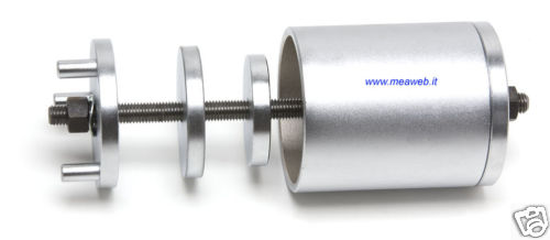

yeah its sitting on axle stands atm, how could i use those to get the correct angle for the axle?? sorry for all the annoying little questions....i used up all my brain power on my press tool!!!
just waiting for my replacement bush to come in for the new one i buggered up putting in at the weekend.

When you refit the axle to the car, tighten everything except the 2 bolts that go through the axle bushes, and the 2 lower shock absorber mounting bolts if it's a saloon or all 4 shock absorber mounting bolts if it's a MW.
Lower the rear wheels onto "Jenga" blocks, or the rear brake disc flanges onto axle stands then tighten all the remaining bolts.
