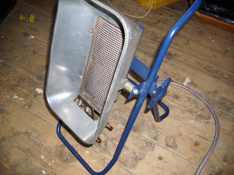

I bought a regulator for it, now before I connect it to the gas bottle I am unsure on how to light it - never had anything likg this before, I will let the pics explain
The first pic is the front of the heater panel, there is a slot in the bottom of it, is this where I light it? [marked with a small A]

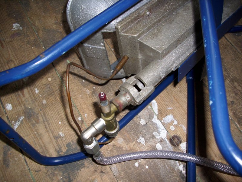

This pic is the back of it, marked B is a push down button, its not an ignition button

OK, its a fairly basic manual ignition device.
Please remove the fuel pipe and get proper orange external grade gas hose.
Button B is a flame failure device. To get the gas to come through to the burner you switch on the gas at the bottle, the gas should not flow.
Press button B, this should allow gas to reach the burner, you will hear a hiss.
Immediately light the gas near the bottom while keeping your finger on button B.
Once the burner has lit, keep finger on button B for 15 seconds or so.
The copper pipe type thing going to the burner is a thermocouple. The application of heat on the tip of the thermocouple produces a small magnetic charge at the other end to hold the gas valve open.
The heater should now stay lit until you turn the gas off.
