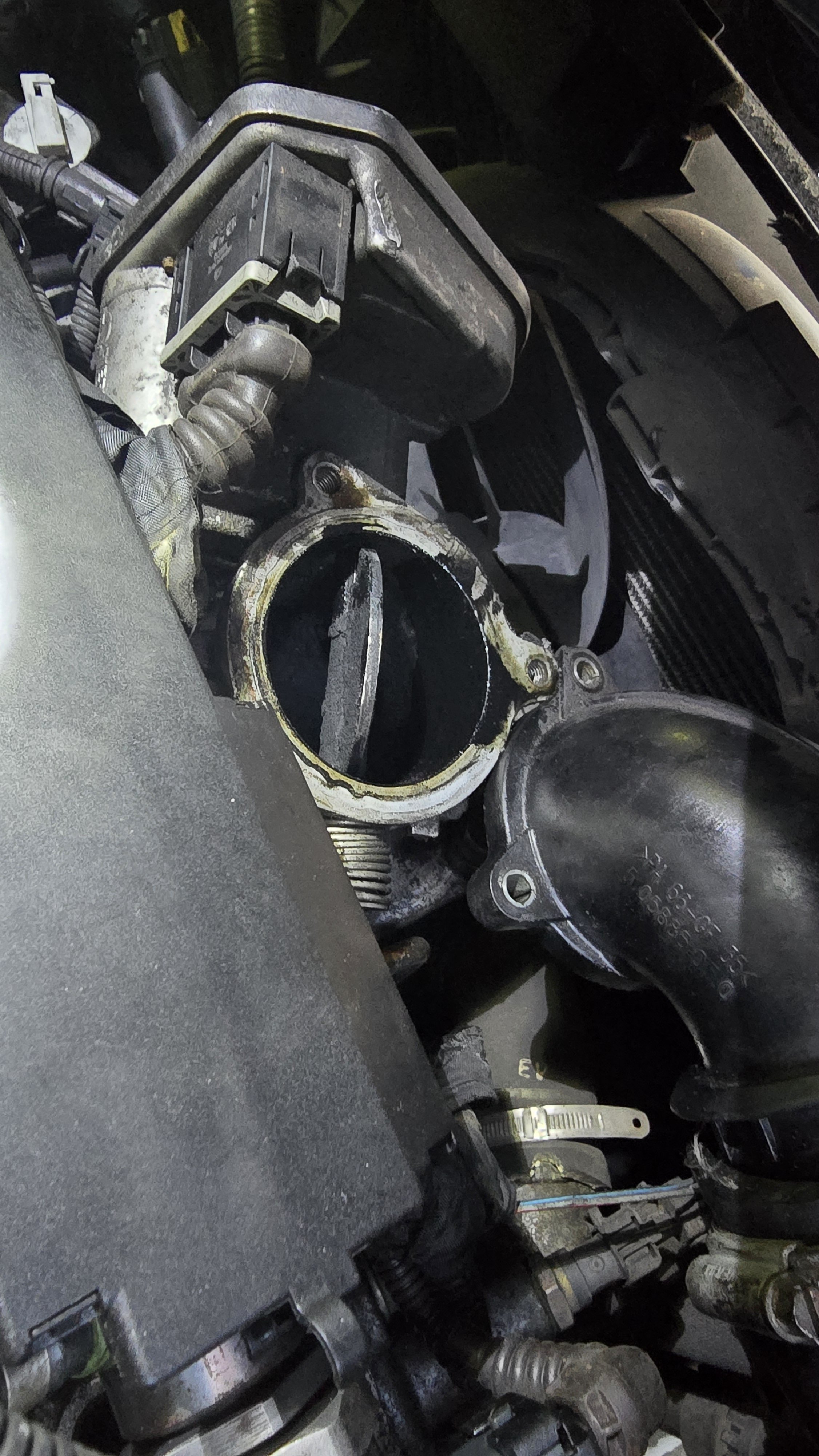

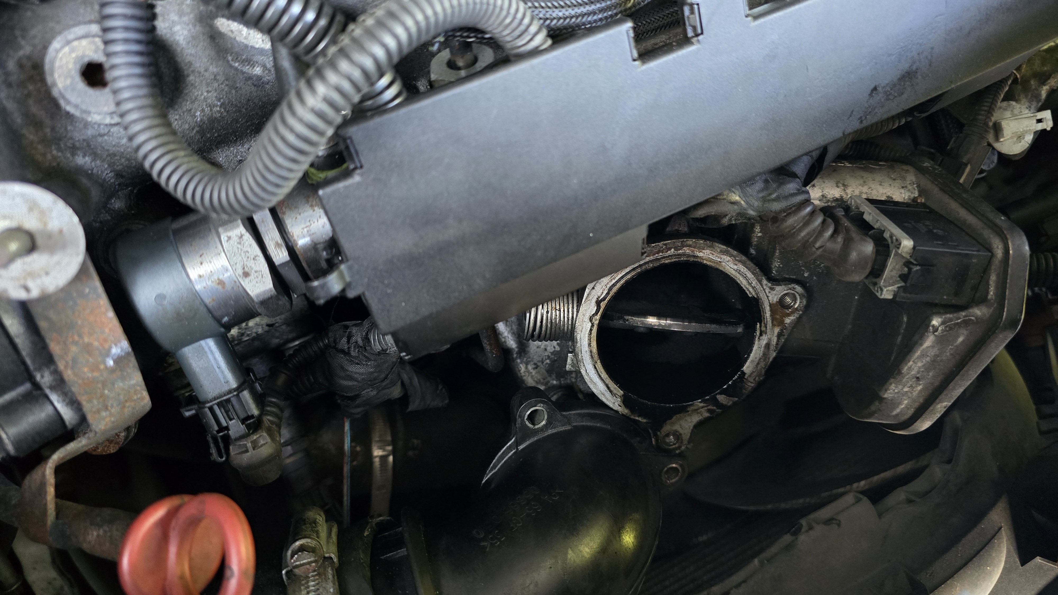

I don't know if throttle valve is strangling inlet have a look at it, try mes actuator function to activate it whilst looking at throttle plate. DO NOT PUT FINGERS IN VALVE unless you want them chopped off.
Pulled the cover off and used actuator function to check function, seems to be working fine, however there was a fair amount of oil in there as well!

When throttle reads 5 % is that nearly fully open or nearly closed?
You are doing great ruling things out.
Could unplug throttle valve when it is fully open and then test drive-if no difference throttle valve is not closing and strangling air flow into engine.

Unplug throttle valve when it's fully open test drive. Plug it back in after then delete fault codes caused by running disconnected.
Or mes read opening amount engine running looking at throttle plate -make 100%sure nothing could be sucked into engine.

5% open, so virtually closed off.
It's only there to work with the EGR system
It closes the ensure it sucks more EGR than intake
Check valve doesn't close under spring pressure when unplugged
