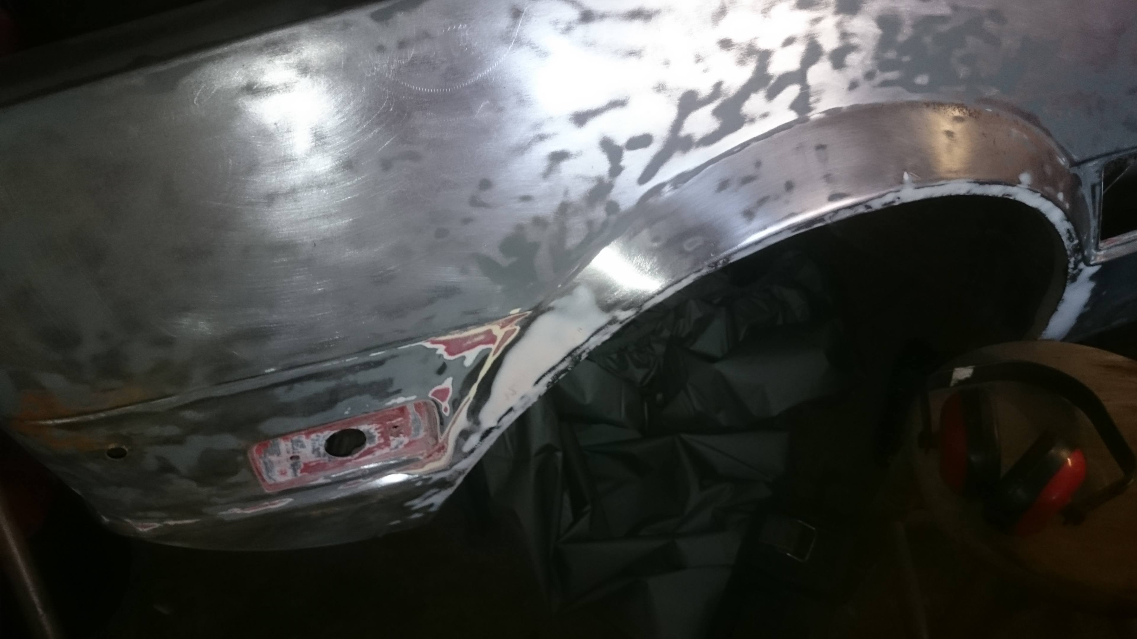

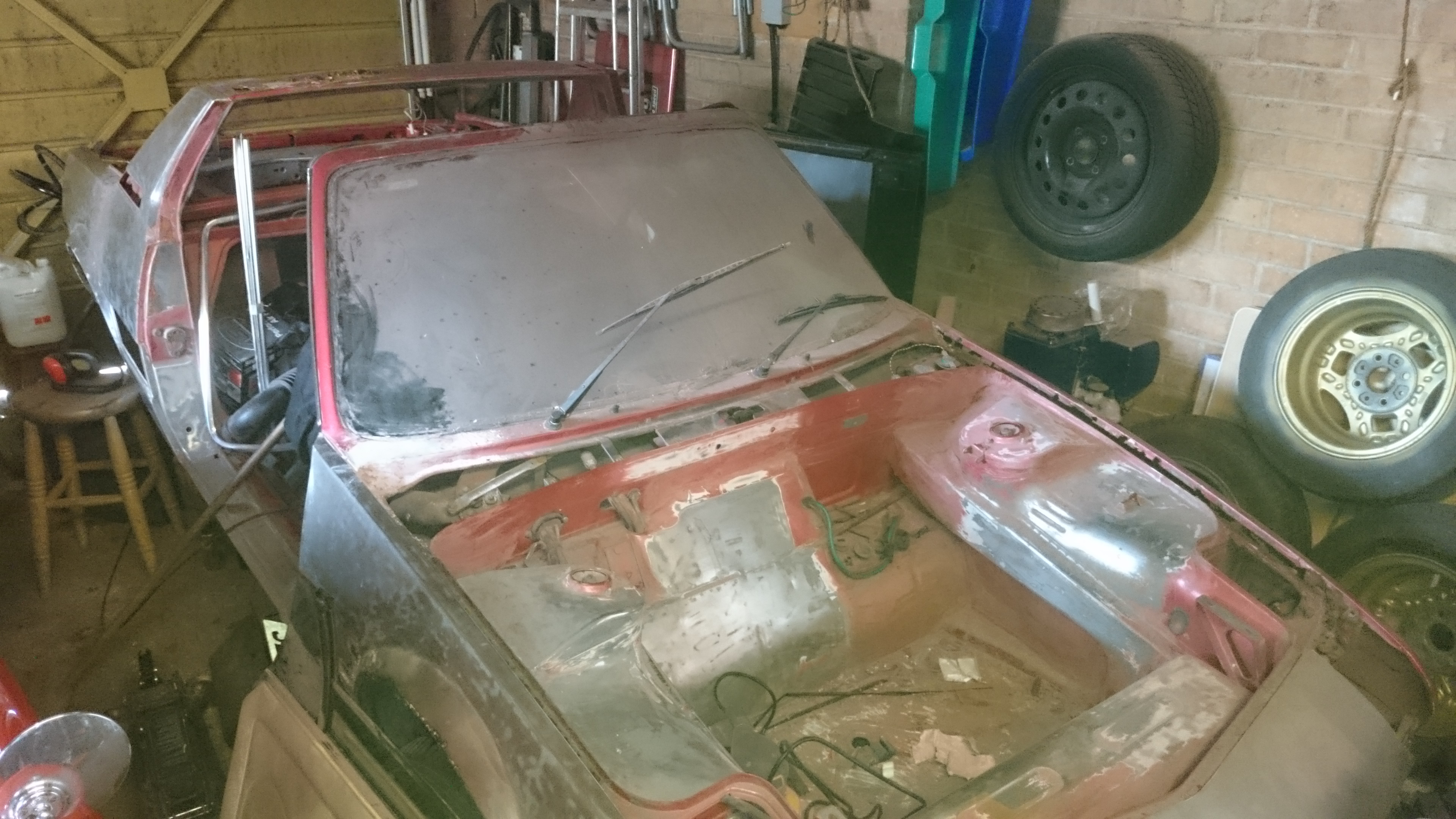

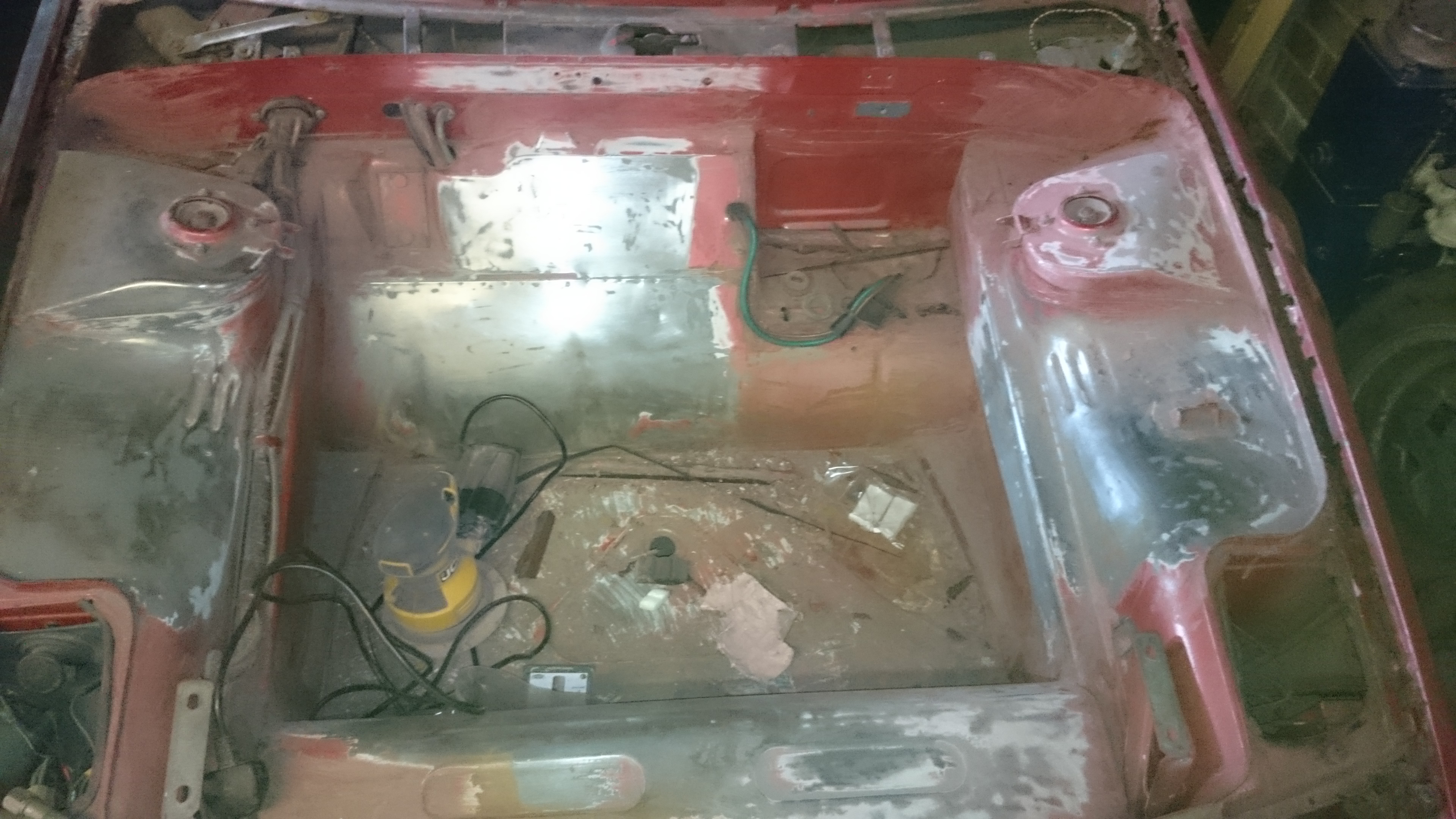

Spent the day stripping paint out the engine bay and using body filler to hide the massive pitting from surface rust in there (Treated with rust treatment too so all is good!)

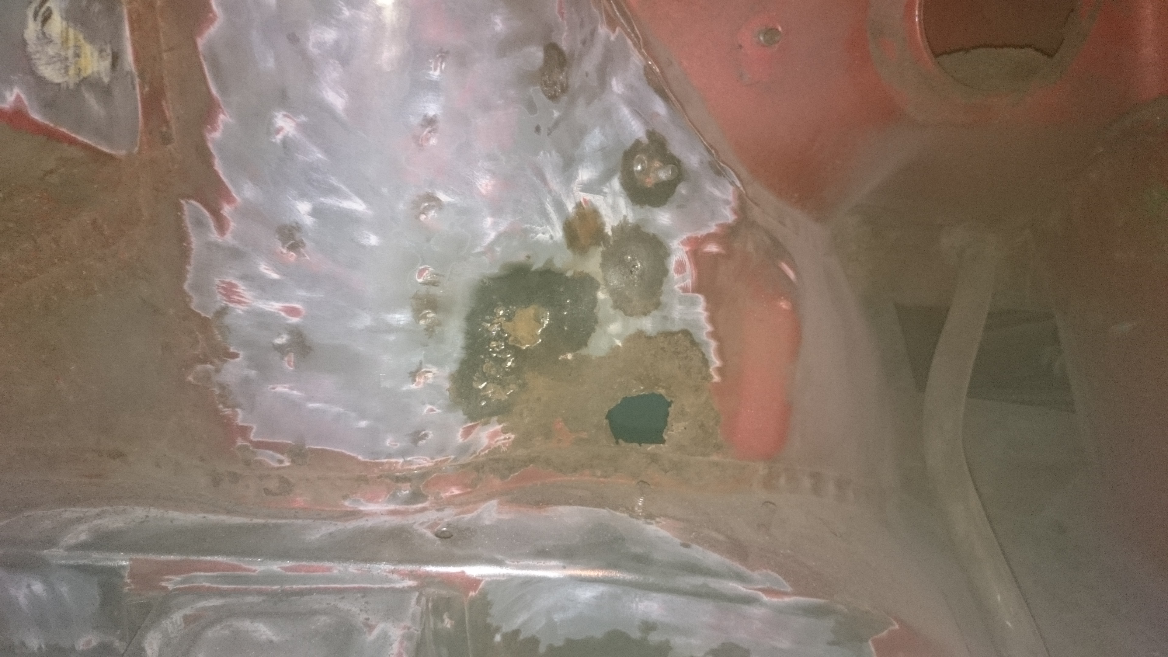

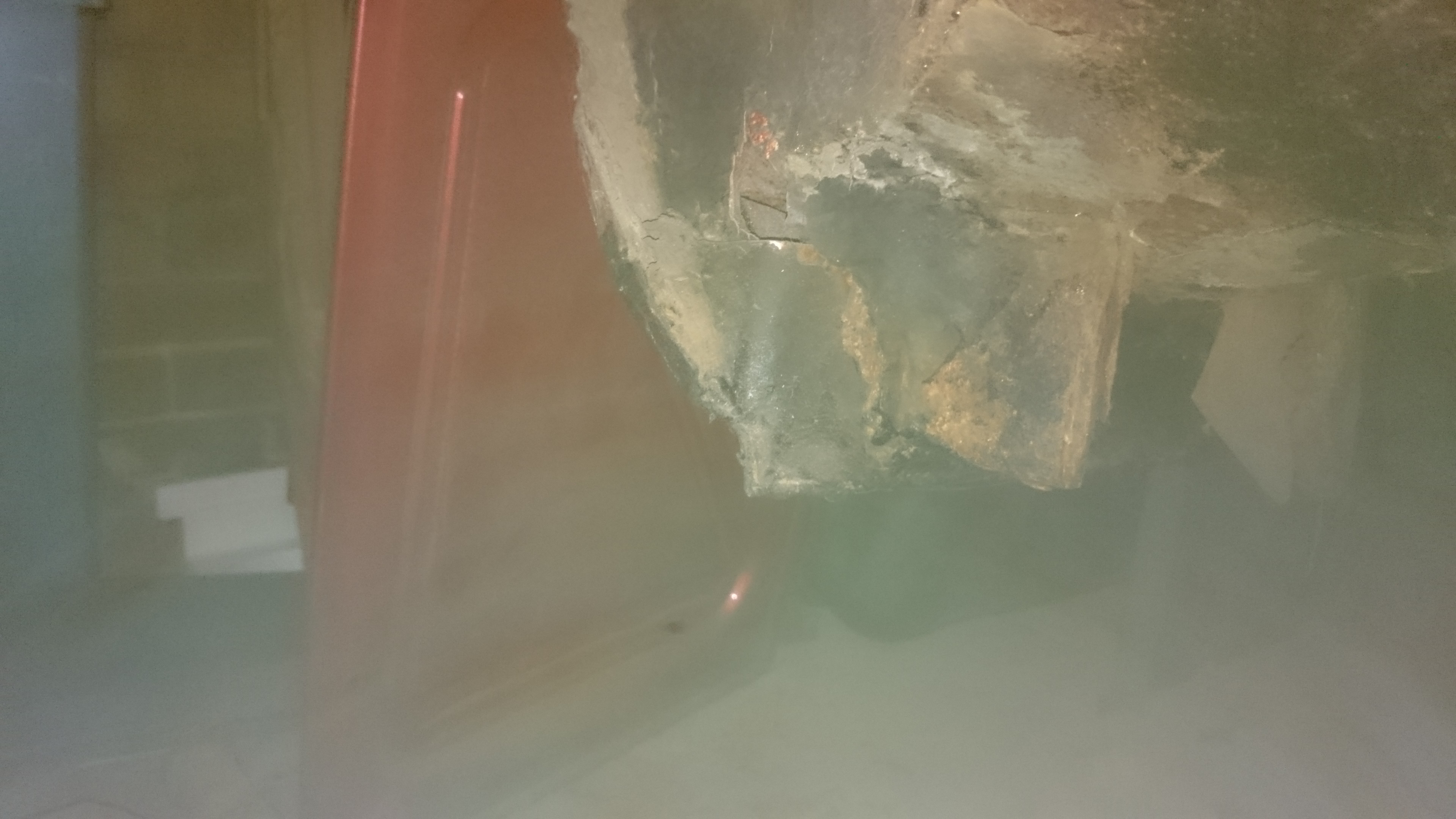

Found another huge rust hole in the rear of the passenger side sill so I'm not looking forward to tackling that. Side note: is it possible to run flexible brake lines from the junction in the engine bay instead of rigid lines to the wheel arches then flexi? It's just the rust each side has eaten out the mounting points for the old rigid-flexi connector.
I really need to finish this bodywork stuff and get back onto the mechanicals and that stuff, much more fun!
So, nothing new I guess but when was a car restoration a quick process??

Good work saving that car.
I think flexi lines must be clear of any rigid things that might rub through the rubber. Copper is pretty straightforward to install and will last forever.

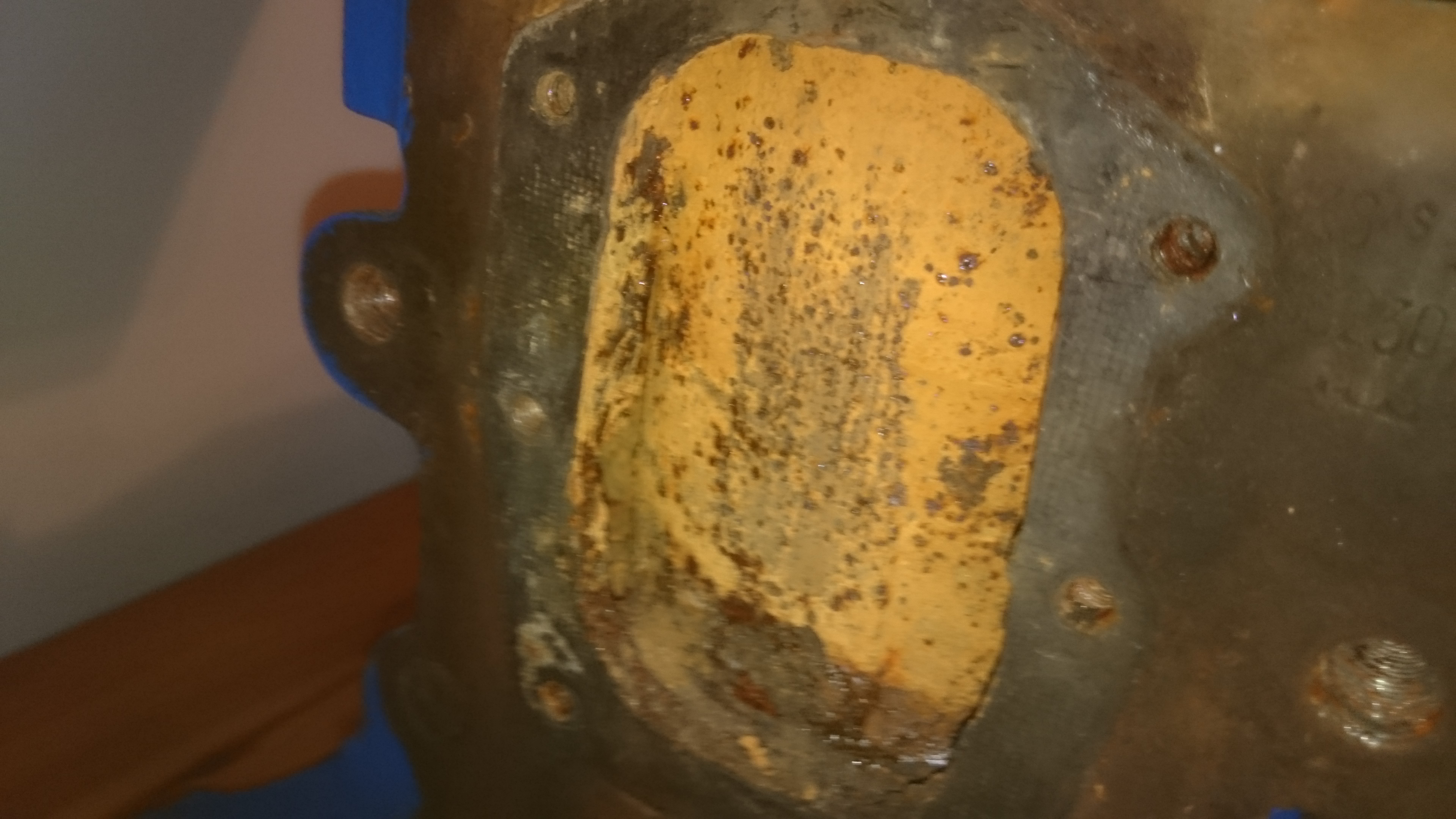

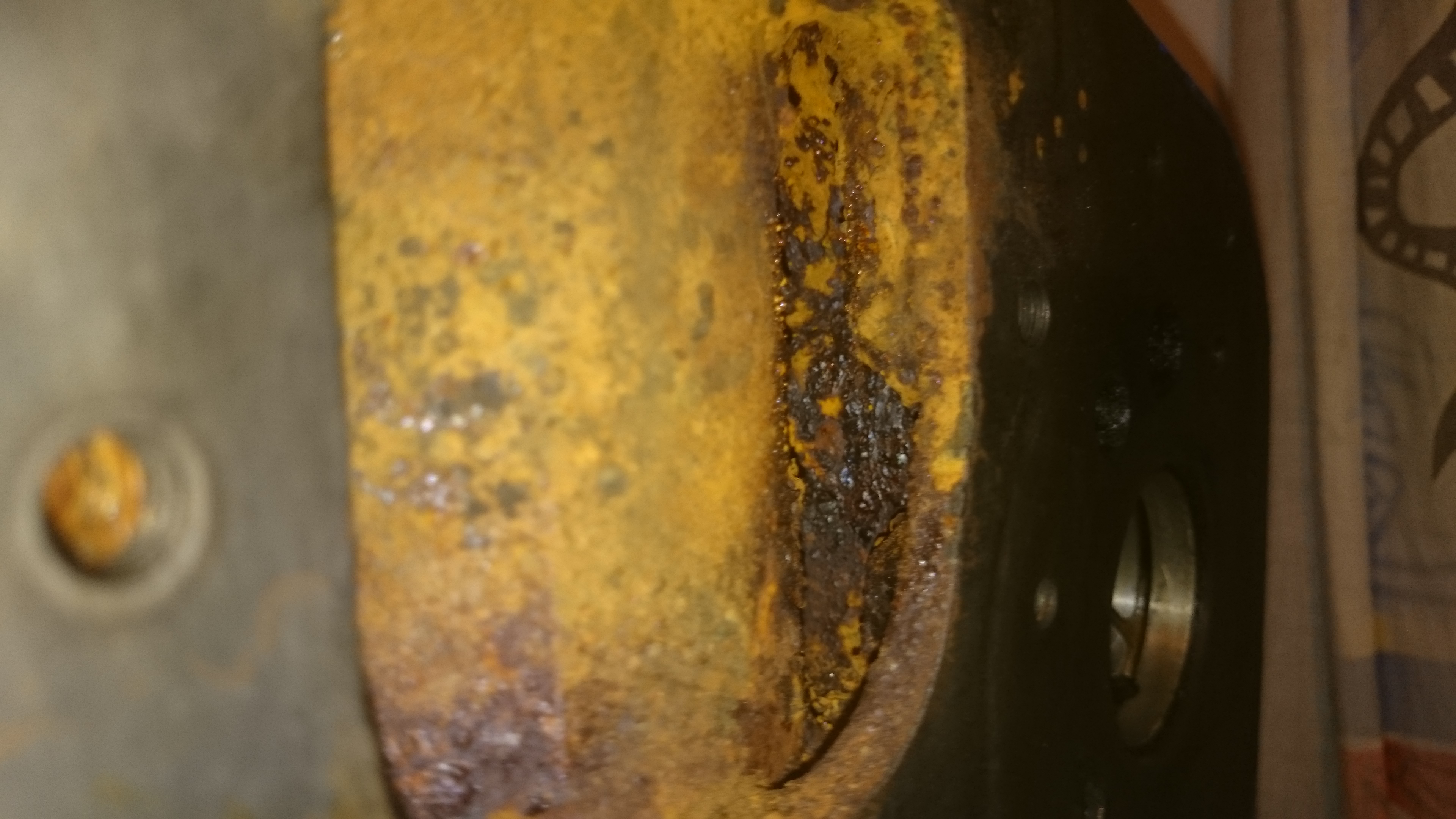

Had another look at the engine block and I'm wondering if there's a way to get out the accumulated rust and stuff in there? Doesn't look healthy.

I'm not sure what the best method is when it's disassembled. Perhaps steam or chemical cleaning or something (expensive option).
If it had leaks it's probably been run without sufficient anti freeze which makes it look worse.
It might look better once its been running and flushed a couple of times. People on the owners club have suggested putting a dishwasher tablet into the coolant to help flush the system. That's the cheap option.

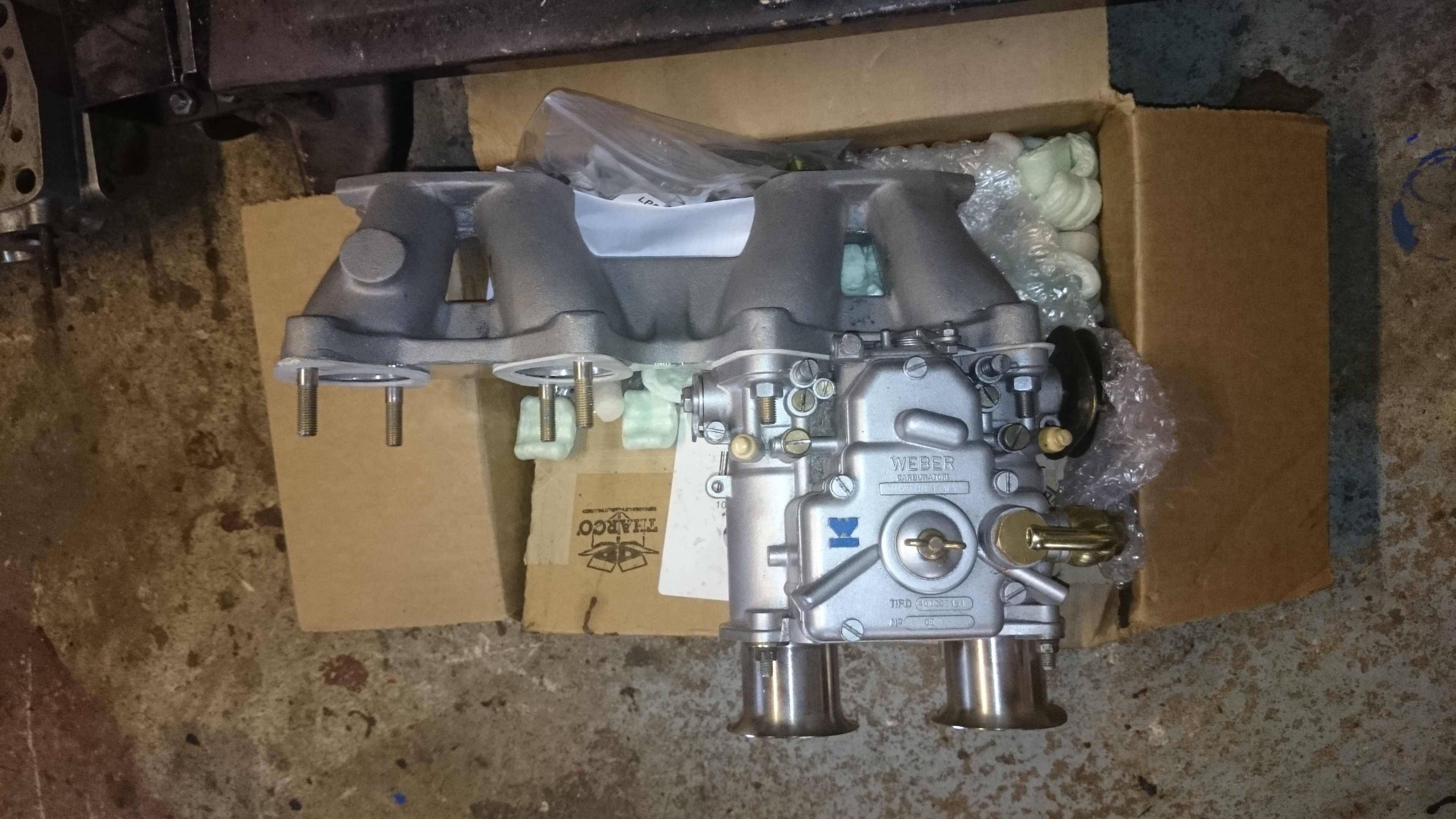

Got a manifold for the DCOEs (I know I said I wouldn't... But I did ;-)) Does anyone know what kind of jets will be needed?

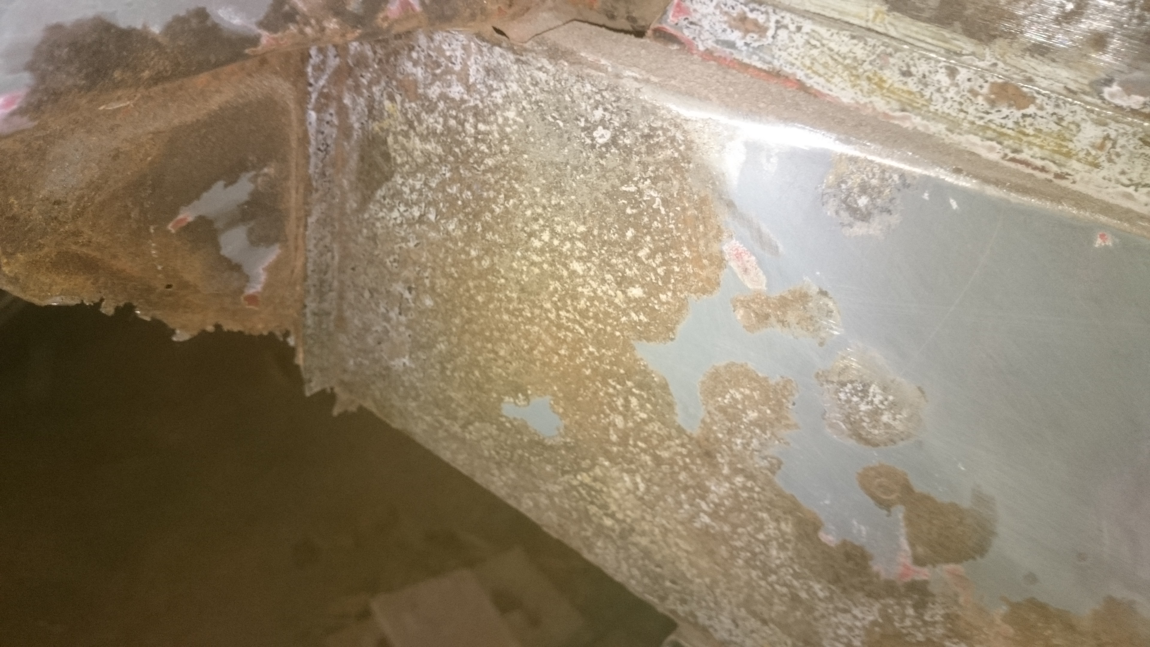

Iv got a few jobs done and exposed some rust on the rear valence and the tips of the rear wings thanks to a botched past repair...
Yeah me likewise - Half the rear valence has rotted through...
The channels between the front wings and the boot have also rotted badly so that they're no longer attached (good job hiding it with fibreglass...) Would it be possible to weld new steel flat over the top or are those channels there for a reason?

Well I've ordered parts for the engine so I'm hoping to get that built up when they've arrived and run it on a stand, just while the body is in such a state. Should be good to try out these new carbs and get some decent pictures!
