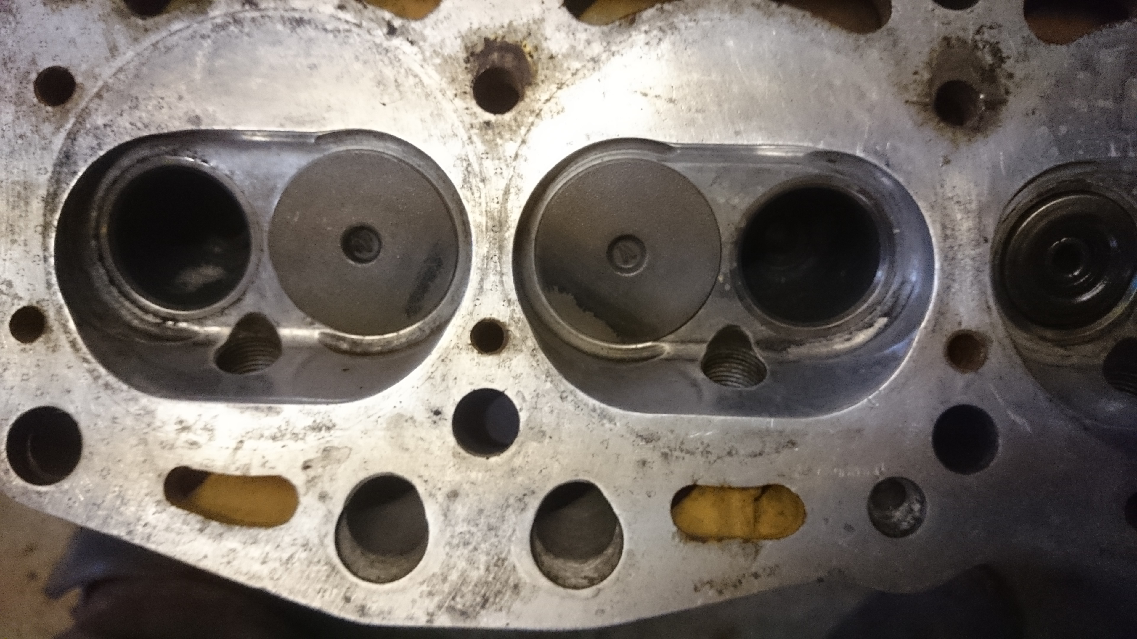

But other things have been going on! Getting the head back tomorrow with the punto valves so I'll see how they look. Also planning on installing a pair of driving lights to compliment the pop up ones but not sure where they'll go yet.

Are the punto valves larger? the earlier punto sporting had a very similar engine in 1600 form with fuel injection. I guess you had the broken studs fixed and a valve job? I think the 1500 camshaft was the best of all the factory Lampredi engines.

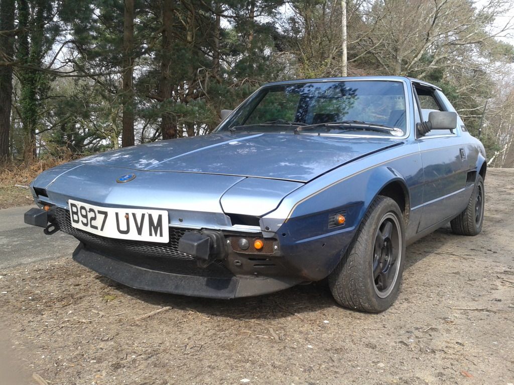

This is what the front of mine looked like 6 months ago, its got proper 1300 sidelights now which were £50 with old slightly cracked lenses. You can buy the lenses new £... Note the temporary lights. couple of people have said it looks a bit mad max. I'm sure the front valence could be fitted better. The number plate is fitted through the original trim holes. The square holes under the lights I'm not really bothered by but you can make up a cover plate to fit here.

The punto valves are about 39mm if I remember rightly, they look a lot bigger than the old ones but there's a small gap between the valves still. Eurosport (I think) had a set of 8 valves that were 40mm intake and about 33 mm exhaust, I doubt they'd fit but they were fairly cheap.

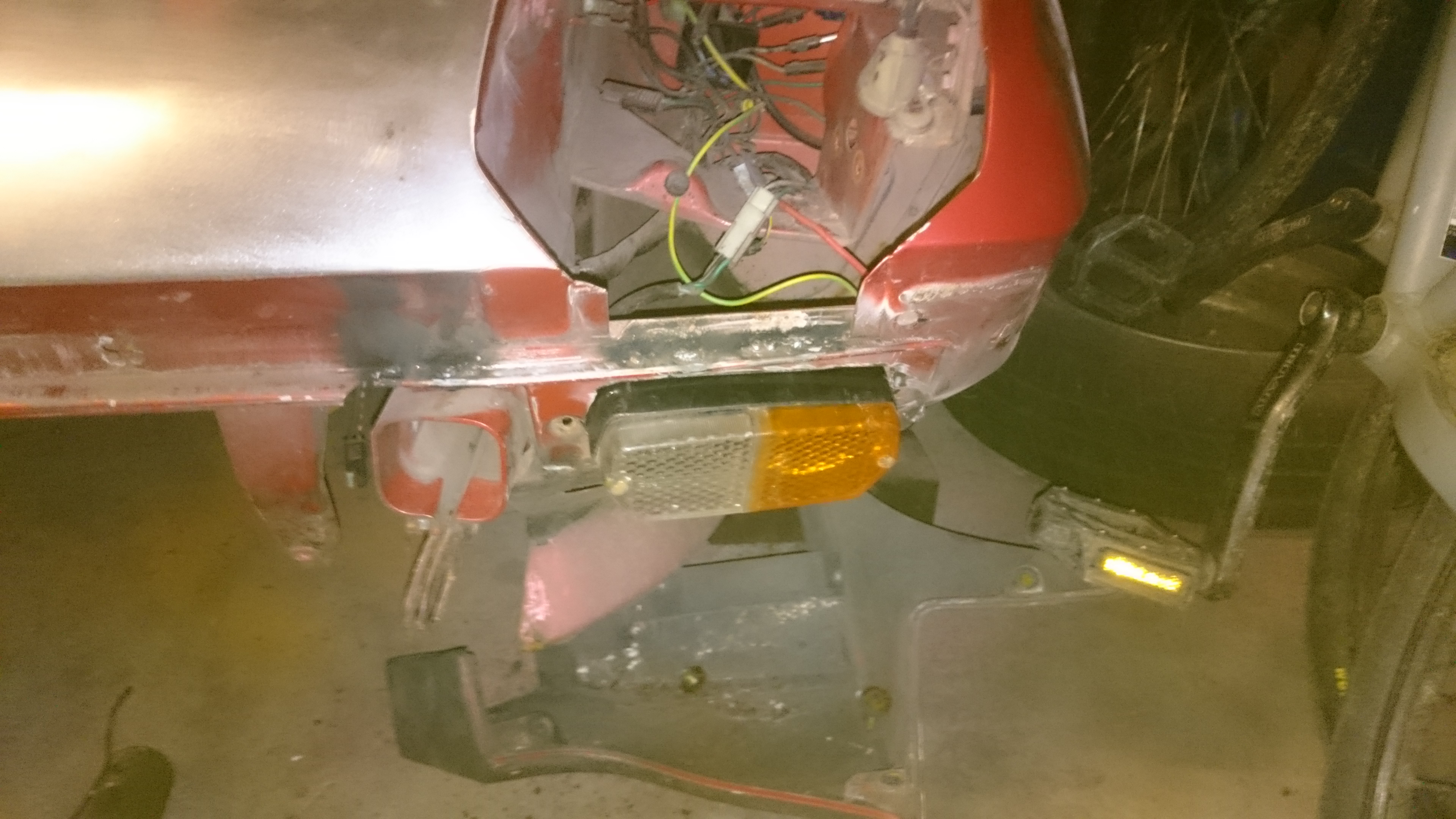

Ive started trying to refit the indicators below the headlamps, there was a very conveniently sized panel there that I've cut a huge whole in. Any ideas how to fill the gaps around the edge of the indicator where I've overshot slightly?

Oh no too late... It doesn't look too huge of a hole. How are you going to mount the 1500 lights in the hole? I dont like cutting anything on mine (even though its got a touch of rusting in places)

Don't worry! The hole making was thought through. I'm going to unscrew the bracket from the bumper that used to mount the light, weld in a bar beneath the headlamp (plenty of room) and then bolt the bracket to that, indicator to the bracket. I'm sure there's method in my madness somewhere.

Not sure whether the valves are GT or not (presumably so) but they're almost identical to the old ones in every way so getting new seats put in wasn't that bad.

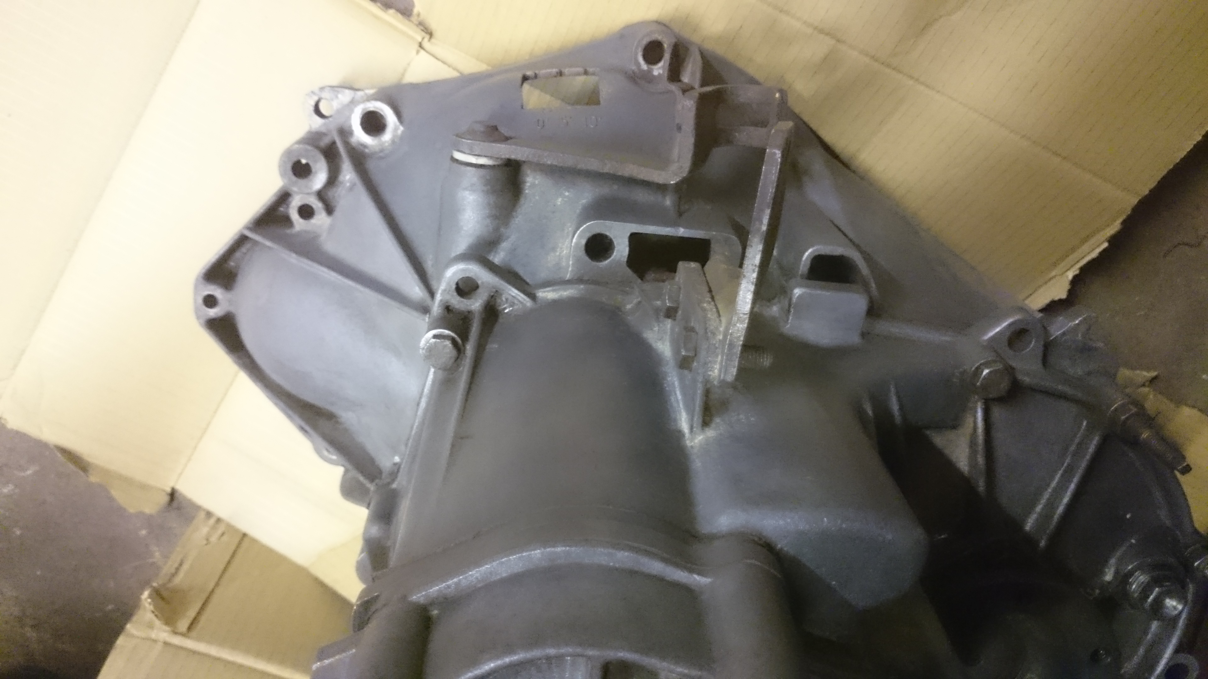

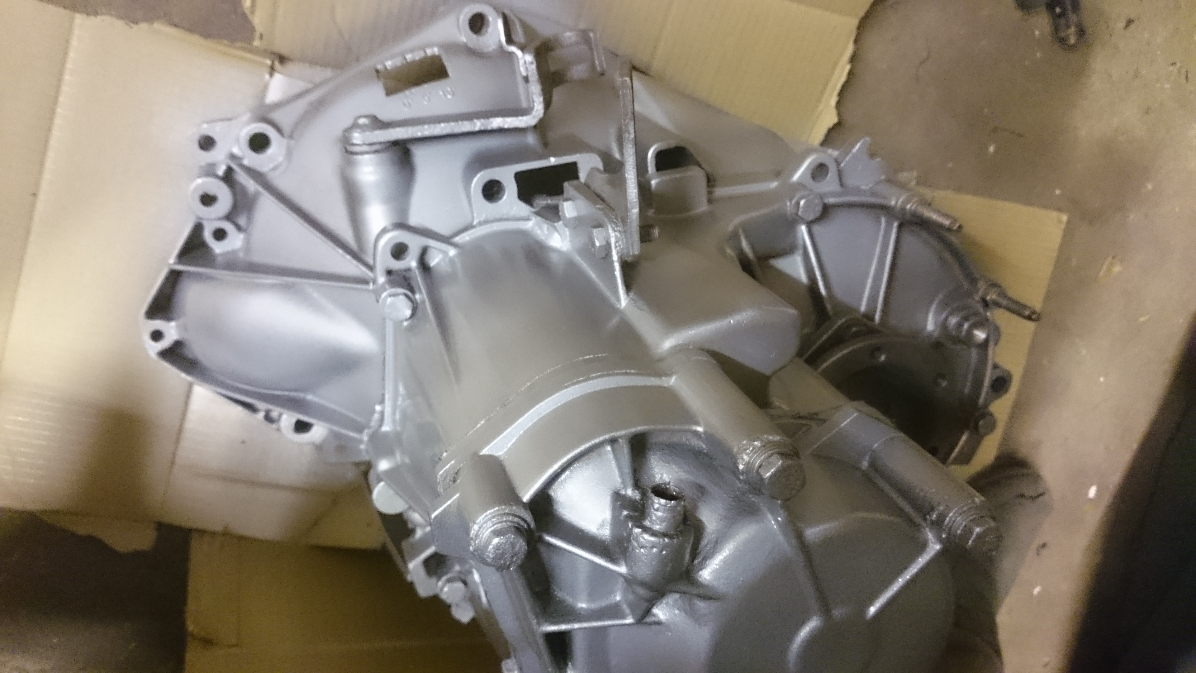

In the mean time, I've been cleaning up the gearbox and painting it as well as thinking these indicators through a bit more. How plausible does it sound to screw the lens of the indicator through the sheet metal into the indicator housing to hold it all together?

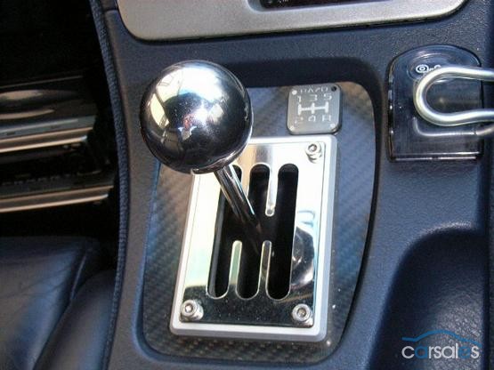

Final thing I've been wondering, is a gated gearbox a plausible idea? I've seen a few and they just look the part! Use some steel plate to fashion the gates, chrome plate it and screw it over the gear lever in place of the rubber shroud. Is that possible or is there more to it?

YNice gearbox! How was the third gear syncro? (common weakness) Maybe liquid knight could advise. As you have the box out it might be worth changing it. They are not too expensive from eurosport. Also the clutch and release beating?

Gated shifter Would be cool. I'm sure I have seen someone on xweb in the US with one?

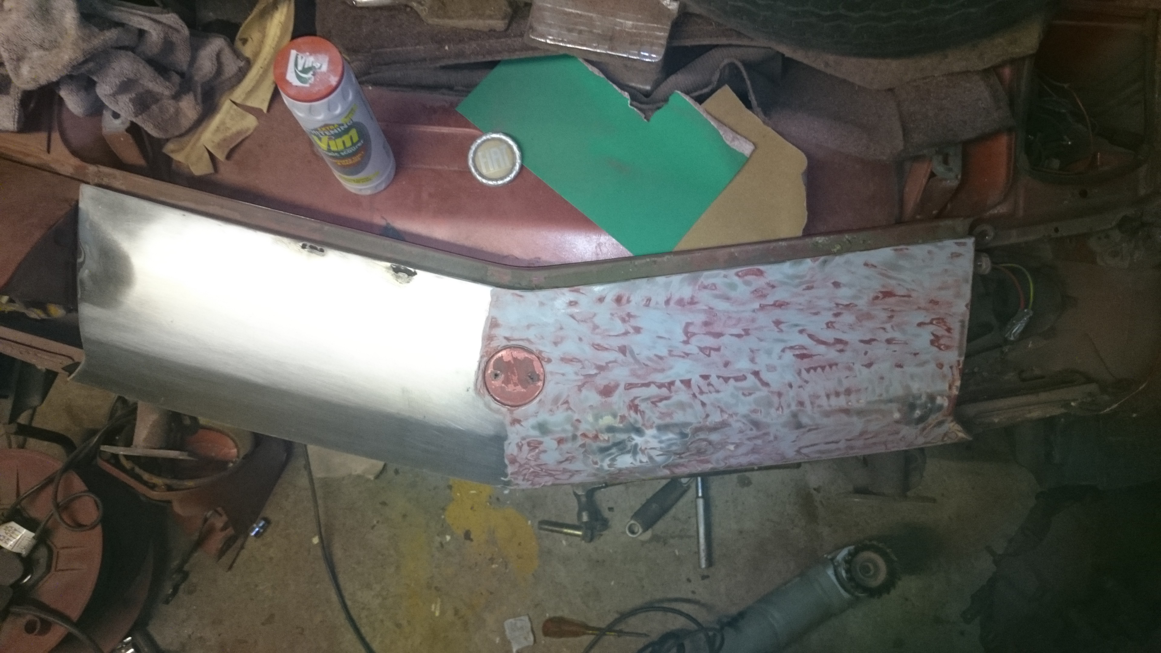

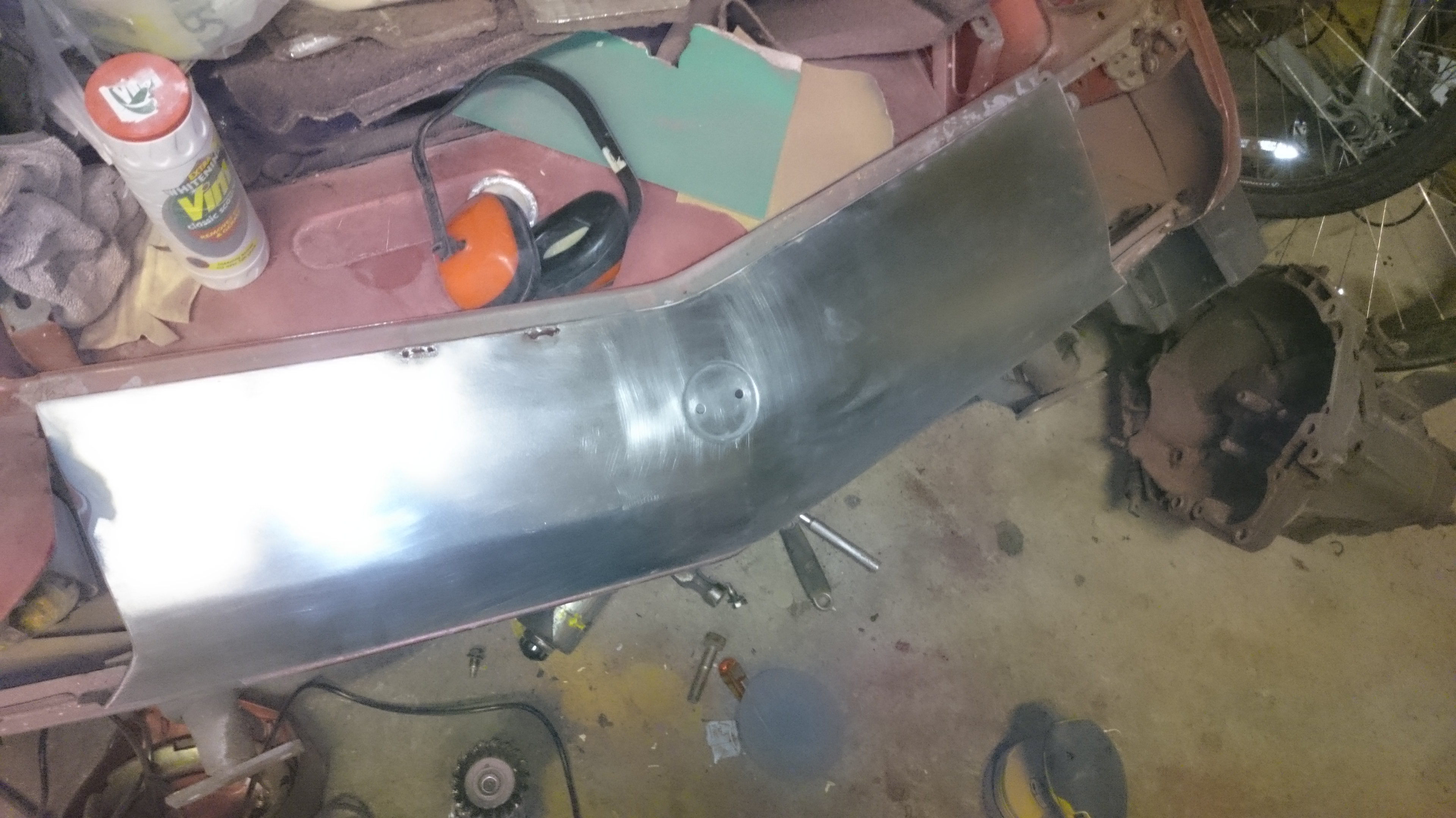

Hi all, hope you had a good Christmas and New Year!
Not much to report on sadly, bodywork still driving me insane and the indicator issue is still prevailant...
So, still sanding the bodywork, going to respray the engine cover and targa top whilst I'm at it as they're different shades of black...

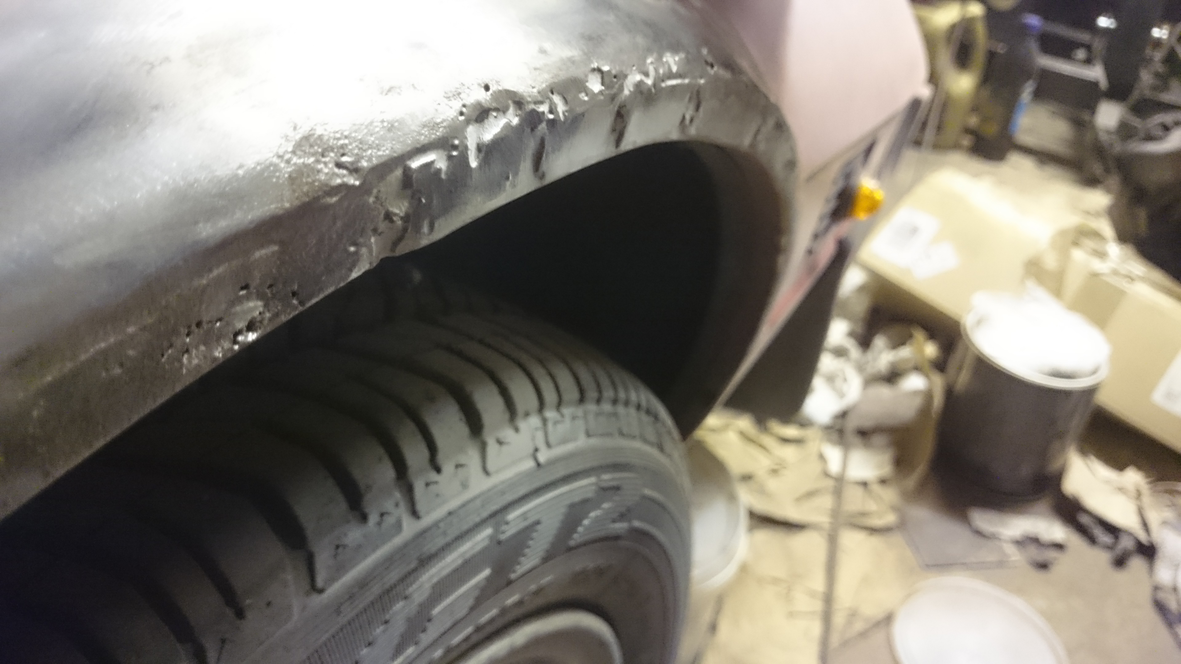

Welded new rims (or whatever they're called) to the driver rear wheel arch and I've filled in all the dents and stuff.
New plan on the bumpers due to the indicators: I'm going to keep the aluminium parts, get rid of the black plastic bits around the edges and try to redrill the huge bumper mounts so I can move the bumpers closer to the car.

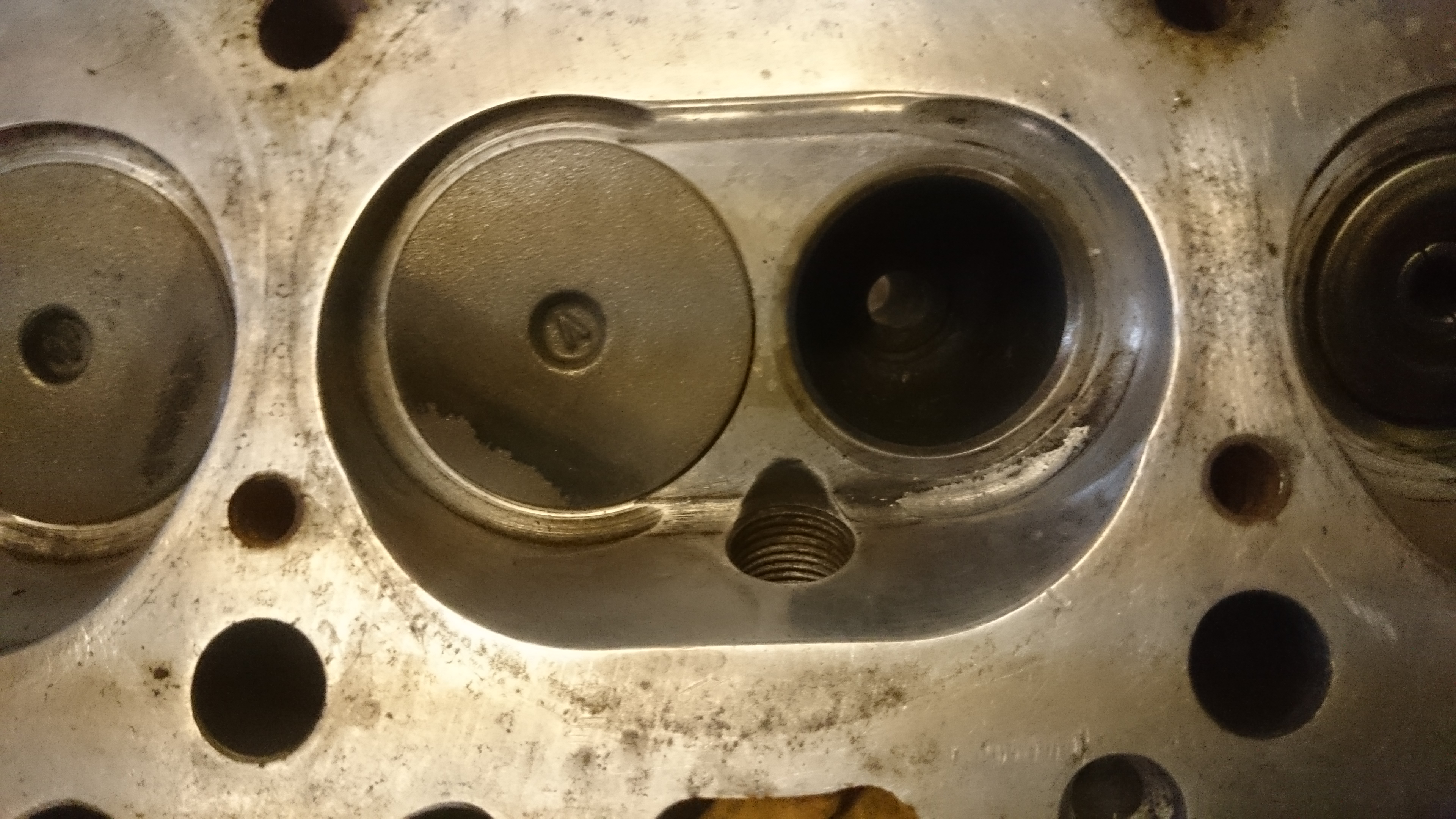

Having had a the big intake mod done on the cylinder head and the dual DCOEs planned, I reckon it'll be an interesting mix of rust and too much power in the end. Anyone know where to get hold of a manifold for it? I've found a couple in the states but was wondering if there's anything this side of the pond?

Good call on tucking the bumpers back a bit.
If you keep the bumper then the indicator issue is solved.
Good to see the old girl is in safe hands. Is that the spare head you're working on? You can fit unleaded valves from a Punto 90 and you'll need to re-wrap the exhaust so stop the Weber boiling fuel in the carb'.
There was only one head with the car, the one with putty around the thermostat fitting? New seats are unleaded so shouldn't be an issue there hopefully.
Manifold looks well wrapped as is, I've tightened the stainless wraps though so nothing should slip off. I may fabricate a steel plate or something to go between the carbs and manifold and insulate that to really reduce any transfer.

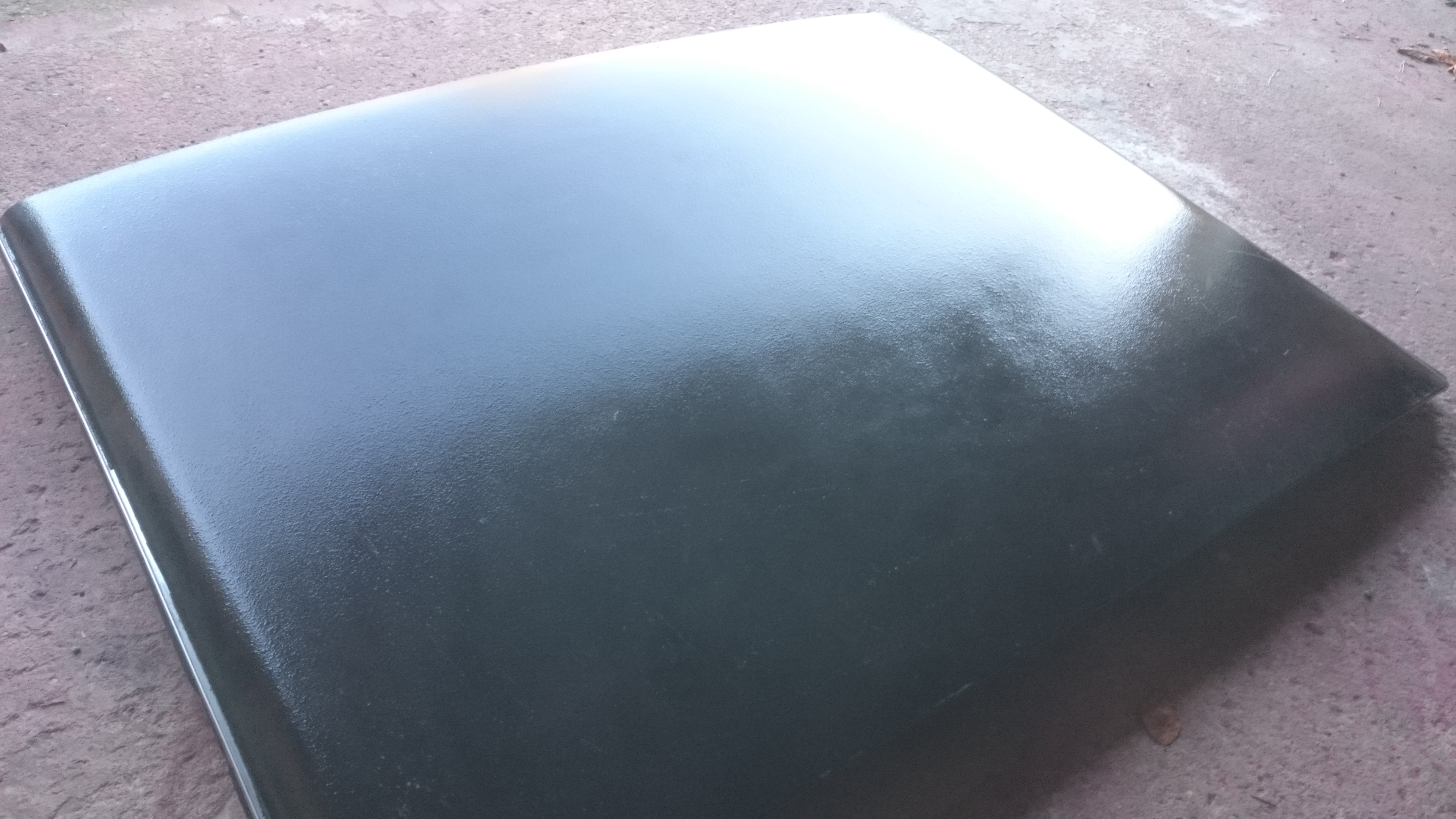

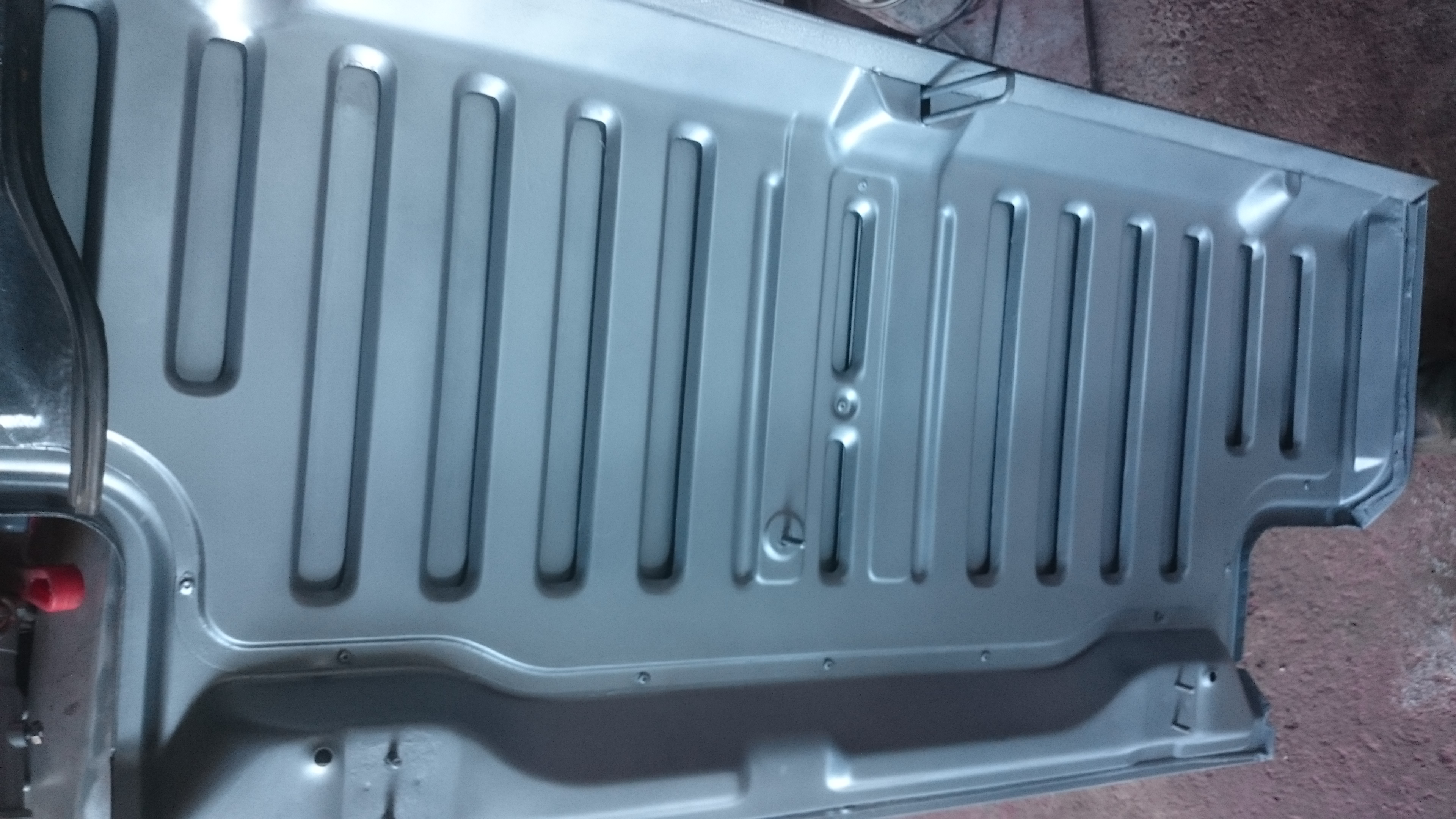

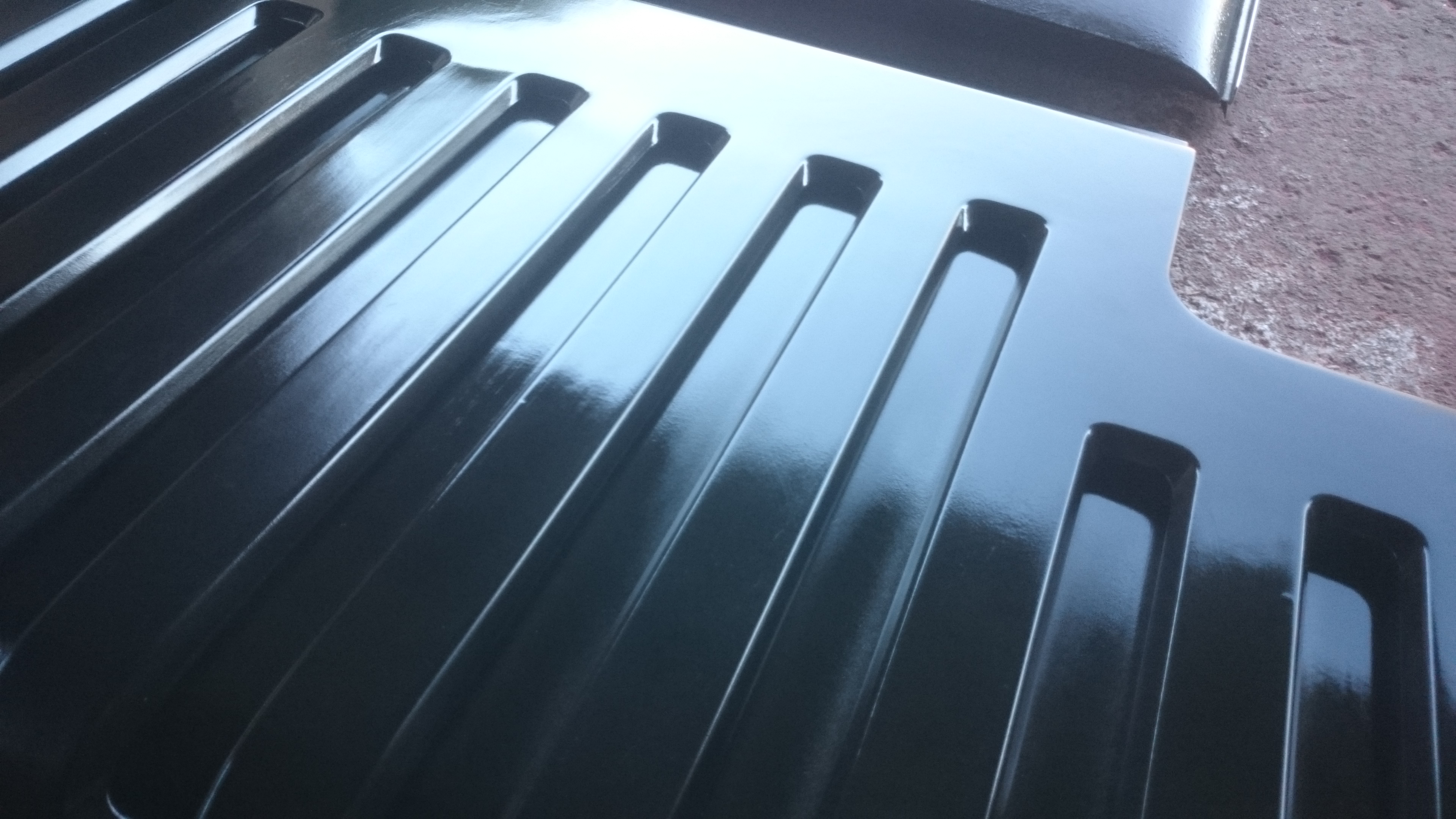

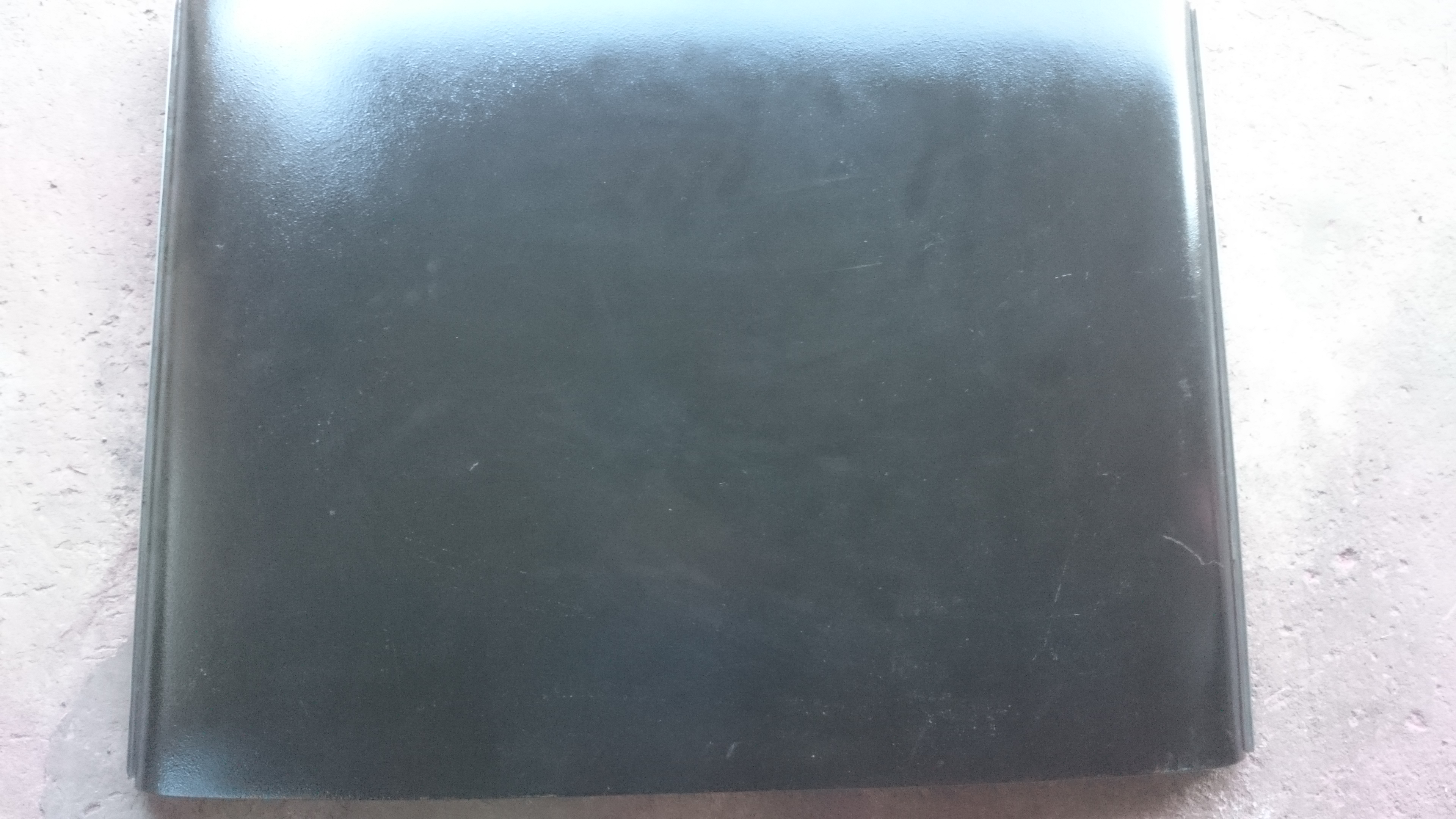

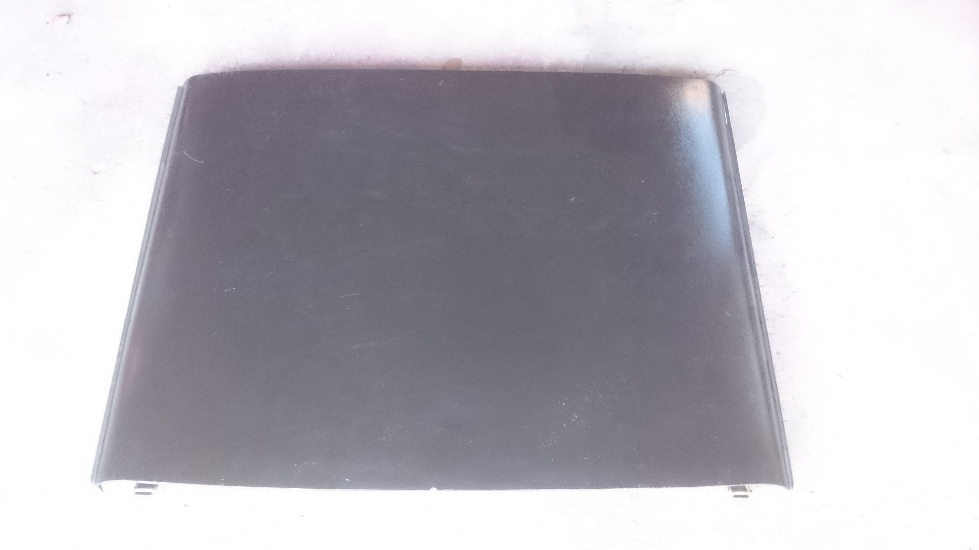

Have been sanding more paint (not particularly interesting) and have painted one side of the engine cover, will hold off pics until ifs finished!

Paint is all dry so I just need to work out how to take decent photos on my phone (easier said than done.)
Looking at the original eBay ad for this car that Liquidknight bought it from, apparently there was "No major areas of rust" on the car... Which explains the 20 sq ft of sheet steel I've had to buy in order to replace the lack of rust!
Well, only two panels done, far too cold to paint now so the rest will wait!
BMW Sapphire Black (Metallic) for the outsides, aluminium high temp for the inside engine cover.
