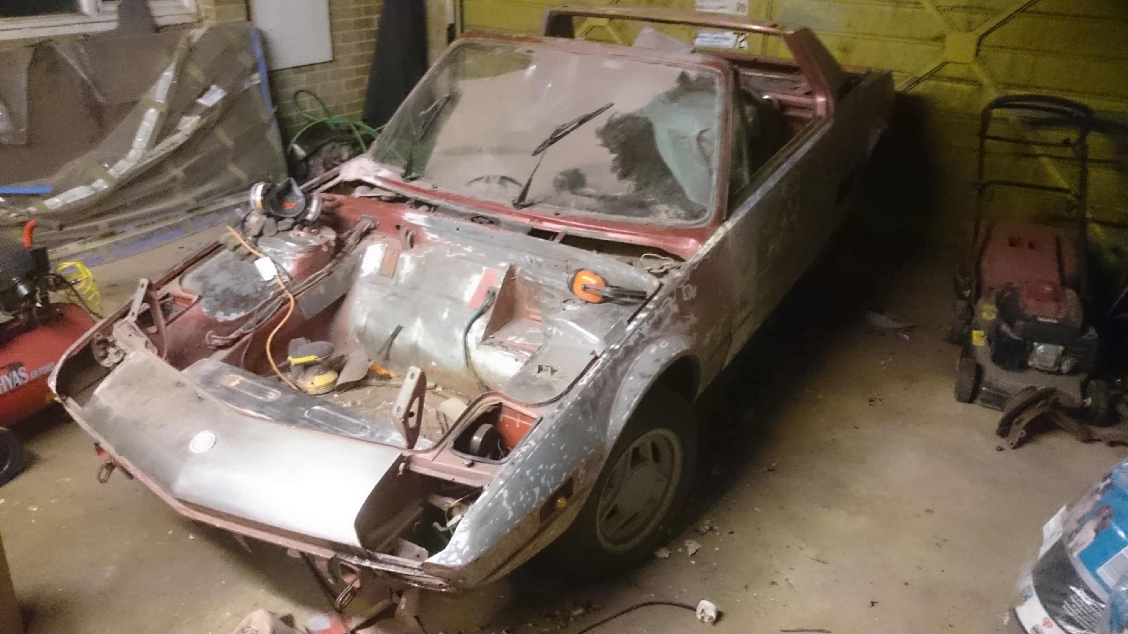

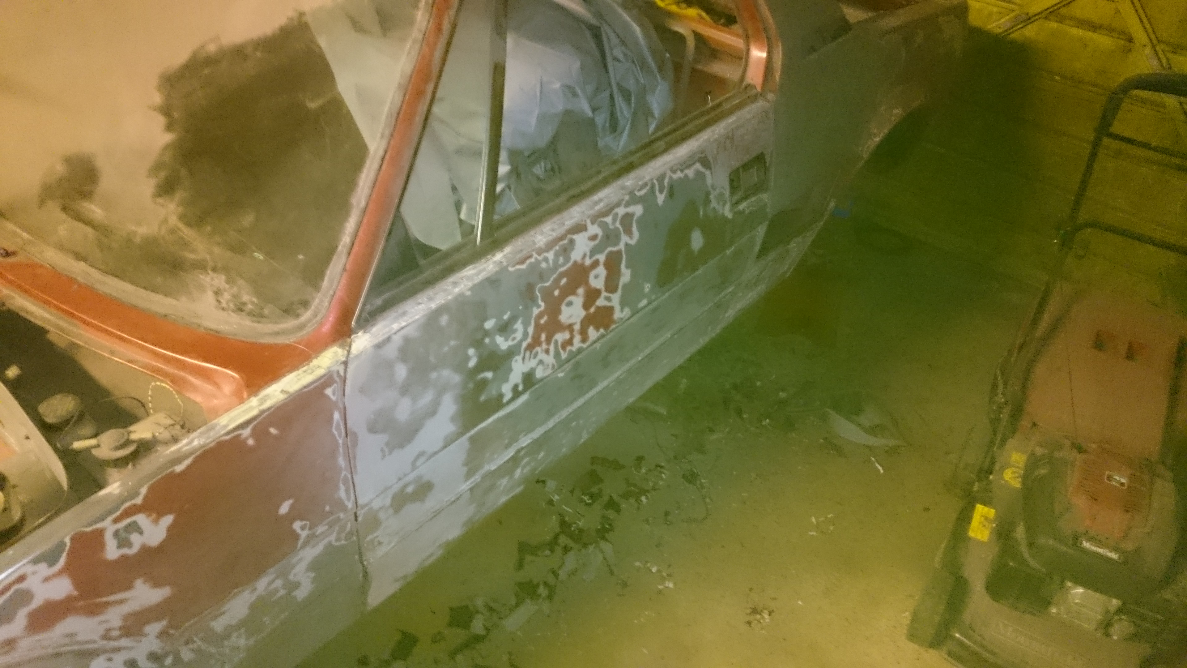

Stripped and nearly finished sanding the entire other side of the X (amazing what you can do with room eh?) And found that the rear nearside wheel arch inside bit is absolutely riddled with rust. So that's fantastic...
So it looks like I'm welding in two new wheel arches, the front rain channels, the roll bar thing, the rear boot, maybe some of the front boot and whatever lies in the front arches. Then I've got to do this rad conversion, think about bumpers (euro conversion anyone?) And then paint!

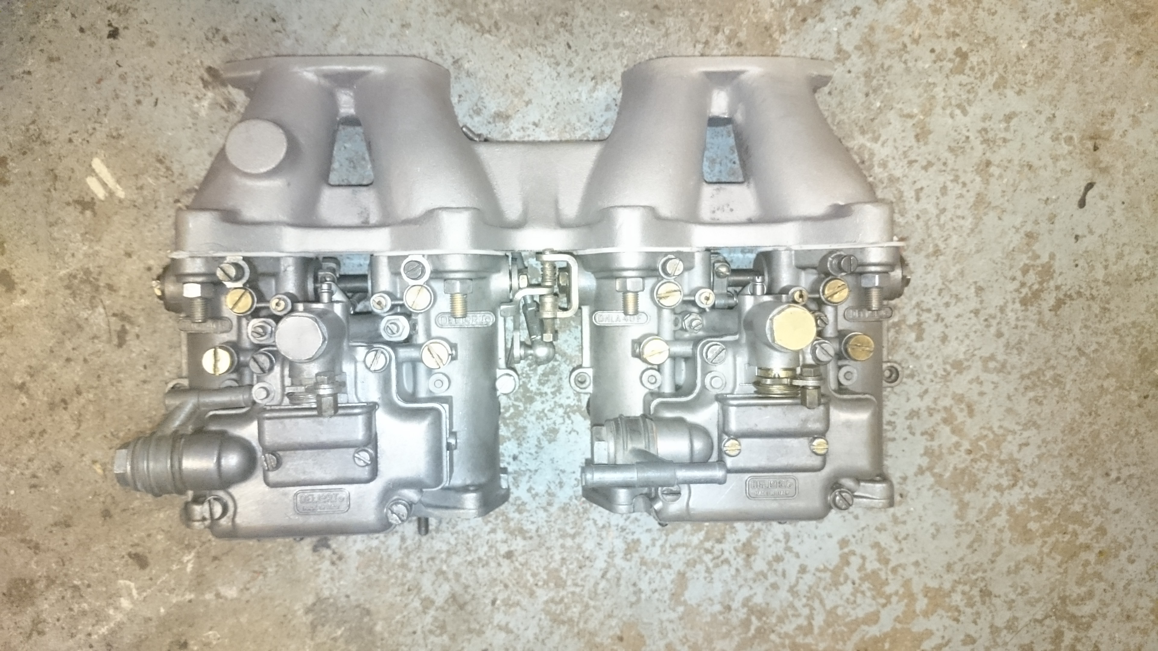

May have bought a pair of Dellorto DHLAs as they were cheap and matched. So I guess I'll sell the weber I have and chuck these on?

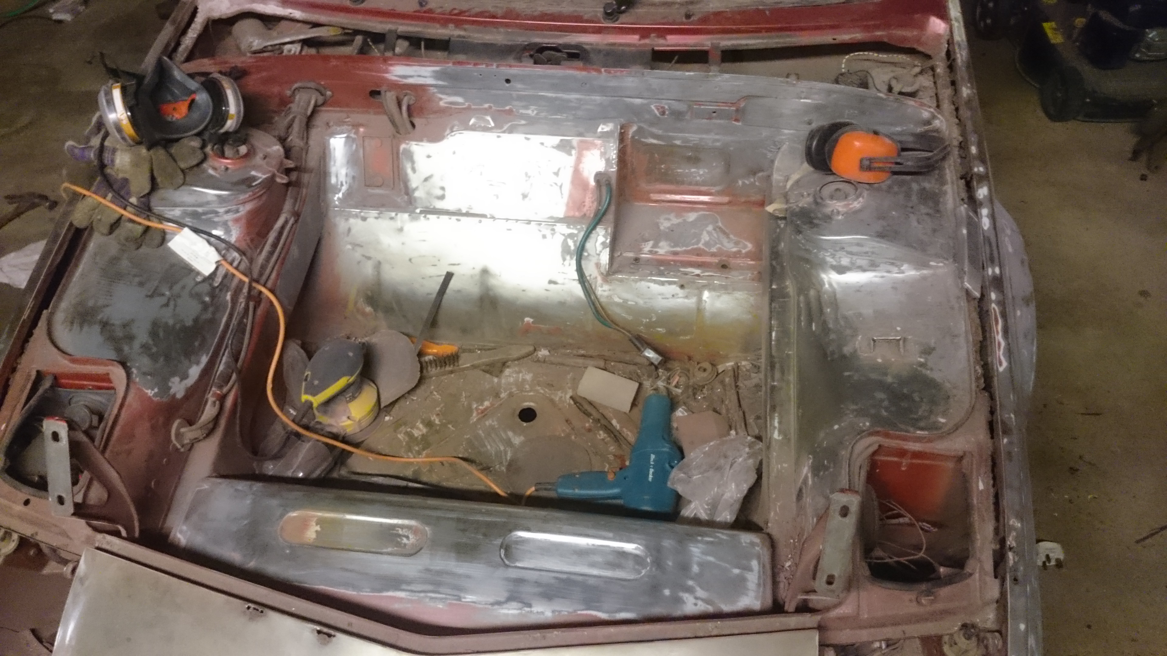

Well the extra space has been pretty invaluable, got so much sanding done!
Also found a pair of carbs that didn't cost the Earth - Dellorto DHLAs all in good nick with a throttle link. So I just need to decide on trumpets. Am I right in saying that the longer the trumpet, the lower the peak torque occurs in the Rev range? I'm not worried about high end power as it should have more of that now, just making it more drivable. I've seen 100, 125 and 150mm trumpets knocking about and, although they're ridiculous, I'm not really restricted in how long they can be, and if they improve drivability then I have no problem.

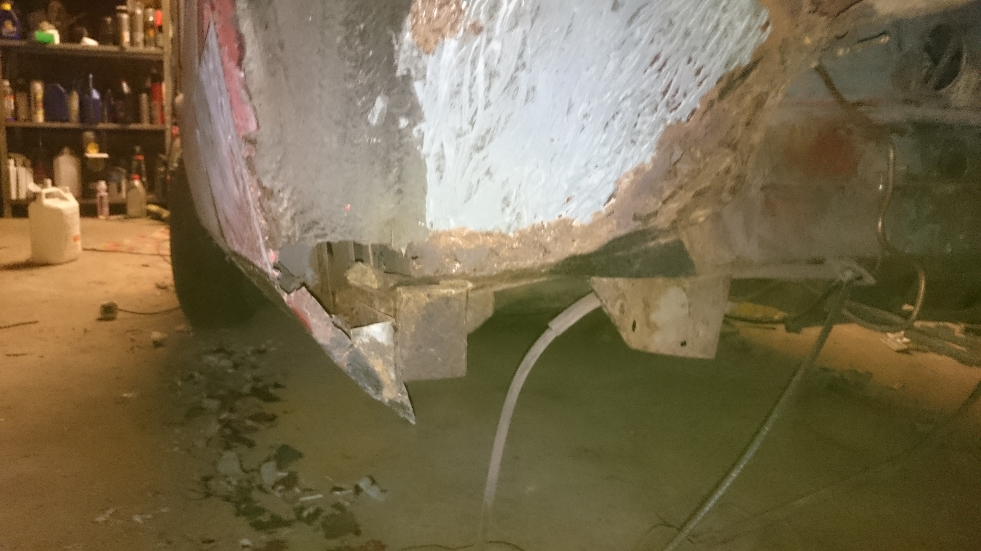

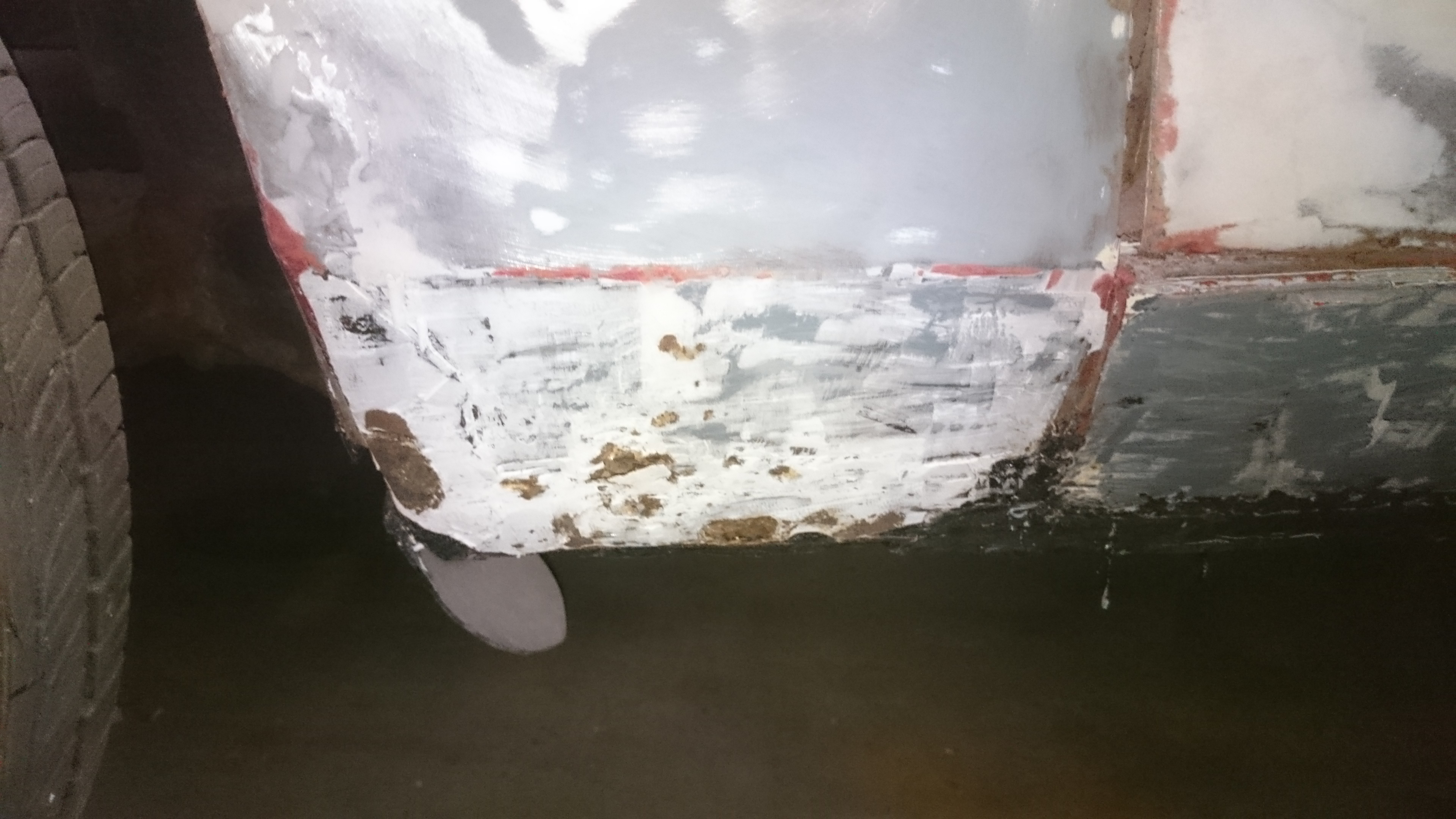

Anyway, lots of sanding and lots of worrying rust spots. The nearside rear sill no longer exists due to 3 minutes with a small screwdriver. But I'm hoping to get the sanding done soon and start the metal work. Then it's just new rad, bumpers, body, sills, engine bay, wheel arches, front nose and rear boot that need doing!

The entire passenger side of the rear structural bit is rusted horrifically, to the extent that you can just poke your finger through all of it. So that's a worry.

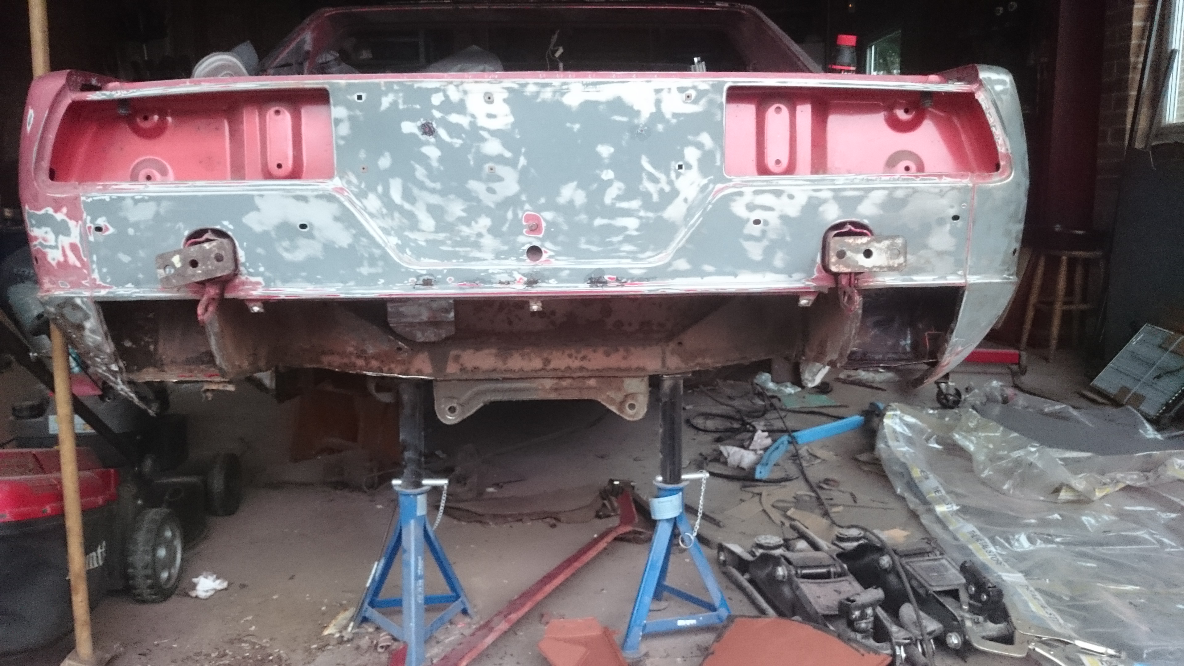

So I've got a new rear valence, those two panels next to the valence and the nearside corner panel needs replacing too. Cut out most of the inner nearside rear wheel arch and repaired with self made panels. Just cut holes EVERYWHERE really, but it is at least rust free now. Just no car left...

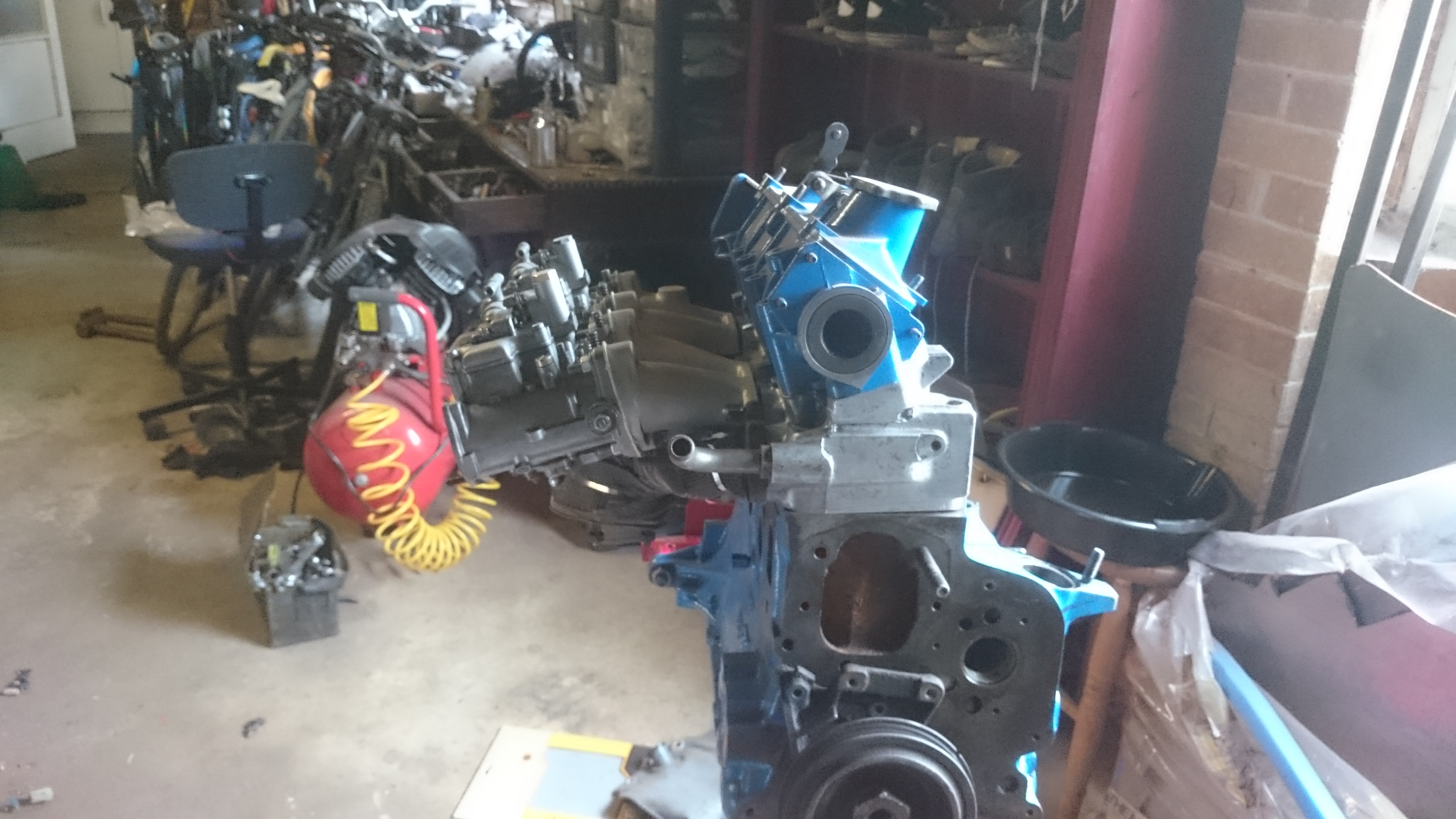

Started to build the engine back up with a hone and new rings. Looks decent with the new Dellortos!

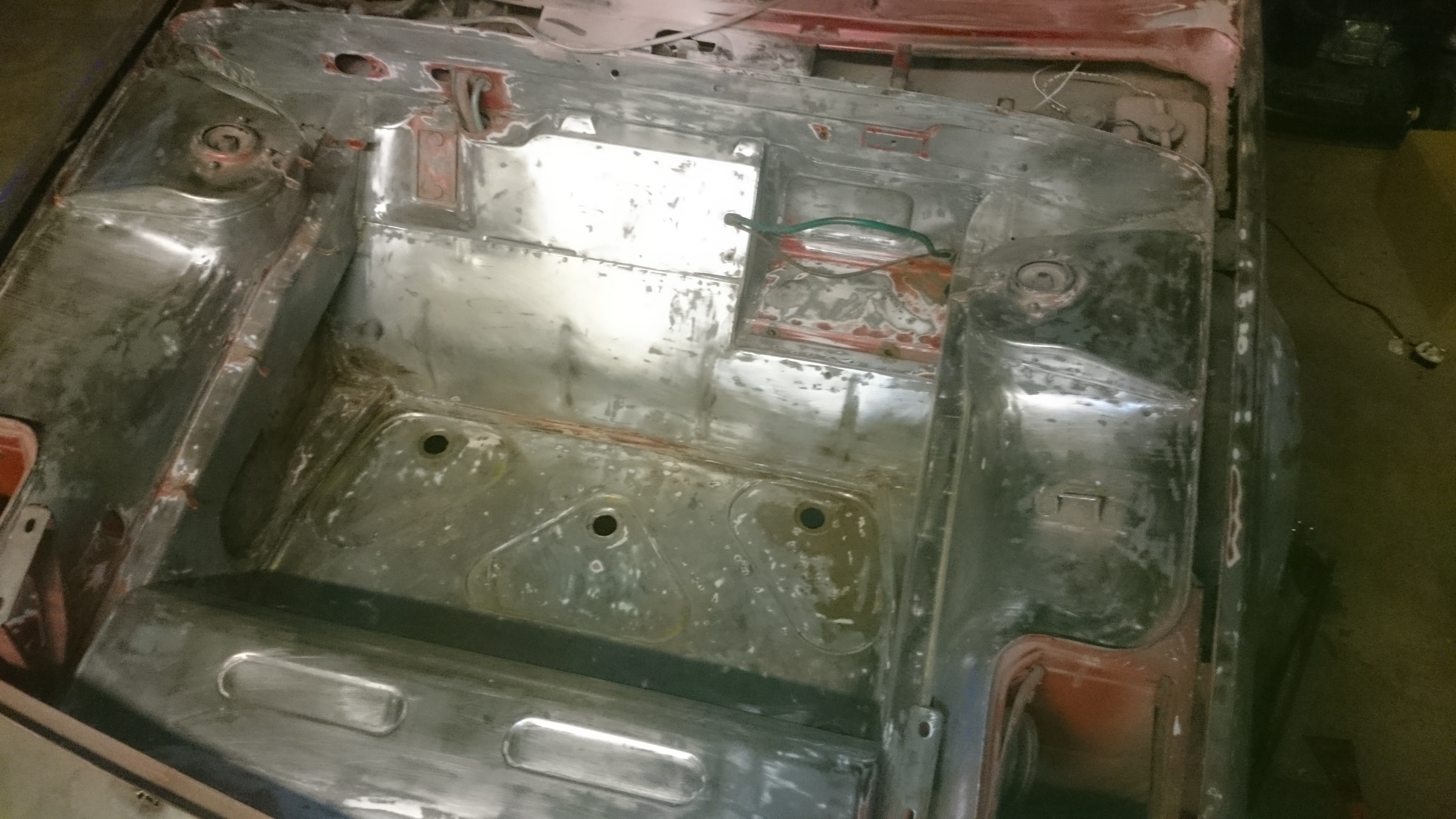

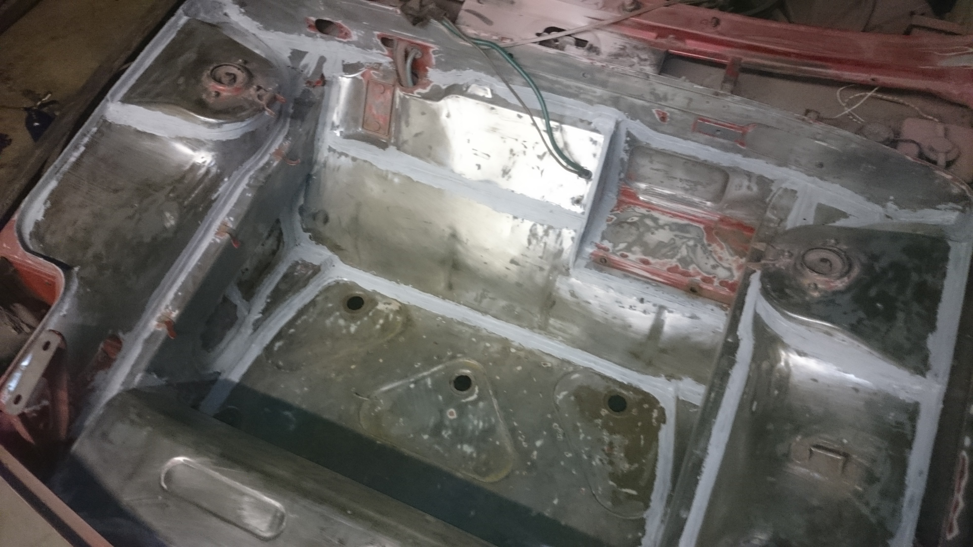

Also just sealed all the seams on the front boot, so most of it is ready paint! Talking of which, I have the paint! Still a few things to sort but it's here I guess.
Anyone with a complete car, where do the ports on the cylinder head line up with on the rear boot divider? Due to the new carbs, I'm wondering what I'll have to cut, or can I just remove the dividing panel?
