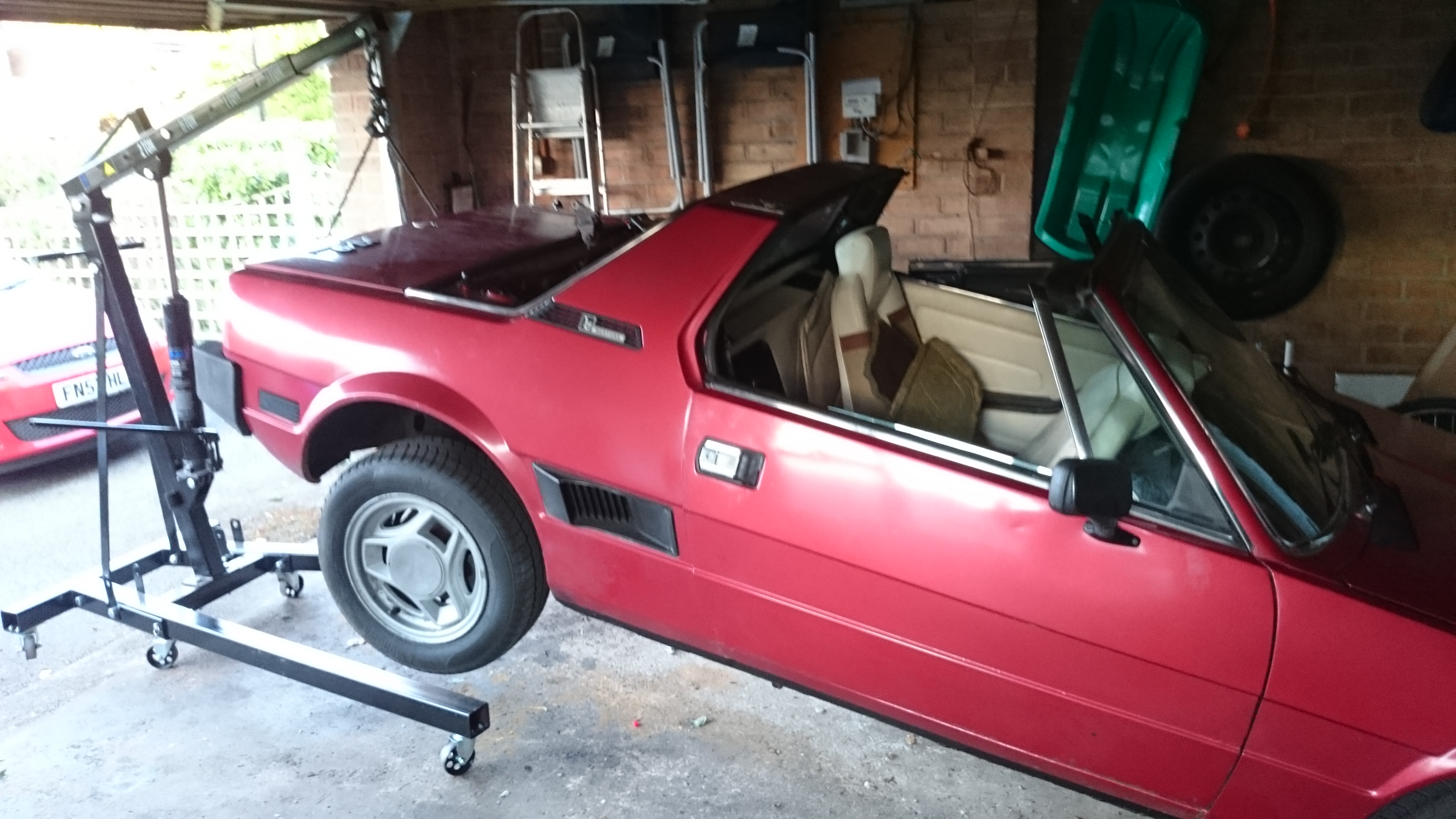

Bit weird finding this post as I'm now the owner of this car. Had it for a couple of months now and it's already in 1000 pieces across the garage.

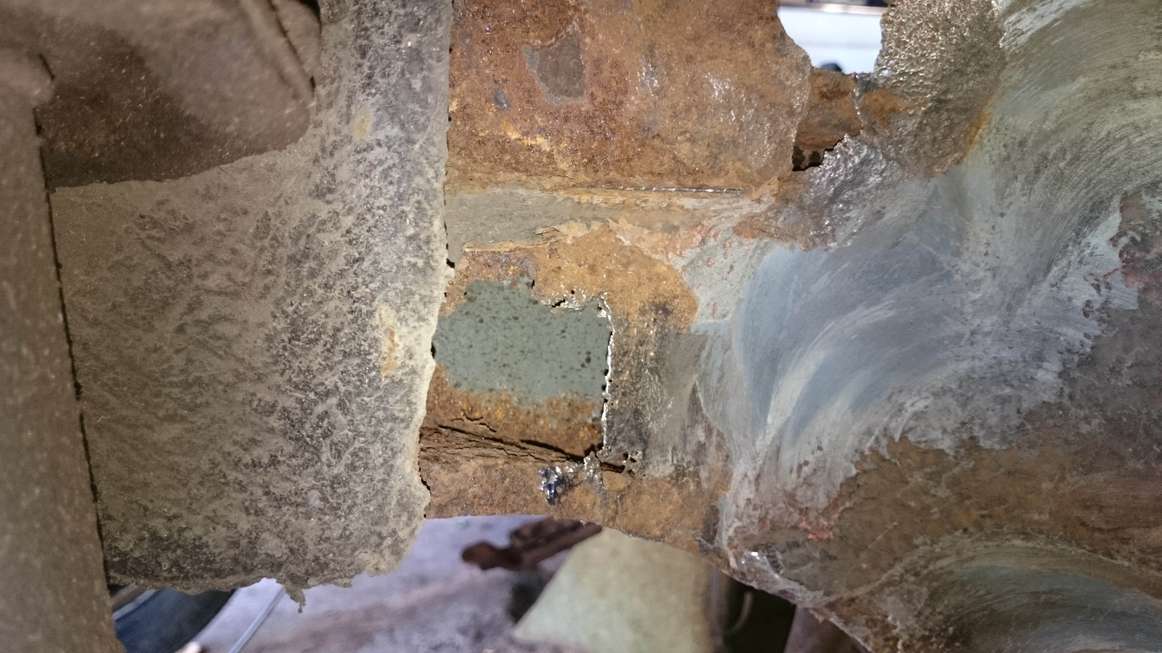

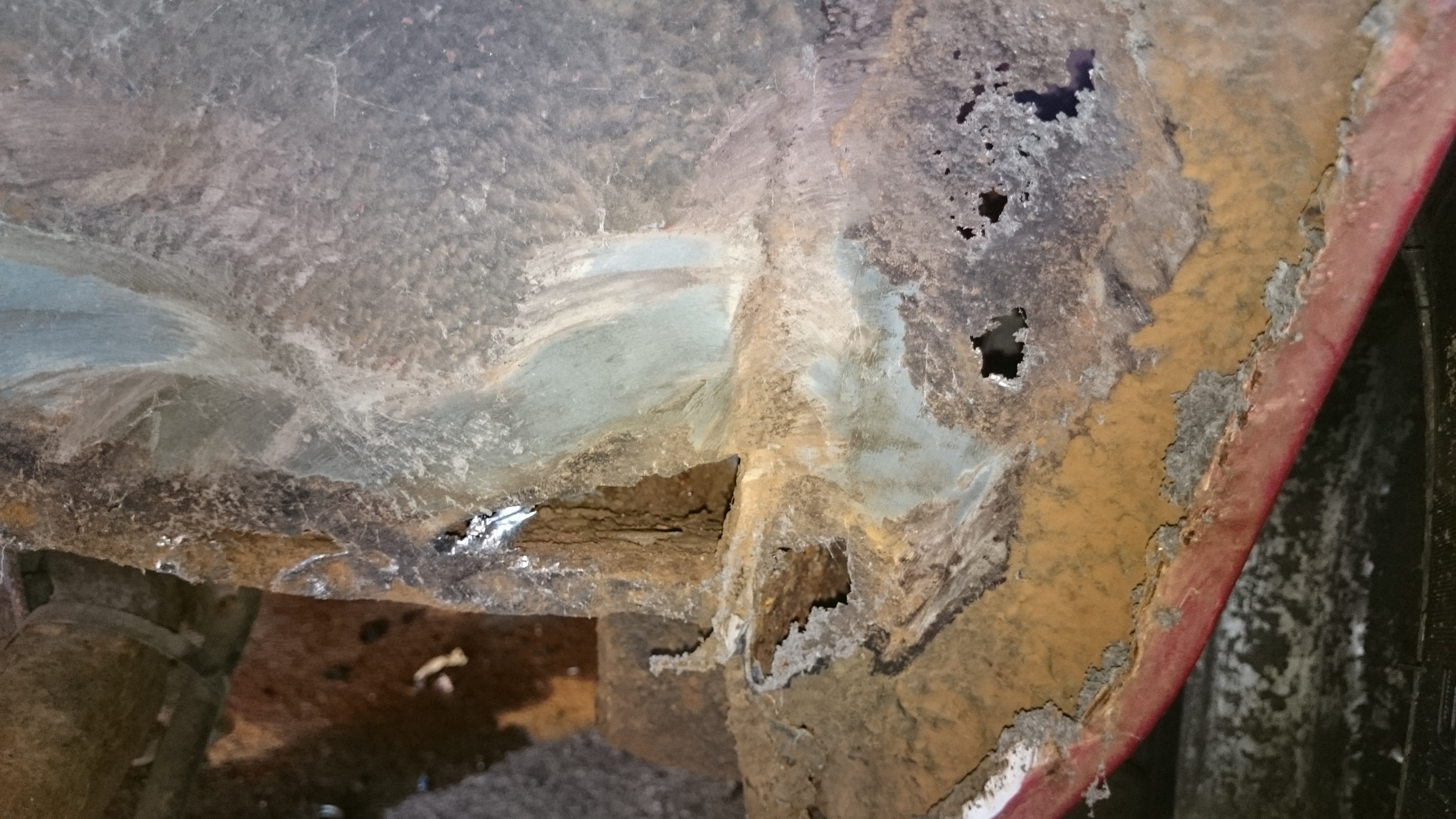

Following a dodgy engine removal, I stripped down the chassis to look at rust, and after grinding the sealant off one of the arches I found the situation worse than I expected.
Pictures do not do this justice, but I'll get there... One day

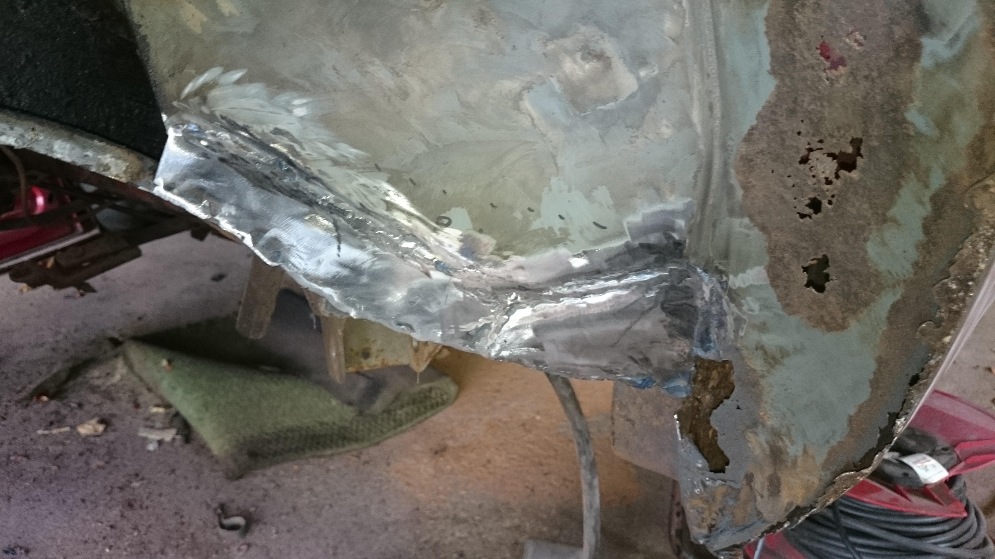

After cutting back the rust and spraying the insides of the panels with waxoyl, I fashioned some replacements from steel plate and welded them right in.
I'm well aware it's terrible handiwork, but it seems strong enough...

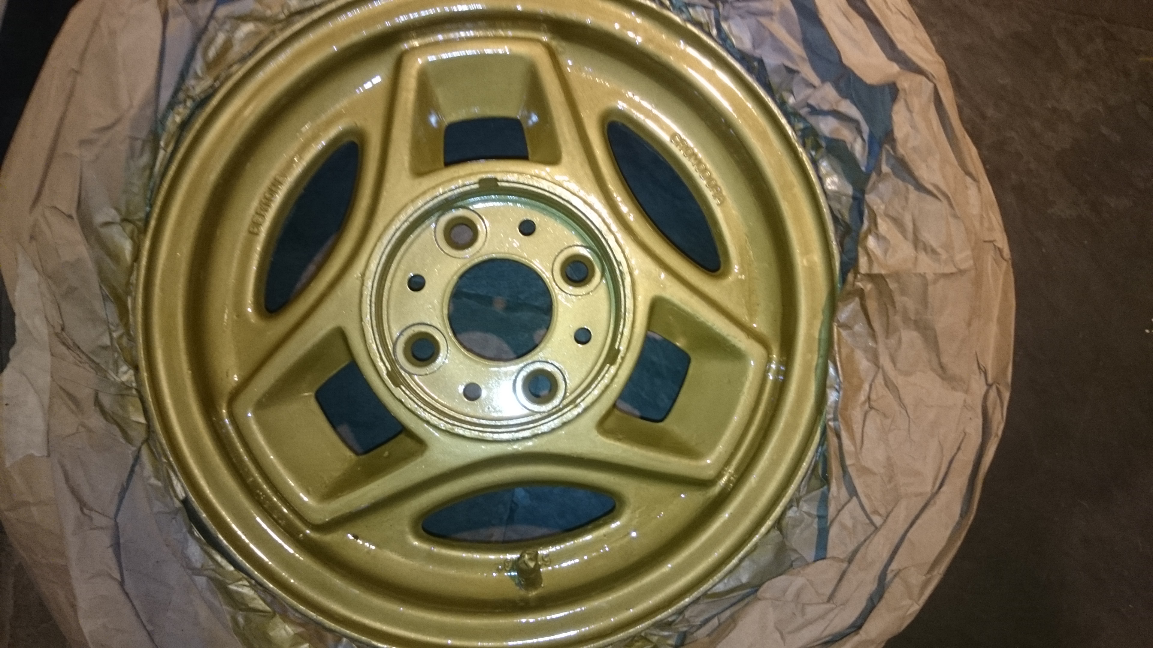

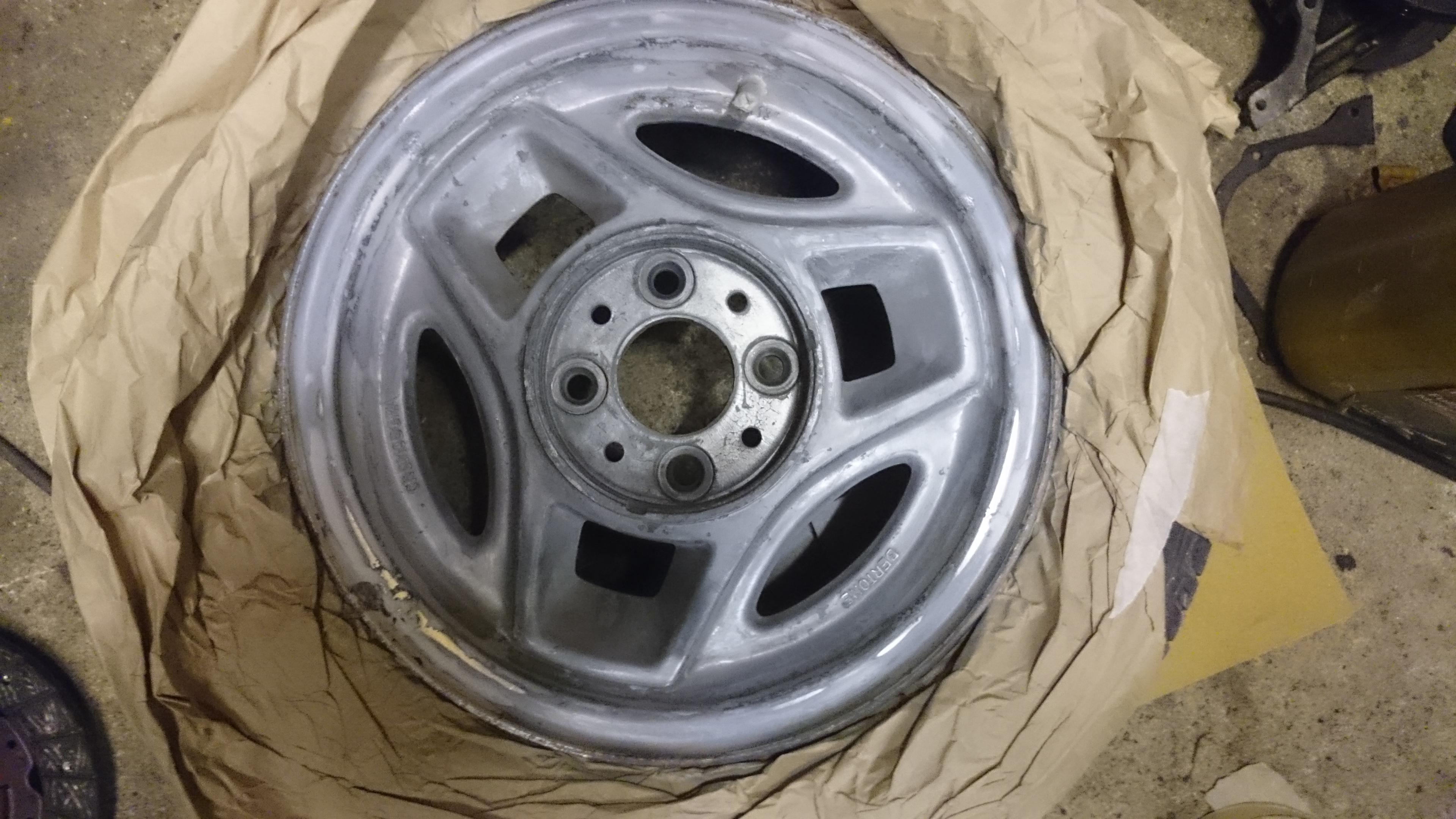

Worked mainly in the wheels, they're pretty poor condition, but they've scrubbed up alright!

Gold wheels look great I'm planning to paint my Trons gold as I've a two tone blue car dark and light blue with gold pin stripe.
Colours! I always imagined a Kawasaki green X1/9 - not sure of the name of the original Kermet frog 70's green. Dark blue works really well with gold wheels!
There was also a nice original burnt orange colour... Yellow also looks good!
Most colours look good on an X1/9. I'd be thinking original colours to maximise value in the future. The two tone schemes were really to help with the 1500 bumpers, I personally think the single colours complement the body shape much more - as the designer intended!
gold wheel photoshop of my car:
