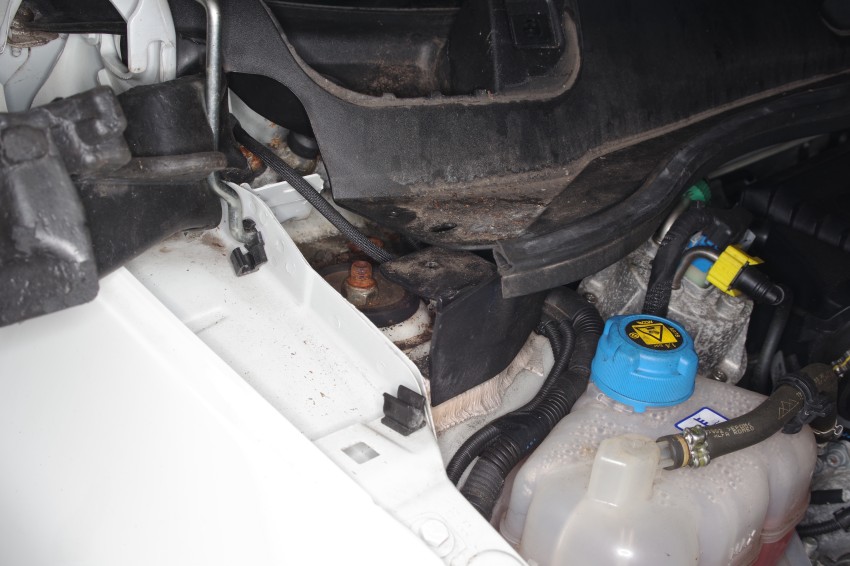

I need to remove a front suspension strut (spring broken after only 20,000 miles!). To remove the nut at the top of the strut it seems I need to remove the full-width plastic exterior panel that goes between the windscreen and the bonnet on my Panda 4x4 319 model. Youtube has some videos (eg by Autodoc) showing strut removal on the previous Panda model (169), but that does not have this panel.
Has anyone removed this panel? After removing a few plastic fir-tree clips, it seems to be strongly glued along its top edge to where it runs along under the windscreen glass. It could even extend under the bottom edge of the windscreen, it is hard to tell. I am reluctant to heave too hard on it because if it breaks I expect it would cost a fortune to replace, "trim" always does even if it is obtainable.
You can see the stud and nut (19mm AF) at the centre of this photo. Things are more restricted than they look here. I can just about get a socket or spanner on it, but at the same time you need to stop the stud turning with an Allen key in the end of it, and there just isn't room for that. The panel is along the top right of the picture and the rectangular "porthole" is to access a wiper blade spindle and does not give access to the strut. I thought of cutting a hole in the panel, but it would be exposed to the outside even with the bonnet shut.

I removed mine and it wasn't glued, just the plastic screw rivets at either end, anf ai think a acrew in the centre.
I think the windscreen-most edge clicked into place - either way it wasn't a difficult job... I suspect someone has been tinkering with yours perhaps?

Thanks for the advice. I have done the job now, and the attachment of the plastic scuttle panel to the bottom edge of the windscreen was not such a challenge as I had thought. The upper (or rear) edge of the panel has a small square rib on its underside, no more than 2x2 mm in size, and this fits in a corresponding groove in the windscreen rubber just below the bottom edge of the glass. No glue involved.
It was tedious to release the upper edge of the panel from the rubber and I did it by working from one end with a flat lever (one I also use for opening paint tins) levering against the glass with a square of wood as a load spreader. It did not come out particularly easily and there is no way it could all have come out just by pulling the whole thing in one go as Herts Hillhopper seemed to have managed in the post above. I guess the fits vary.
However, getting it back in place at the end of the job turned out to be easy. Having positioned the panel correctly, the rib just clicked into the rubber groove by pressing it in with my thumb, working my way along it.
As far as reaching the top ends of the suspension struts was concerned, I did not need to remove washer tubing or anything else. I just pushed the panel a little way up the windscreen and propped it there with more timber offcuts.
Impactwrench might work without the need for 2 spanners.
gr J
Thats how I do these, I cant see how you would do it without. Impact gun with suitable extension should loosen it with relative ease. Re torqing is more difficult. An impact wrench bought for this has been the best tool I have ever bought bar none. It will also deal with drop links and caliper bolts so money well spent. Clarkes (Tool MArt) are chewap and seem to work. I bought a Ryobi battery tool which is still going well after 10 years. I use it a lot.

Can recommend a Bahco S140T 14 Pce Pass-Through / Go Thru Multi Drive Metric Ratchet Socket Set, other brands available. You can then put an Allen key in the top. Also useful for the suspension link nut. Fill the Allen hex on the top with grease or wax when you finish!
