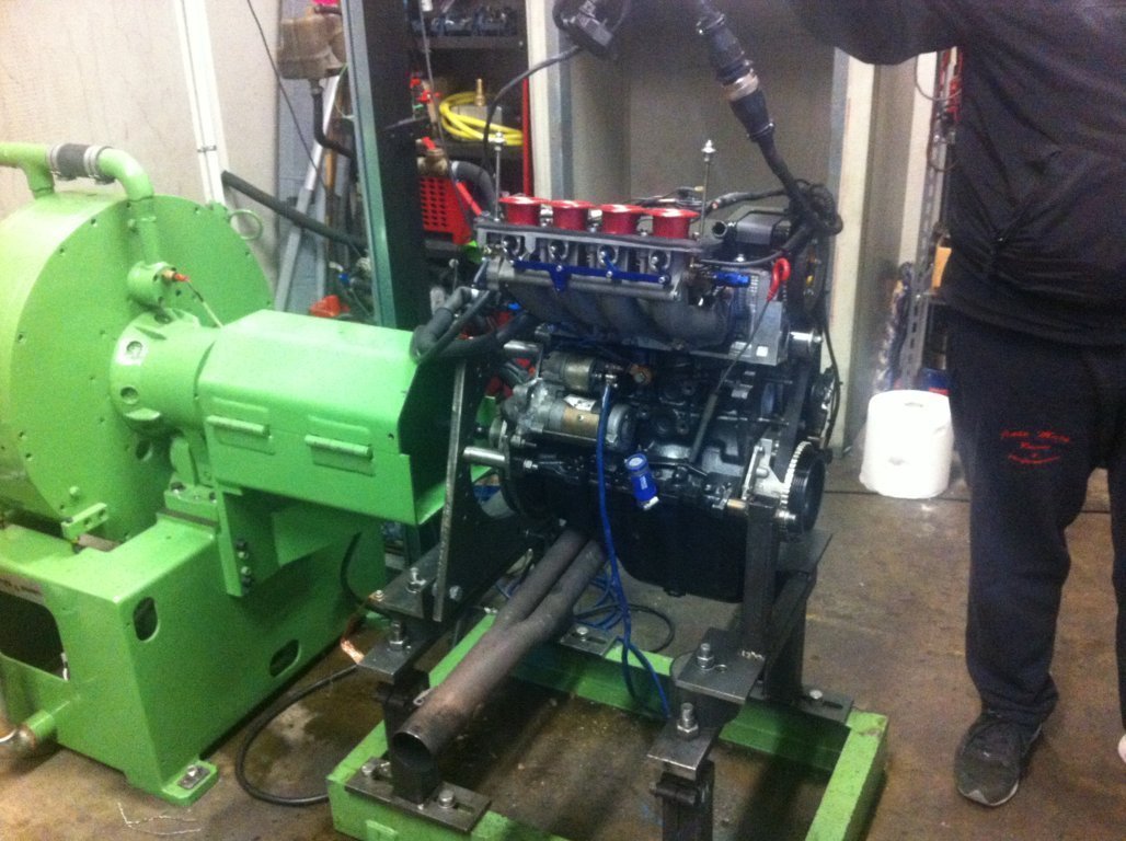

Are you sure that's where the restrictions are
120HP on engine dyno
Fair bit of work and a few grand done on the engine, compression, race cam different connecting rods and so on
It's not until the Evo @ 157HP which is bored and stroked on custom inlet and 4 throttle bodies
Probably over 4 figures spent, even the block is milled to lighten it
View attachment 455282View attachment 455283
I don't see any gains myself just changing the inlet, the bottle neck is the Valves, lift and duration
I posted some rolling road back to back of the standard exhaust swapped for a decat and full race on a standard engine
From memory they were identical except for the last few hundred rpm which shows 3hp gain or well within the error of the rolling road, even if it was genuine it's not going to be any noticeable increase acceleration
I noticed you have the 4x4 these engines have different cams and throttle bodies and I suspect are tuned for more low down torque
