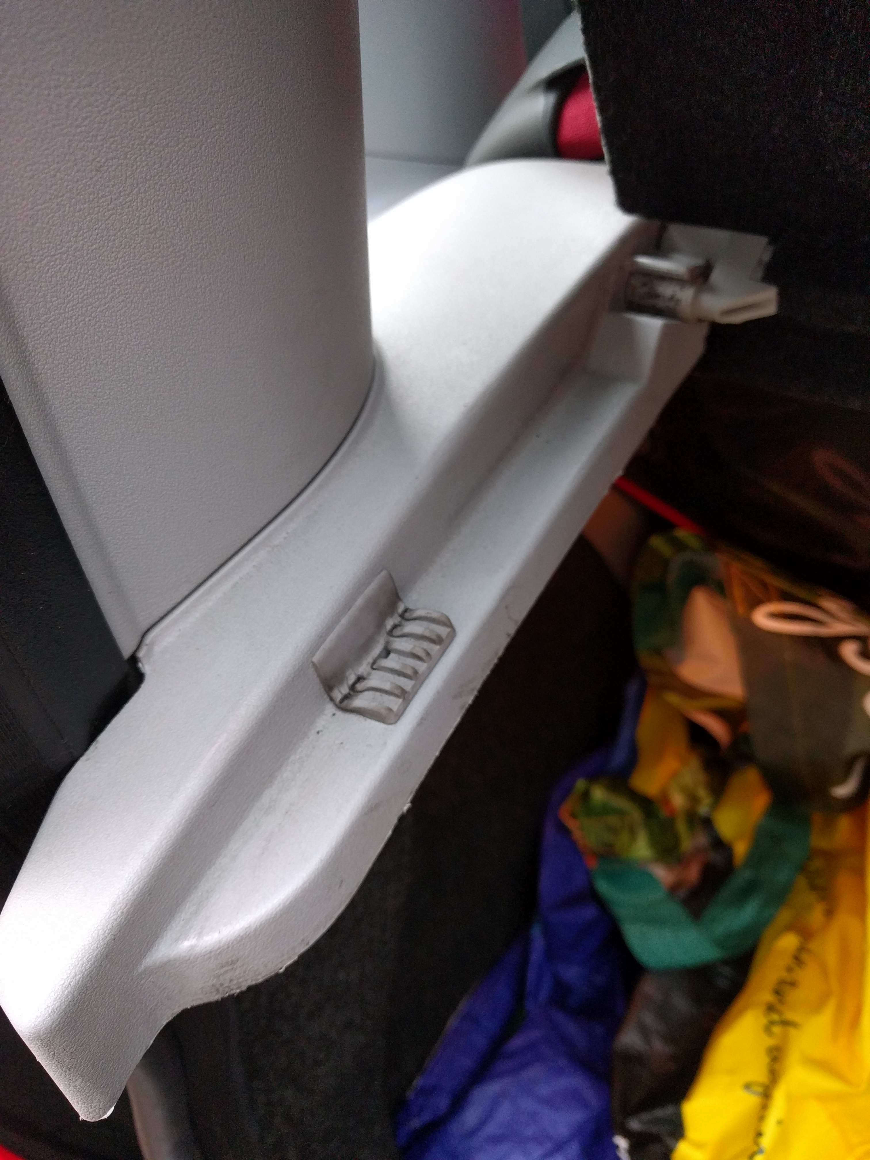

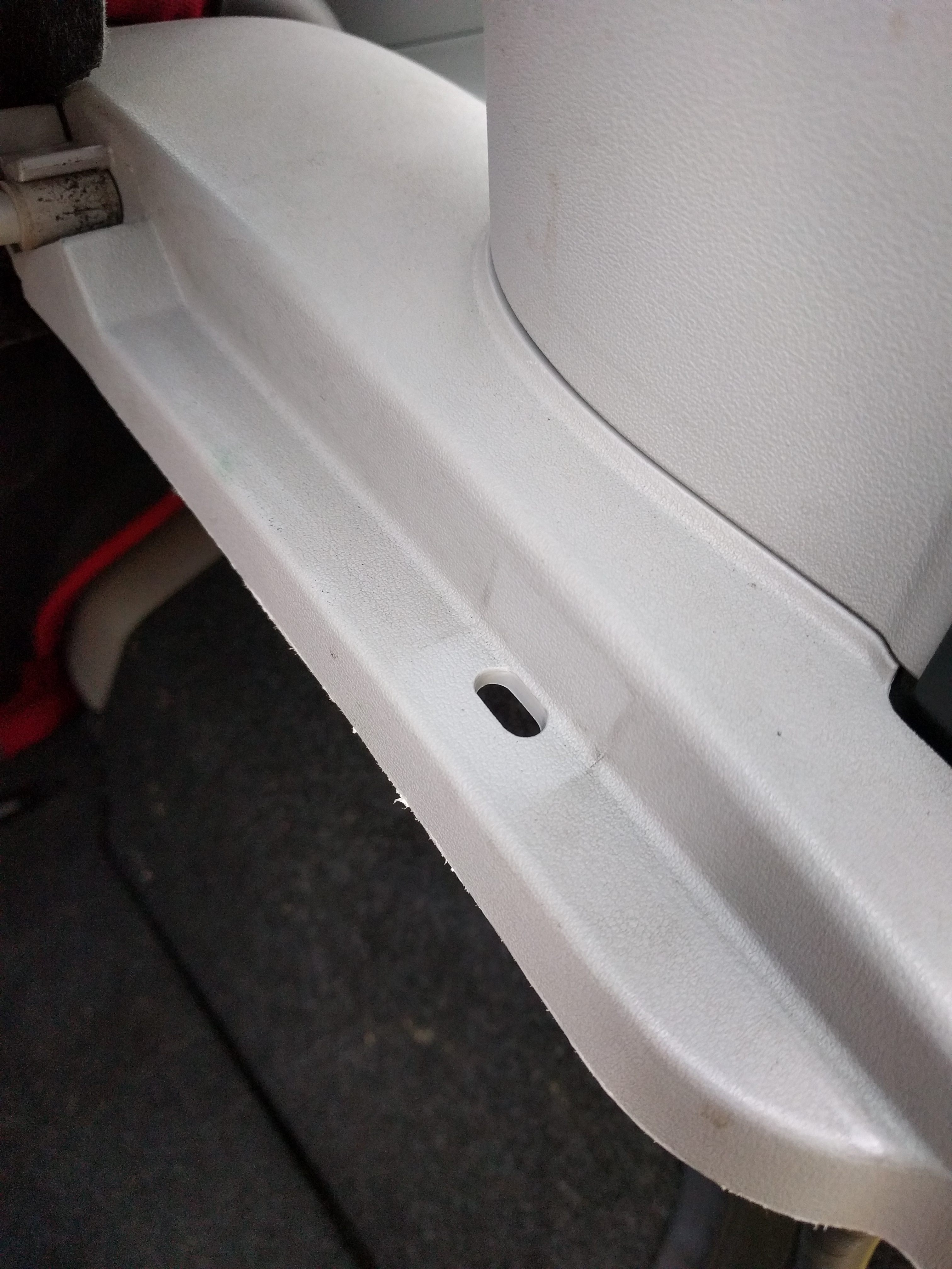

B buttonsandzips Patron member Joined Oct 6, 2008 Messages 160 Points 53 Location Norfolk Nov 6, 2016 #1 Any ideas out there as to what the part number is for this rubber parcel shelf rest? The knocking is driving me crazy! Thanks Attachments IMG_20161106_125839.jpg 2.9 MB · Views: 221 IMG_20161106_125834.jpg 2.9 MB · Views: 104

I irc Patron member Joined Mar 31, 2016 Messages 1,679 Points 600 Location Norfolk Nov 6, 2016 #2 I made a pair using Sugru. Worked ok until I got a spares car. Well, better than the rattle, anyway.
OP OP B buttonsandzips Patron member Joined Oct 6, 2008 Messages 160 Points 53 Location Norfolk Nov 6, 2016 #3 Good idea, perhaps I'll try the kids play doh...
V varesecrazy Patron member Parked in the garage Written 10+ guides Written a review Joined Apr 27, 2011 Messages 36,991 Points 10,547 Location Near the M4 Nov 6, 2016 #4 buttonsandzips said: Any ideas out there as to what the part number is for this rubber parcel shelf rest? The knocking is driving me crazy! Thanks Click to expand... http://eper.fiatforum.com/eper/navi...3&WINDOW_ID=1&SGRP_COD=23&SGS_COD=0&DRW_NUM=3 part No. 71737756 same part as punto..mk2/B ?? Last edited: Nov 6, 2016

OP OP B buttonsandzips Patron member Joined Oct 6, 2008 Messages 160 Points 53 Location Norfolk Nov 6, 2016 #5 Great find. Thanks. Doesn't look readily available online so looks like I'll go with DIY solution for now...

D DaveMcT Patron member Written a guide Joined Sep 14, 2009 Messages 20,105 Points 4,011 Nov 6, 2016 #6 Slice a disposable foam ear plug in half lengthways and stick the halves to the shelf sides.
OP OP B buttonsandzips Patron member Joined Oct 6, 2008 Messages 160 Points 53 Location Norfolk Nov 7, 2016 #7 Using a small pom pom thing I found in my daughter's craft box for now but the helpful people at Desira eBay are getting me the real part for £3.50 Inc P+P...

T tinmar49 Patron member Joined Jan 23, 2009 Messages 241 Points 51 Location weston-super-mare Nov 10, 2016 #8 I lost one of mine, ordered one from the Fiat dealer, had no idea that they come in different colours, now I have a black and a grey one.

I irc Patron member Joined Mar 31, 2016 Messages 1,679 Points 600 Location Norfolk Nov 10, 2016 #9 My Sugru ones were white!
