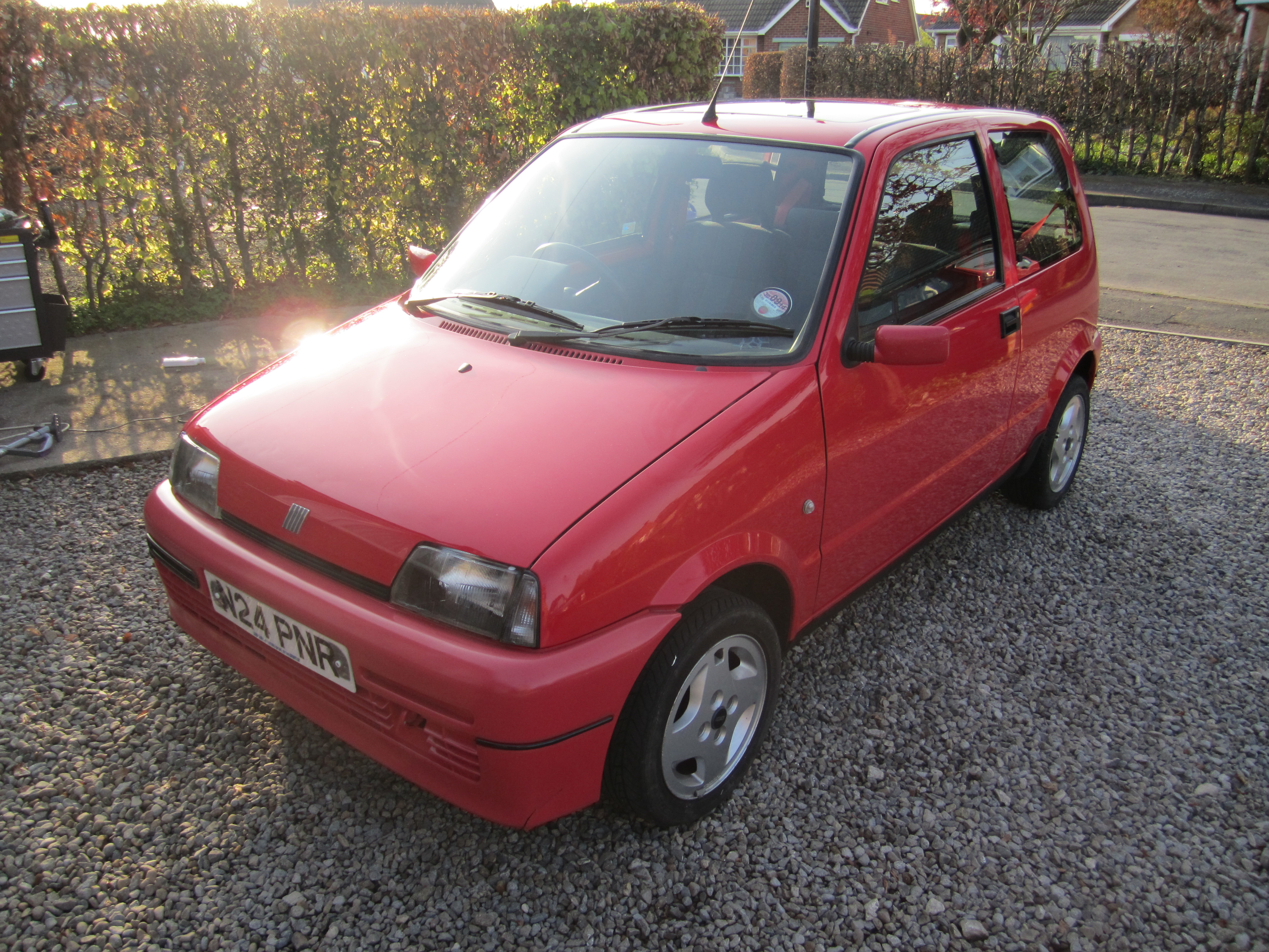

Yesterday I used the real deal in a yellow bottle G3 with stockinette and what a brilliant product that is, instantly taking off the faded paint.

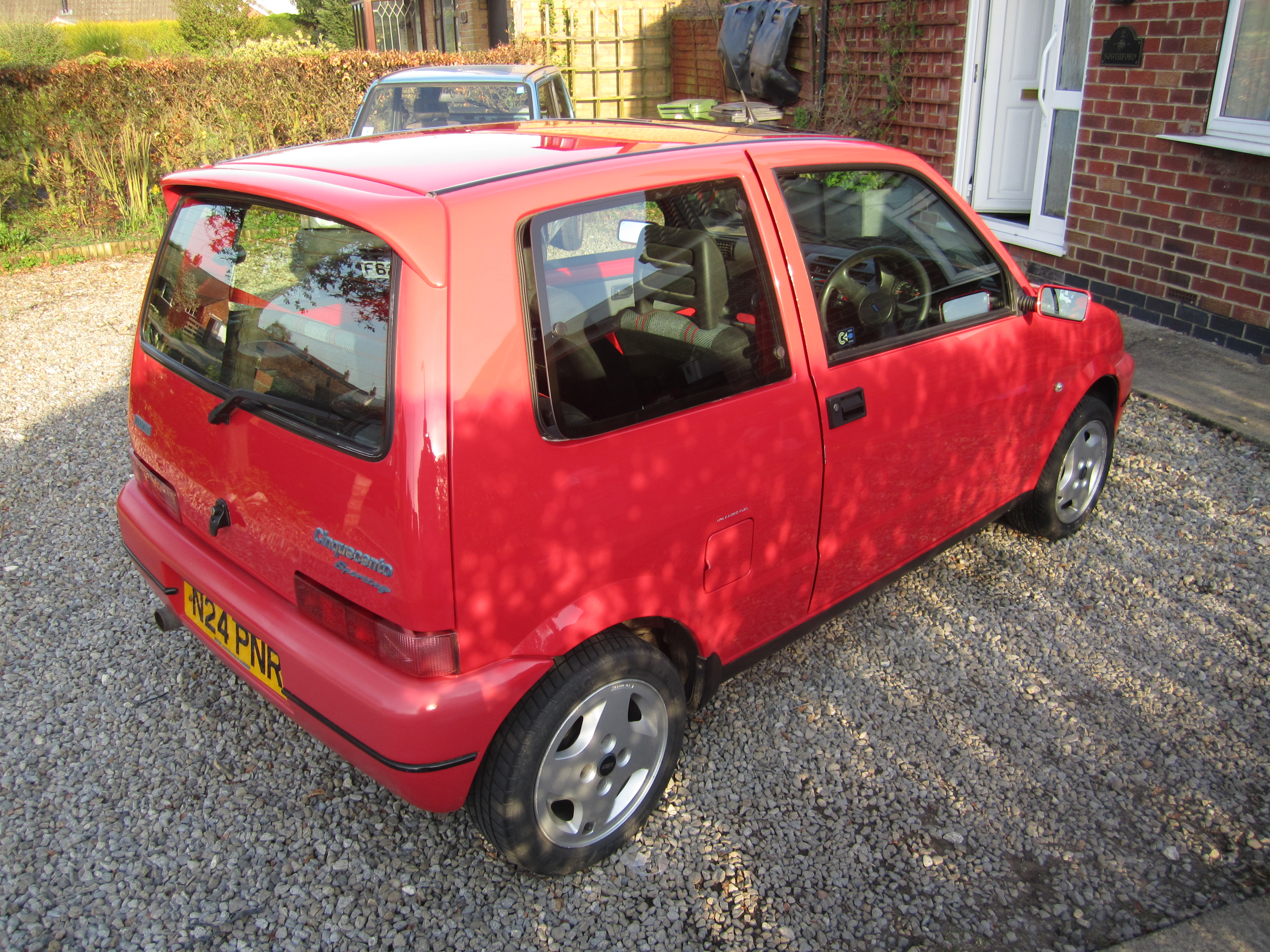

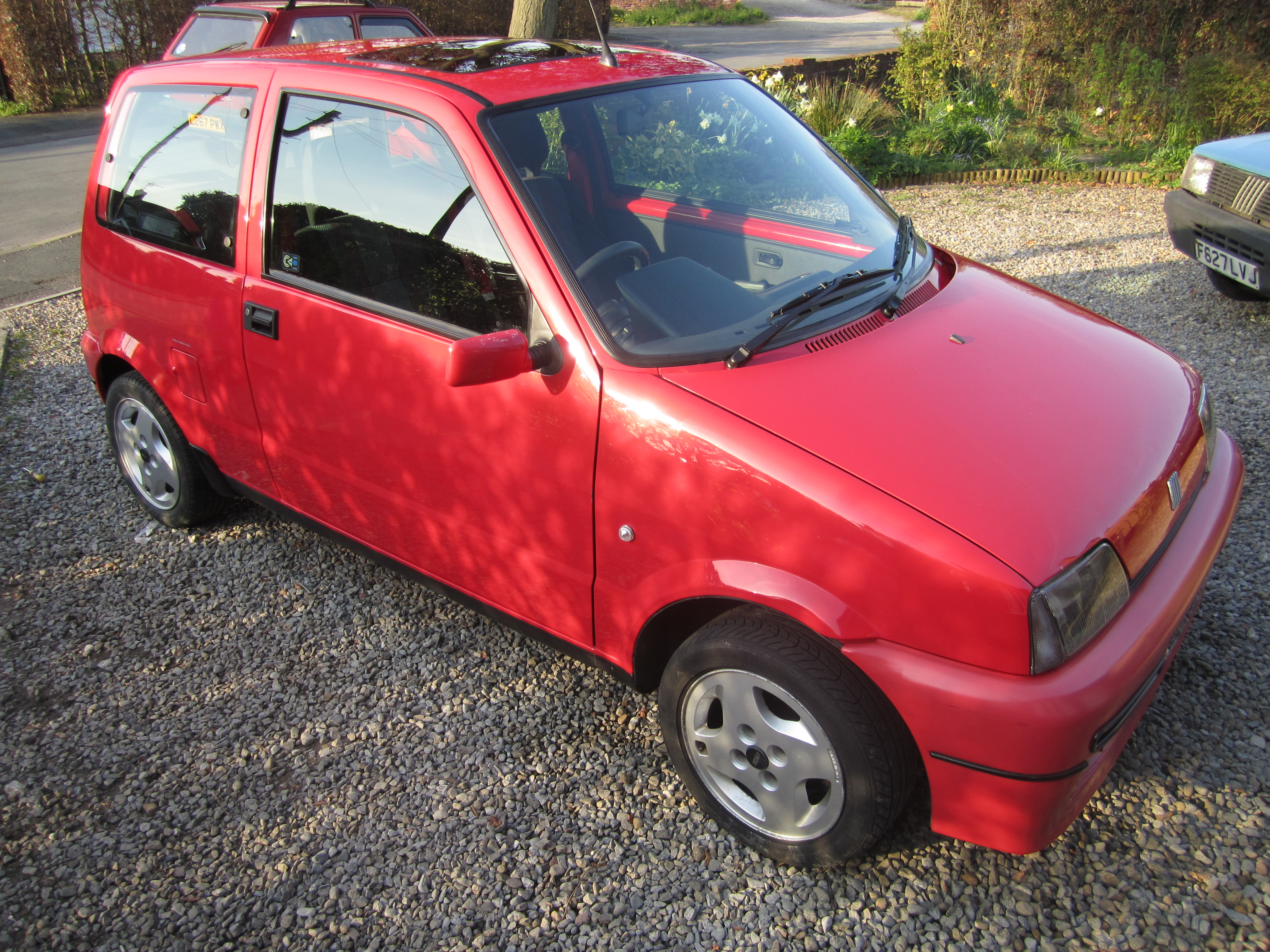

Followed by AG SRP and topped off with AG extra gloss protection I now have a really shiny cinqy

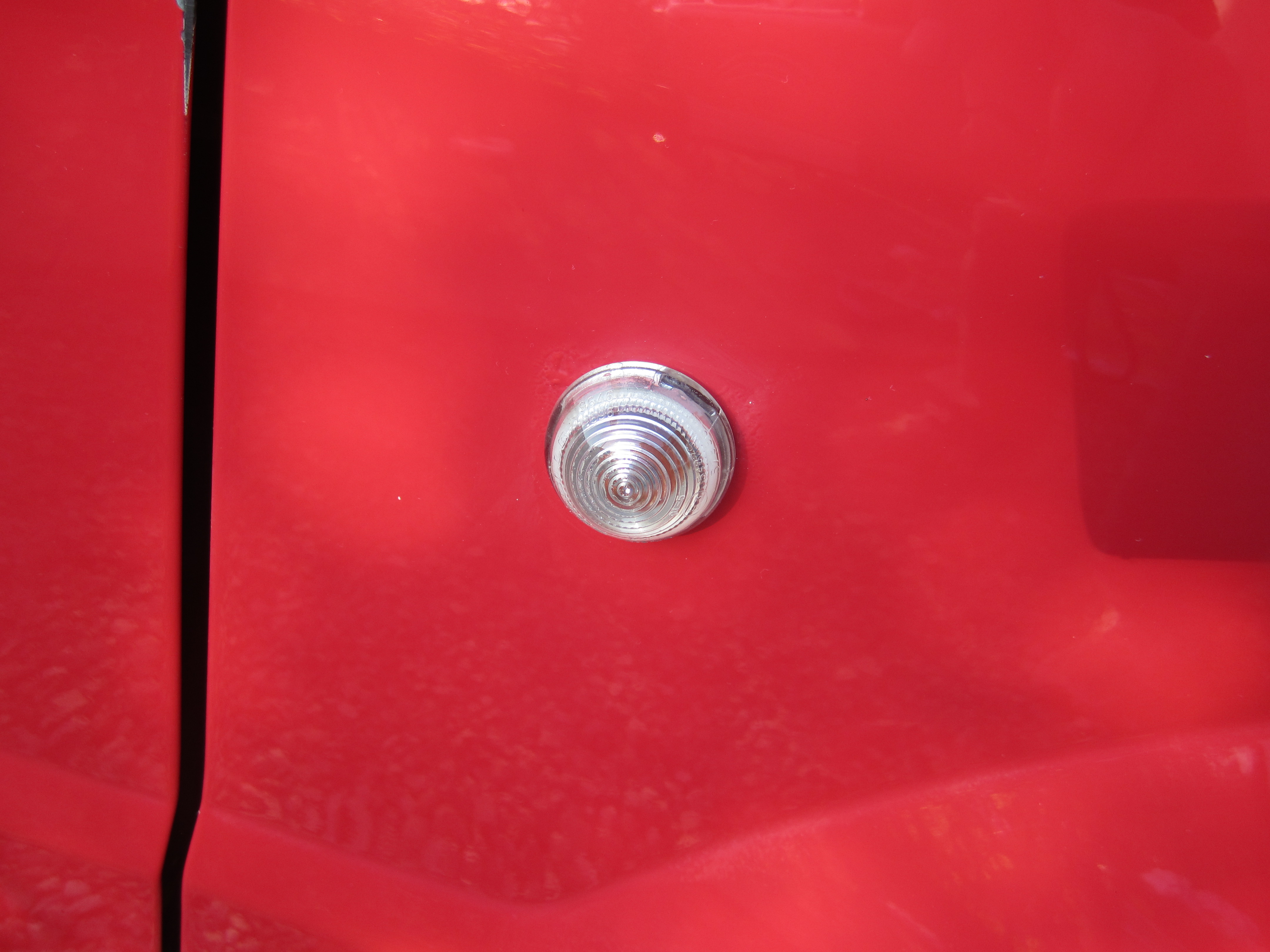

And the side repeaters were changed too:

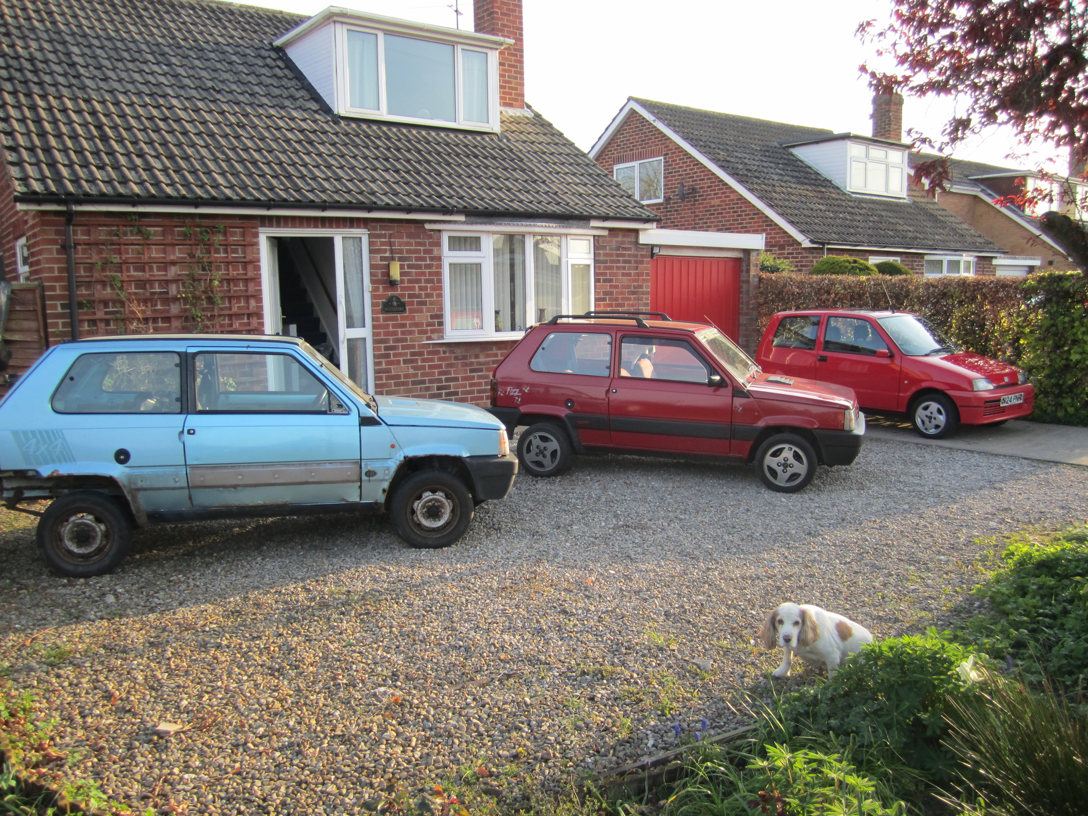

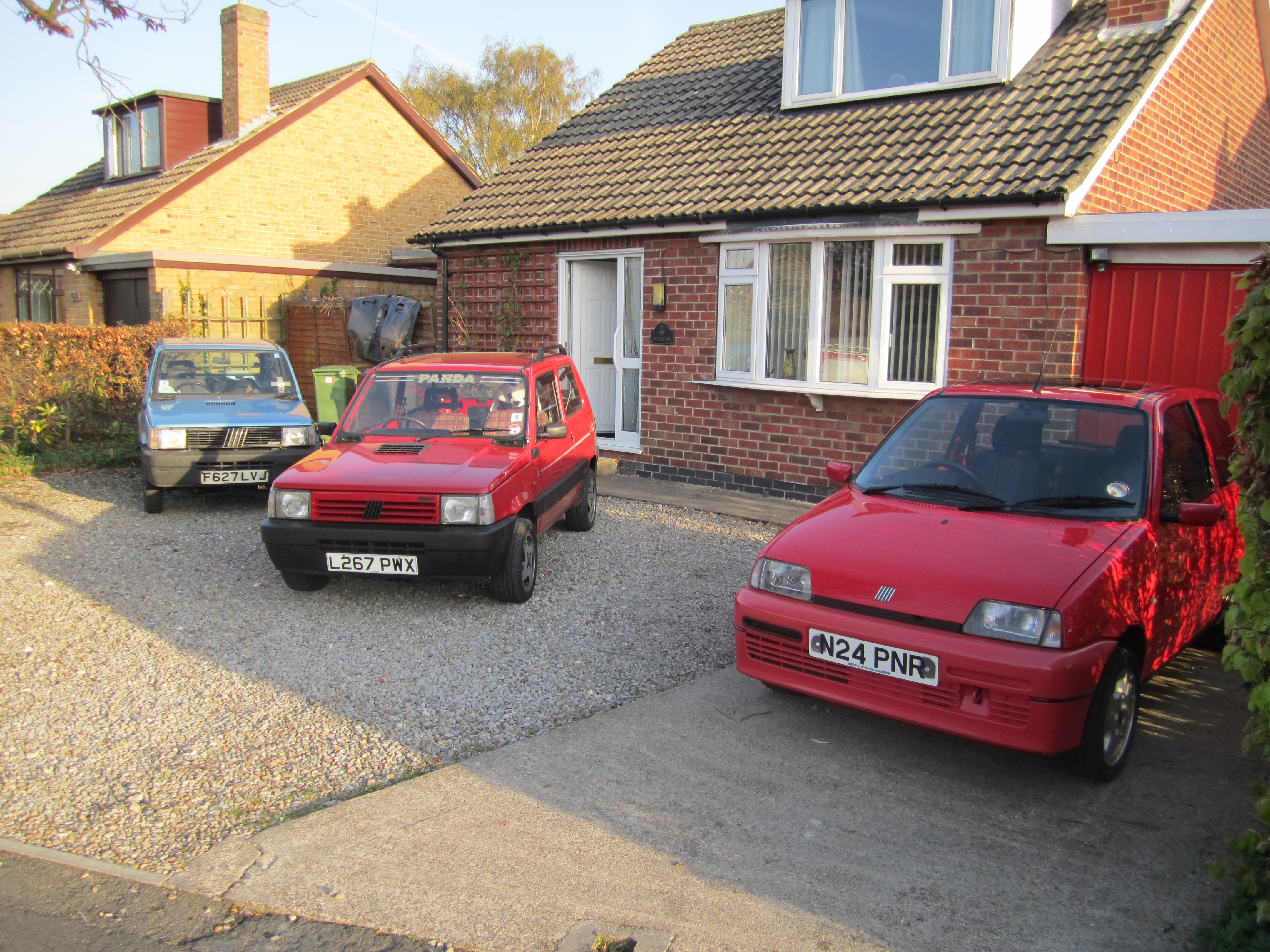

Fleet shot:
I'm going to miss that massive drive

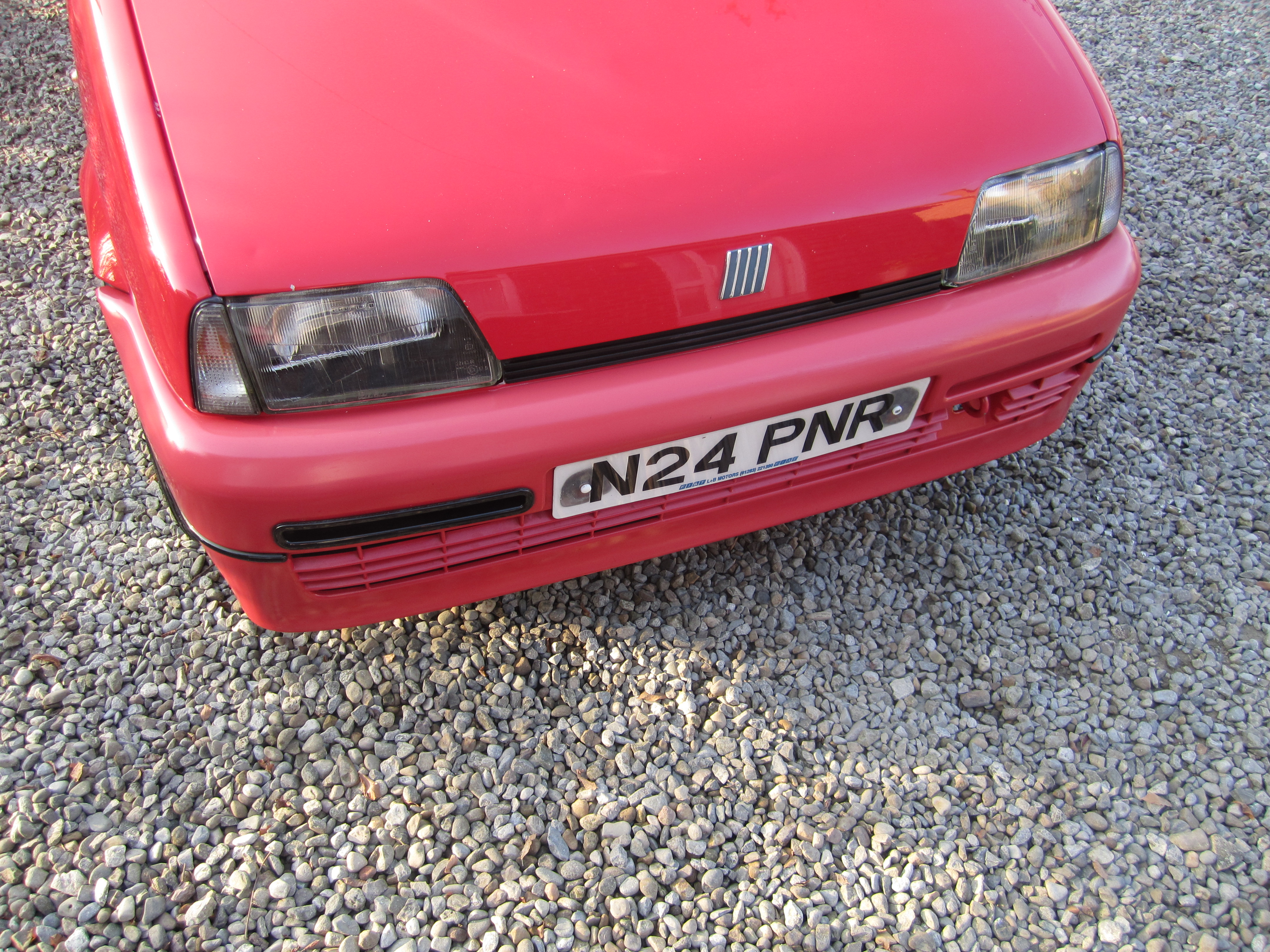

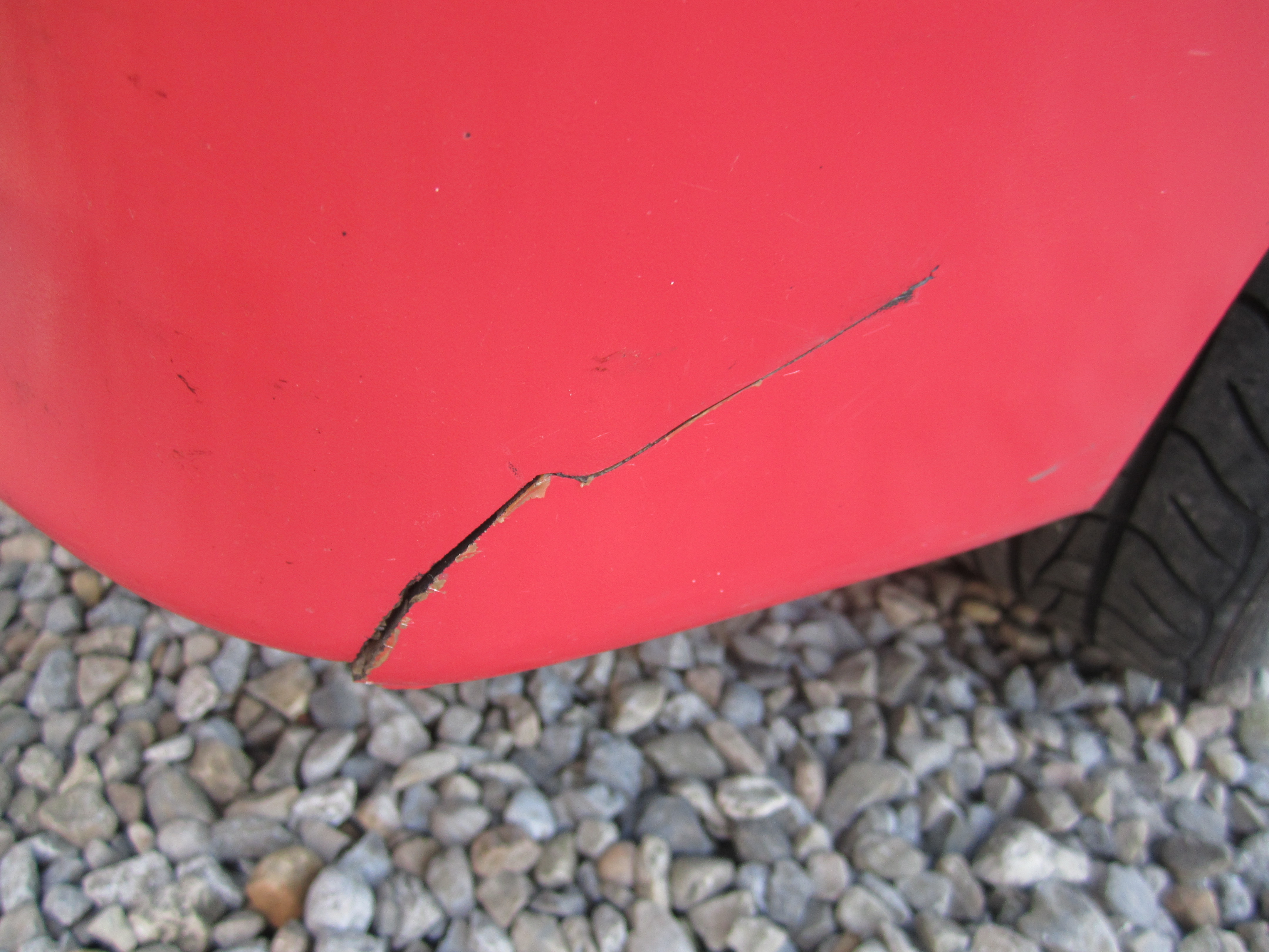

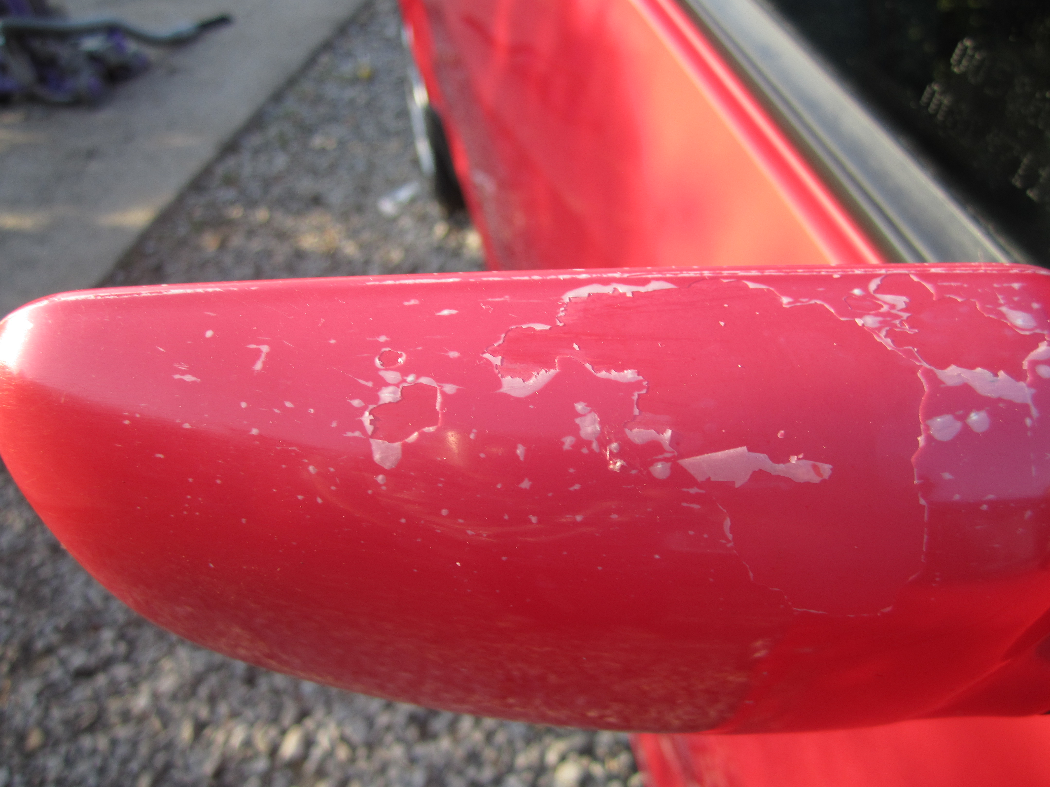

A few problem areas to address
Thought I might get some black mirrors of the scrappy sei.
I've seen new black bumpers for a reasonable price too.

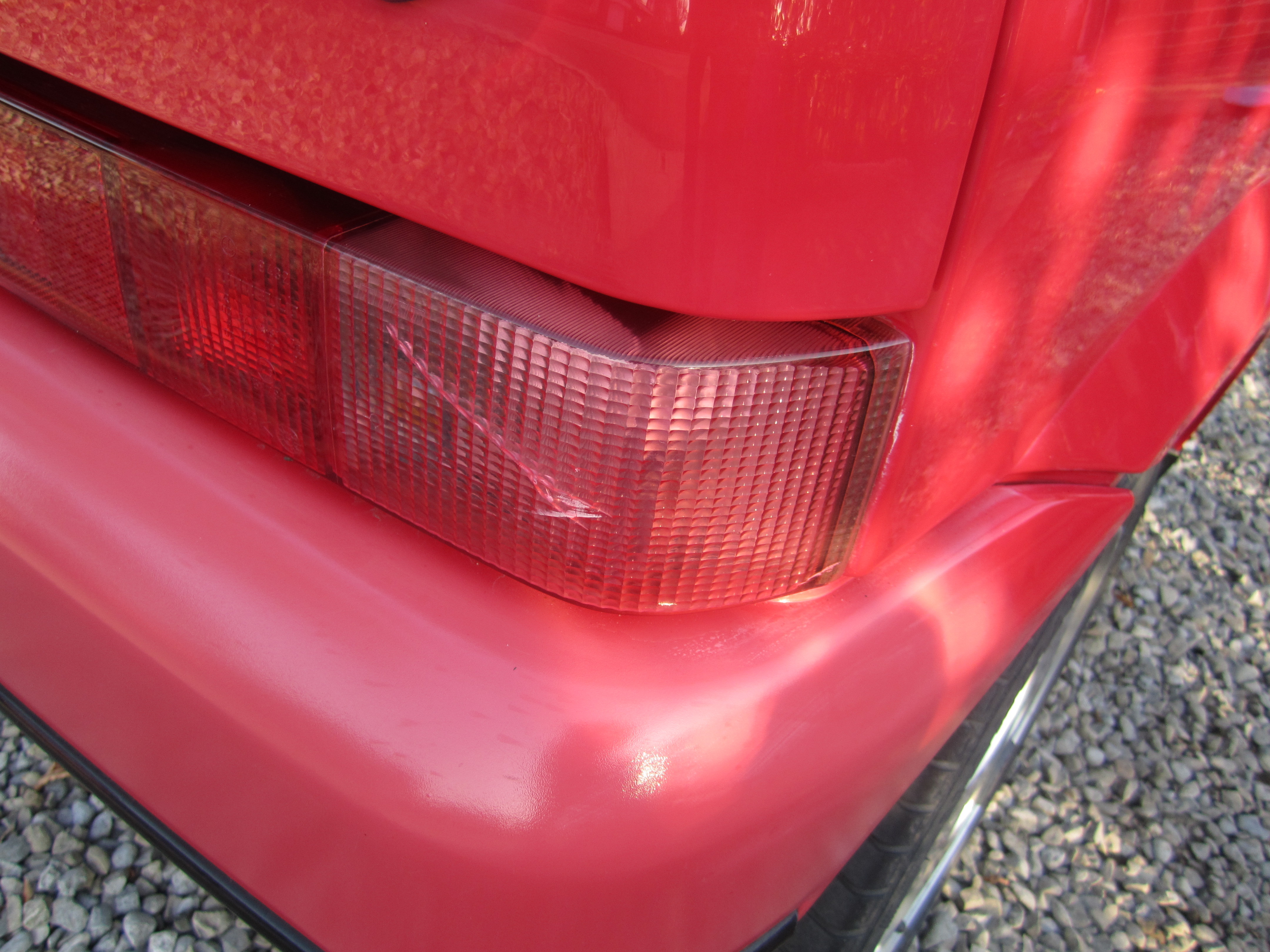

Just leaves the cracked rear light to sort.
