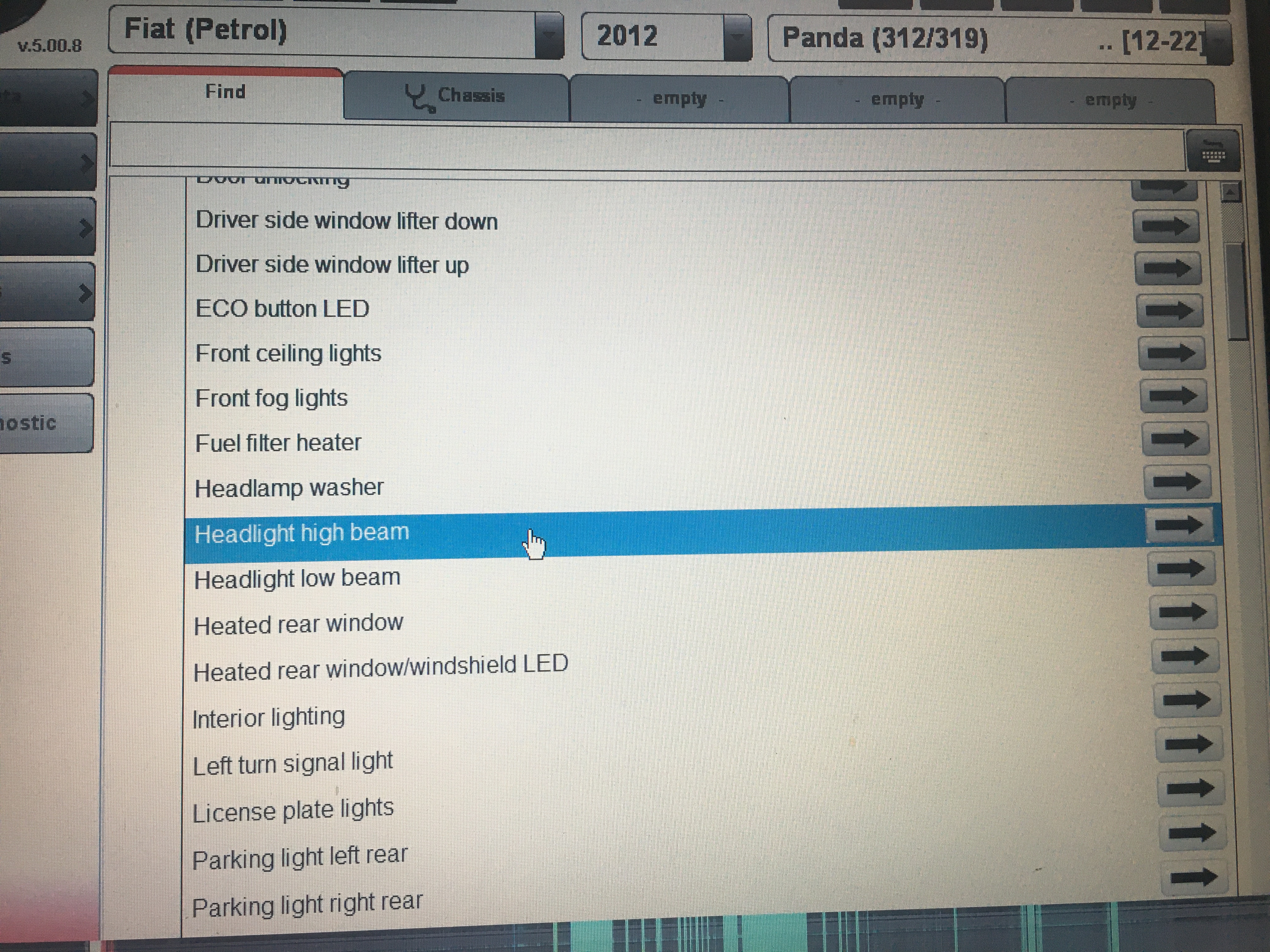

But most diagnostic software you can directly activate the headlight relay via software and read what the body computer thinks the headlight switch is doing
Here’s the option in WoW to toggle the relay
I am sure multiECUscan will have something similar

In the actuator functions
Can you toggle the lights on and off
If you can it’s likely the body computer and forwards is okay
You should be able to activate all the lights and indicators from a laptop
