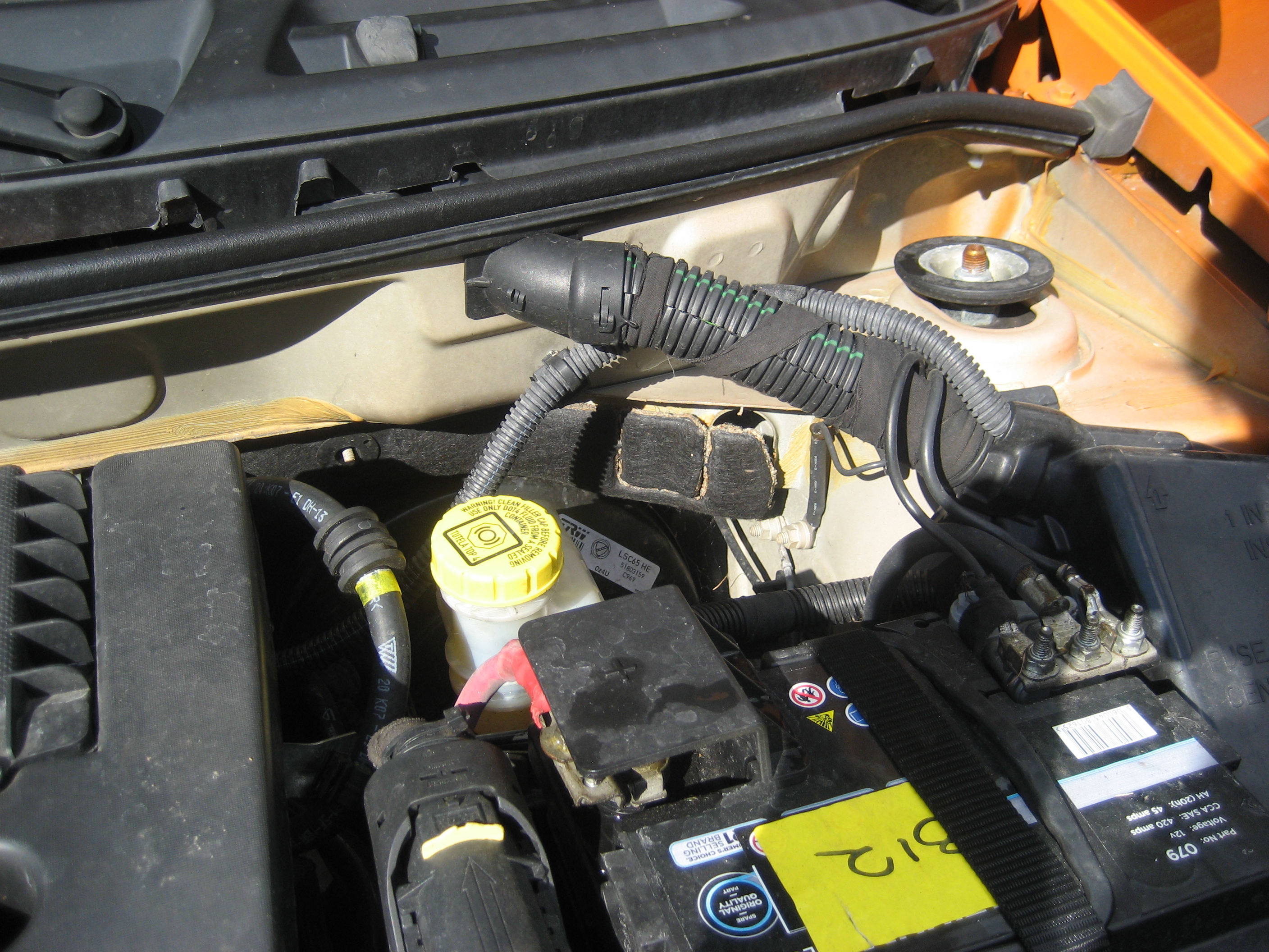

Hello Fiat Panda friends,
I have a question about some cover in the engine bay of my Cross, please see the photos. It seems to have come unstuck, revealing a hole behind it. Where is this hole leading to? Is it just a structural design or does it lead to another dimension or perhaps a different universe? :D Can I just go ahead and super-glue it back?

Other hole is just fron structural assembly
Charlie
