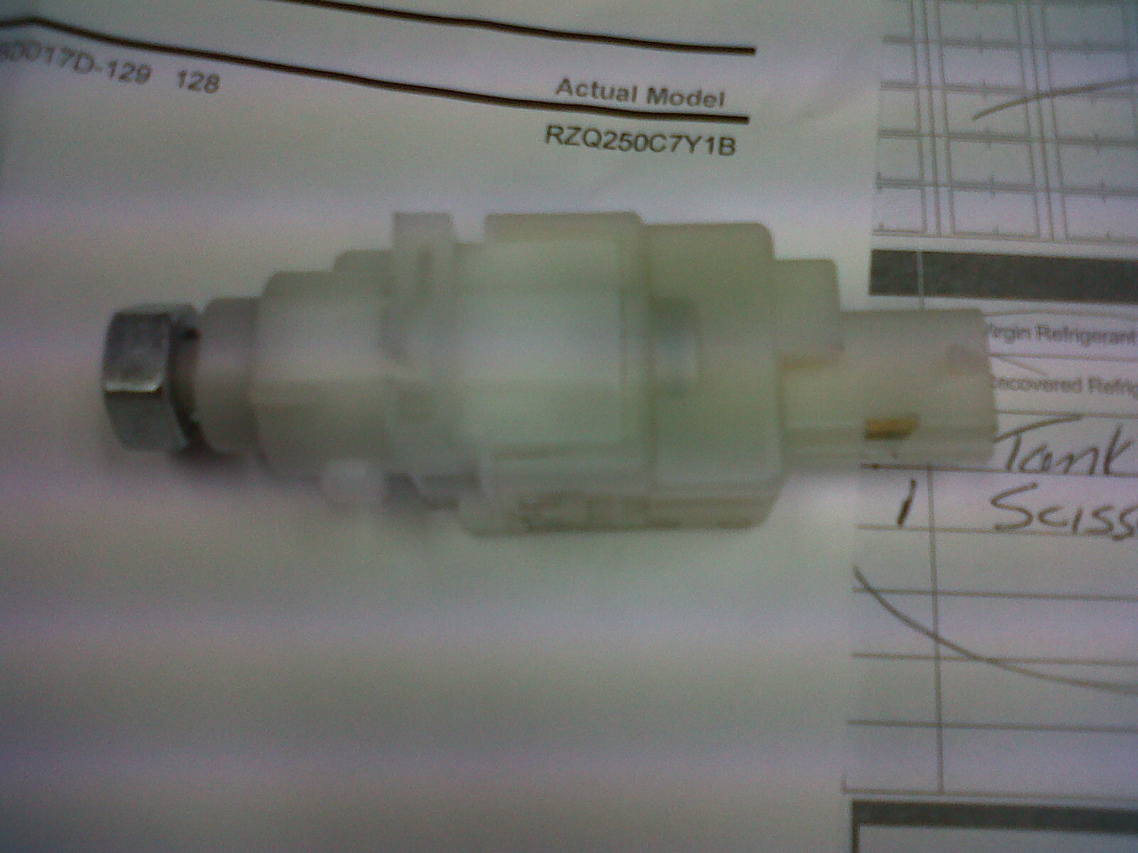

Just to help those who are faced with the fault i had yesterday, the panda switch that releases the brake lights from working, not doing its job!!! PERMANENT BRAKE LIGHTS-AAARRGGGHH
its in the passenger footwell next to the black box and if your lights arent going off its due to the switch not getting pressed when the pedal is retracted.
i solved this by doing as i have shown in the pics-THREADING A BOLT ONTO THE END OF THE SWITCH - IT WORKS GR8, the switch twists out easily and can be replced for £11-£22 but this temp fix means the dibble arent all over you.
JUST THOUGHT I POST THIS QUICK FIX AS IT KEEPS YOU MOVING AND IS ALWAYS HANDY

Don't you mean that you used a nut? Any idea what thread so we can all carry one in the glovebox ready......
